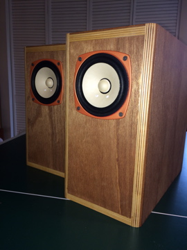

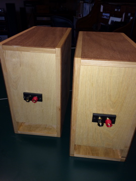

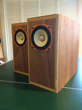

Hi Folks,
....I ended up taking 2016 off from building due to a variety of reasons, but in Jan of this year I jumped back in and am psyched to be back at it again!
What better way to re-start then by giving my FF85wk Lance's a baby brother? A good friend gave me a pair of Fostex FE103 SOL's (16 ohm) for which I had to build Scott's Shrike.
They were built with .5" Baltic birch. Before milling, I veneered the sheet of birch with pieces of 1/8" cherry that arrived to me as packing material for an amp I bought.
I love the sheer beauty of the plans and they sound wonderful. I'm using a "3w miniamp with the larger tubes and couldn't be happier. Thank you Scott, et al for all the motivating posts on this site.
Mario
