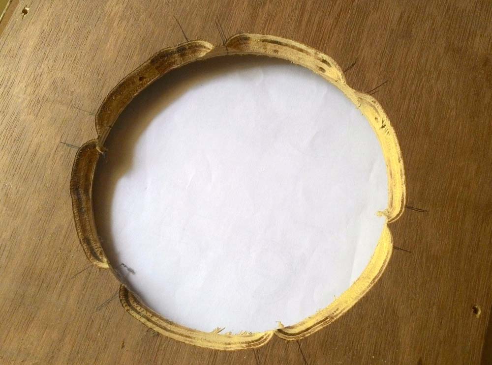

I am planning to build a Bloodhound. The 1/2" thick baffle seems a bit small. Any problem with doubling up the front baffle thickness and keeping the same interior dimensions? Does the driver need to be braced on the back like in many of the Mar-kens?
How far does the chamfer need to go? The drawings show it coming to a point. There still needs to be some wood to screw into, right? I have seen photos of builds where they don't chamfer as much where the screw holes for the drivers are.
In my opinion and experience, don't chamfer where the screw holes are. It's always worked well for me. You can either use a router or a rasp.

In the following link you'll find a pic of a chamfer I did for an Alpair 10.x driver:
https://www.diyaudio.com/forums/full-range/238125-pensils-alpair-10-3-alpair-10p-15.html#post4752786
As mikejennens has mentioned, there's wood left in the areas for the screw holes. This was done with a router. Same can be done with a rasp. Lot of saw dust/particles, so please wear a mask. Hope it helps.

Depends on the baffle thickness and material. W have done both methods, but in later builds all th eway round (with the big bezel MA anyway) it still leaves planty of plywood for the screws.

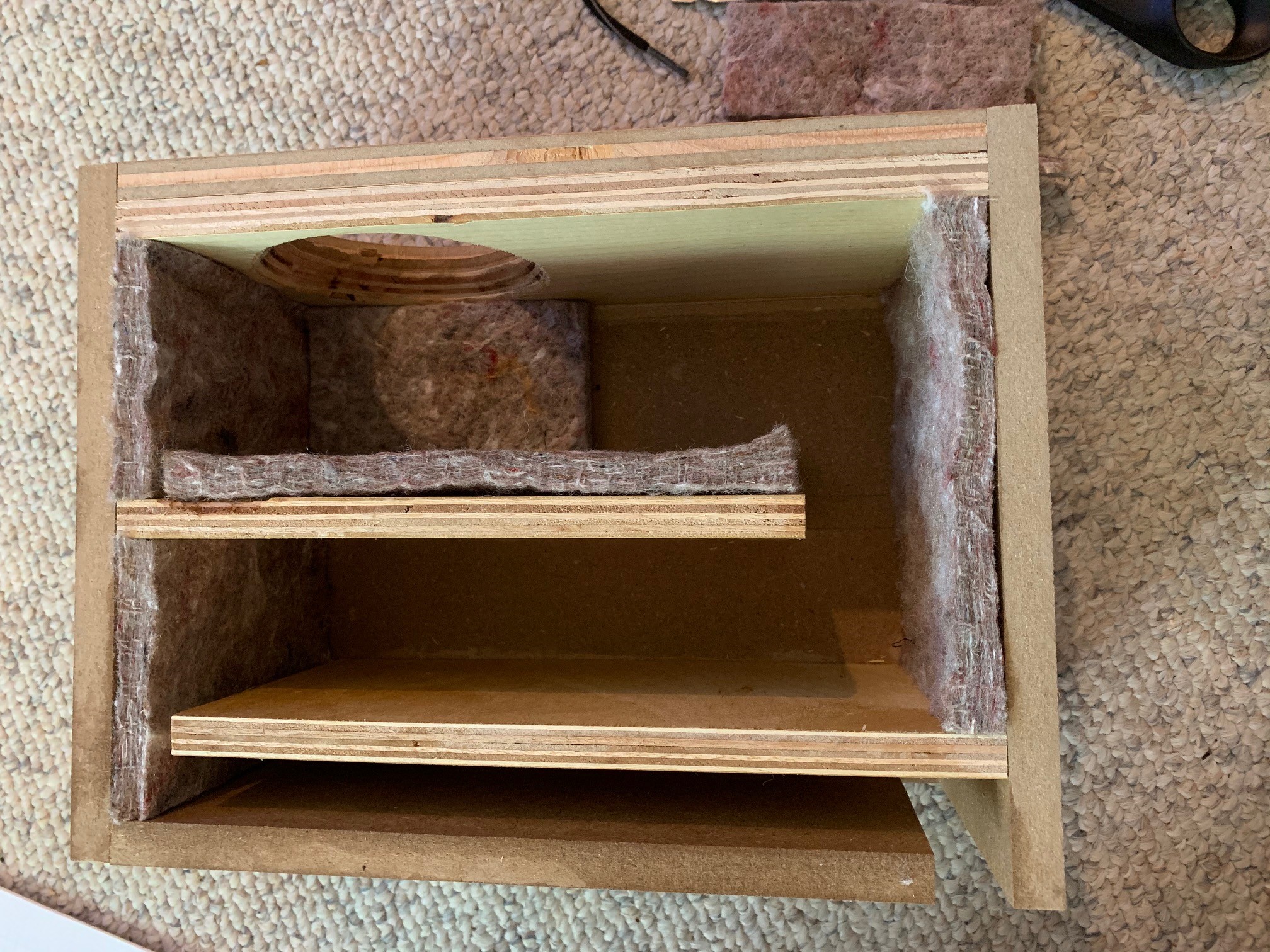

So here is my current progress on the Bloodhound Baby Lab. This is the 1/2" felt damping. Does this look the way it is supposed to? Would like to know before I close it up. Things become much harder to change then. Haven't yet adhered the felt to the wall. Thanks.
What is the best way to adhere the felt to the speaker walls?
I use silicone sealer. A few dabs will hold it forever.
