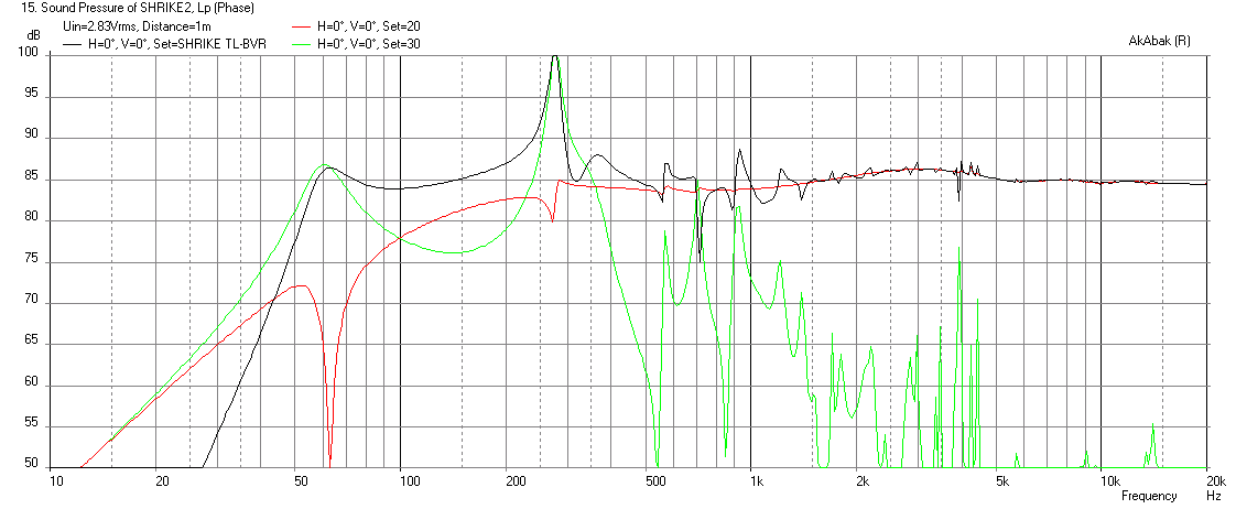

I am very interested by Shrike FE103 SOL Labyrinth.
I have never tried labyrinth enclosures.
I prefer the floorstander to have the driver at the level of the ear. I don't want to use some feet to elevate them and to preserve the effect of the ground for the low frequencies.
I had a first idea:
Is it possible to put the vent at the bottom of the enclosure rather than in the low back?
The second idea would consist in making a BVR floorstander, like Chang. Is it a silly idea ? Thank you for your advices.

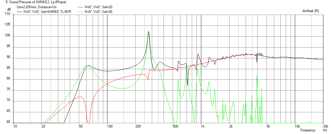

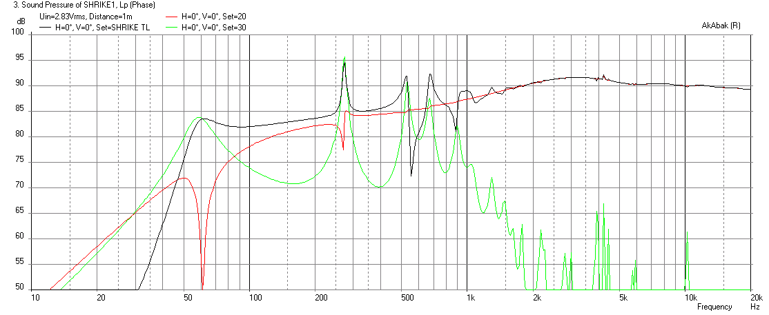

If you assume that the BVR is 12in high by 12in deep, it adds a bit more bass gain so you don't have such a drastic baffle step as shown in the first figure (baseline Shrike), but you get a nasty resonance at 276Hz - probably due to the length of the BVR cavity itself. However, with appropriate felt wool lining the inside, and some stuffing behind the driver, the resonances will probably not be that bad.
Here is the baseline Shrike. Note the large baffle step loss. Will need a substantial BSC like 1mH + 8R to compensate and it will kill your sensitivity down to circa 84dB:
Here is the Shrike with BVR, you gain 2-3dB down to 60Hz:
Adding a 1mH + 6R BSC to the driver you can now get this response with the BVR - which is an 85dB sensitive system overall with -3dB of 54Hz. Appears to be quite balanced and I would imagine, would sound pretty good:
I hope that helps.

Of course it helps, a lot !! I don't expect so much!
Many thanks for everything, it is very interesting and it pleases me that you made the effort to make a simulation.

You say a dimension of 12 * 12 " for the BVR. I thought bigger to have a enclosure about 39.4" (1m) high. I do not know how to calculate it.
Is there a formula?
There is a peak at 60 hz in the BVR graph. Therefore, is it possible to increase the length of the TL a little for better low frequency ?
