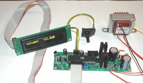

A couple of months ago I purchased boards and components from veteran (and wm8816s form Wolfson) and I have finally found the time to complete the assembly and test of a prototype.
I have started with the driver module. I only want the volume control and there are very few components to solder on the driver pcb as you can see on the picture (there are not many more for the relay selector, the board has been designed for possible extensions):

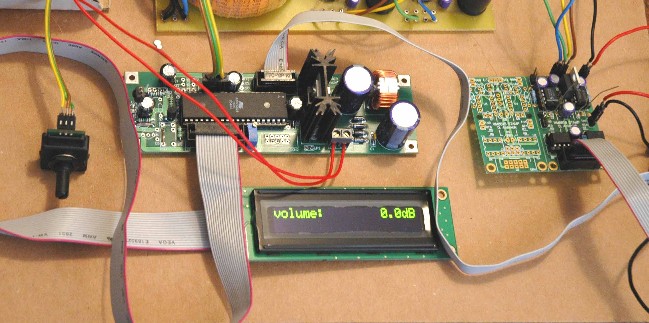

And now the whole thing. To be honest it did not work at first and it took me some time to find a bad solder on a smd resistor. Once corrected it worked fine.
I do not know about the sound. For the time being I am happy just looking at the trace on the 'scope.
Many thanks to Damian. I am very happy with the result. I now have to find the time to build the rest of the project (an 8 way attenuator)!

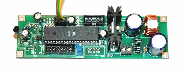

Tengsimon, I replayed your email.
For those who will assemble my deriver boards - there is no need to mount all the components.
1) There is no need for relay circuit - just solder two 0R resistors:
2) Only JP3 is needed in the area of CON2 connector:
