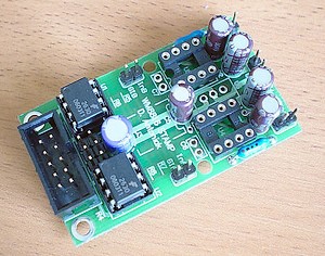

This project should be placed somewhere between Digital and ChipAmps ;) It's my new volume control module basing on WM8816 from Wolfson. I call it 'WM STAMP', because executive part of it is very small.
Some details and basic functions:
- gain range from -111.5dB to +15.5dB
- gain step size: 0.5dB or 2.5dB
controls:
- IR remote (program can learn every RC5 remote commands)
- encoder
- standard, analog pot (ADC)
- optoisolation
- LCD or VFD 2x20 display
- backlight adjust
- output for 8 relay selector
- mute
- optional name for every input (like 'CD', 'DVD', 'TUNER', ...)
WM8816 is similar to PGA2310, but... opamps are outside ;) This give many possibilities:
- many single opamps can be used
- discrete stage
- using some high power opamps we get good, headphone amp
Schematic diagram

Look at the board Skappy - there is place for 3 jumpers. This way we can control 3 x WM8816 using the same cable = 6 channels :cool:
