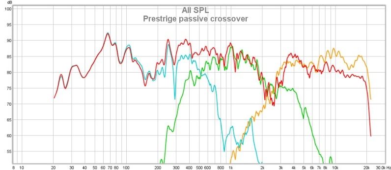

That's the nub of my question: what is the supplied crossover doing in terms of crossover points and time alignment.

Had a reply from WA. Dropped them in last week as posted. They were very kind and helpful during my visit. At least they took the time to look at them for me:
We have checked them thoroughly and I can confirm that they are made correctly and the circuits test as they should.
As mentioned, the crossovers are set at 380Hz and 3800Hz and as this is a tried and tested design, there is no reason that we can see, why it should not work prefectly well - assuming that the drive units are wired correctly.
So do you want us to send them back to you ?
Unfortunately, given I have tried these passive crossovers with both speakers and different driver configurations it appears there is no solution to the terrible freq response (I suspect a consequence of using a crossover designed for a 16ohm ATC driver with a different 8ohm volt driver).
So I will be moving on to a digital system for this project. The analogue active system is OK, but as I have previously said, given the challenging freq response of these drivers and issues with time alignment I believe the best outcome will likely be from a high quality digital implementation.

Crossover tried in various configurations polarity. Best with all drivers in the same polarity:

That is not an acceptable response from a company that has supplied a faulty crossover. The mid/tweeter crossover is clearly wrong and to claim the woofer/mid crossover frequency should be 380 Hz is obviously incorrect for a midrange driver with an Fs of 400 Hz. At least the actual hardware has a correct looking woofer/mid crossover at 500 Hz where it should be. I don't know what is going on at Wilmslow but it doesn't look healthy.
The fix for the crossover is almost certainly just to use the correct component values in the mid/tweeter section. This may require the replacement of only a single component depending on what the fault actually is and since it is the mid/tweeter section the components are not going to be expensive.
I've already said what is wrong with the original KatieandDad and bushmeister crossover. And how to fix it.

You only have to look at bushmeisters +++ measurements to see a phase problem and a slope problem in the mid to tweeter transition. Really quite simple, IMO. But waffle on by all means. Me, I'd fix it.
