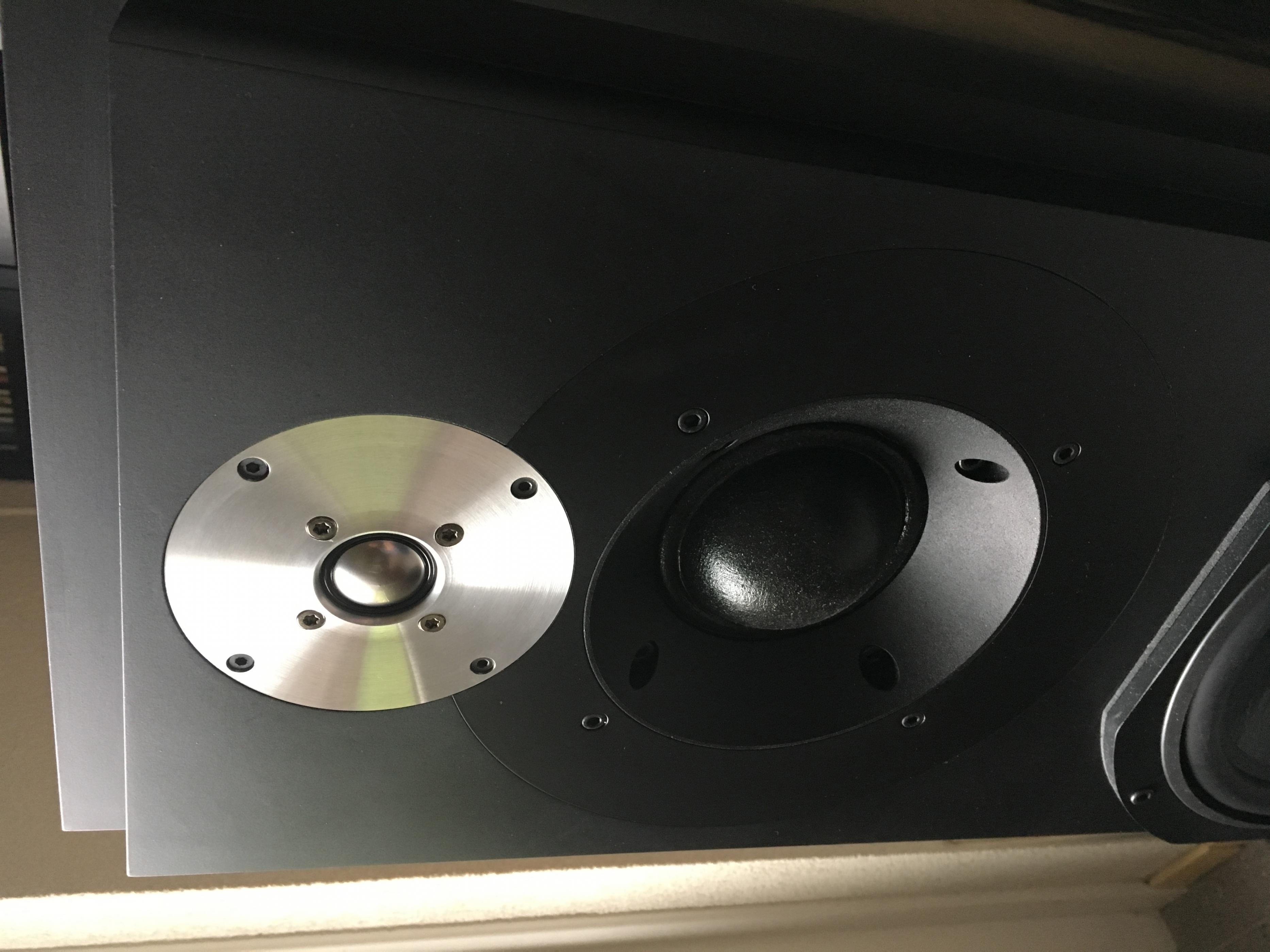

So my Wilmslow Prestiges are now cured. I have tweaked the standard crossovers slightly but the main improvements have been wrought in order of magnitude by:
1. Changing the standard WA capacitors for Jantzen cross caps
2. Swapping the WA inductors for Jantzen C Core and Air Core. Wimslow had installed 1 x 0.5mh and 1x 1mh in pace of 2 x 0.47mhs!
3. Swapping the series caps for Jantzen superior
They now sound amazing!

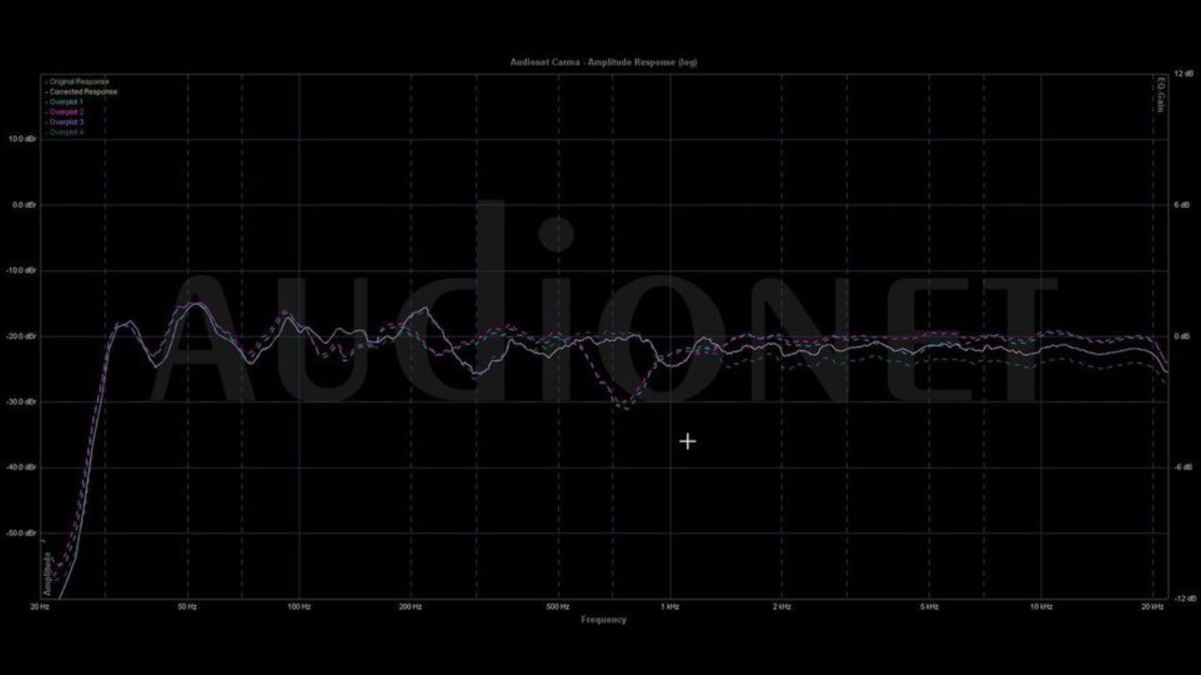

As said from my first post I bought them to use active crossovers from the start. I don't know if your hostility towards me is some jealousy at getting a bargain on them or what. But in saying I 'failed to fix them' you have entirely misunderstood my intentions from the beginning.
I have two other systems with active crossovers, one using scan speak drivers throughout. I believe active is better for loads of reasons. If they had been fully built and fully working I would still have ripped out the crossovers and made them active as I said from my first post in this thread.
I beleive they are now working better than they ever could have with a passive crossover (see my measurements for the corrections required to freq responses of the drivers). Soon they will have new cabinets too.

In retrospect i realised I had not done the tweeter phase reversal test with the correct, replaced, better and tighter toleranced components I had installed. I had only done the test with Wilmslow's poor caps and non matching inductors.
I can confirm it does sound better with the tweeter phase reversed with the better and correct components so Steve was right.........
The sound is more airy, natural and atmospheric. it now sounds right and more integrated
