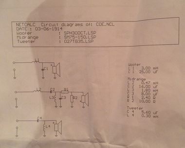

Wilmslow Prestige postscript: I pulled out my crossovers and checked them against the Wilmslow schematic. Effin' hell, the caps have different voltage ratings and the inductors which should be 0.47mh are marked 0.5mh and 1mh! This is clearly wrong. I swapped out the Wilmslow caps for some Jantzen cross caps and have a wonderful improvement in SQ over the Wilmslow caps. the caps have just got better and better so now I have bass!!!
Next up will be the correct Jantzen inductors. Wilmslow really are a bunch of cretins!

AFAIK, what you SHOULD have is a crossover like below, with a swap on mid and tweeter polarity if we have come to any sort of conclusion.
But capacitor voltage rating is entirely a matter of taste. A 0.5mH aircoil will scarcely sound different from any other sort of 0.47 coil. Now a 1mH coil in place of a 0.47mH coil might be slightly worrying, but measure it. Wilmslow may simply have unwound a 1mH coil to suit.
Overall I am singularly unimpressed by you guys efforts with this speaker. Big on complaining, short on detail or effort.

From a technical point of view you probably have a point but the OP thought he was buying a fully sorted out, and proven, design that could be built into a fully working top-quality speaker. WA do not appear to have sold him that. There are different levels of DIY and some people want to make proven kits, others want to start from scratch.
Sorry, juancho, but sort it all out before you start name-calling. 🙄

Are you serious? The guy bought a kit, hes paid for the IP of an expert designer. I don't know your knowledge on speaker design, but the from what I have read on this forum by experts I trust, modelling crossovers doesn't get you there, you need to know what your doing.
It's a pity there isn't a Like button on these threads. I agree entirely. I believe he was sold the wrong crossover and WA won't own up or can't tell which is which.
