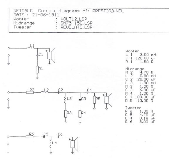

I understand what Steve is saying because all you have to do is:
1. Post a copy of your crossover circuit to make sure we are talking about the correct crossover as measured by Steve. If it is, try his suggested mods.
2. In any event reply to Wilmslow stating that a crossover designed to cross at 380/3,800 is unfit for purpose for use with the supplied Volt mid the specs of which are 'Frequency response 500Hz - 4000Hz'.
As noted previously, 380/3,800hz cross points is the spec recommended for the ATC mid

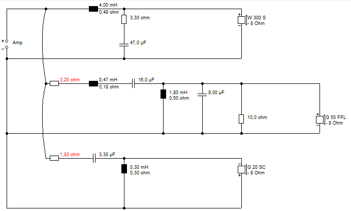

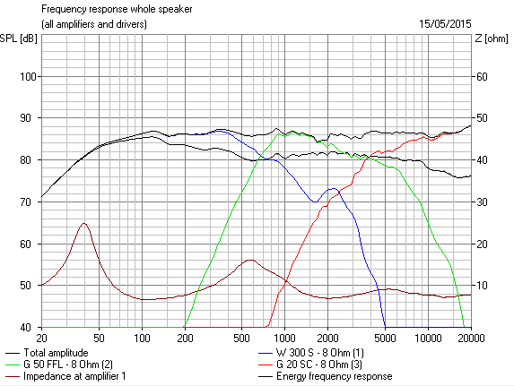

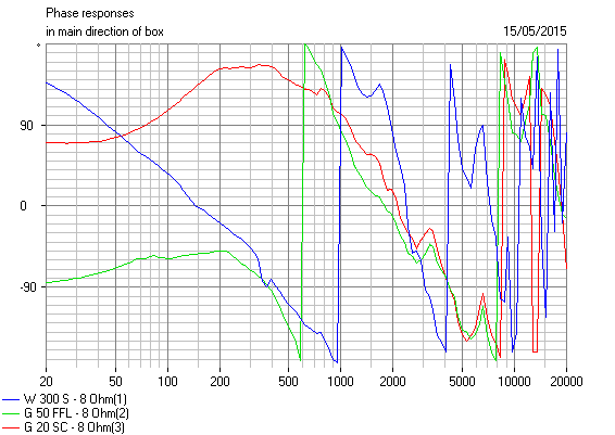

I've been quietly working at this Wilmslow Audio Prestige speaker. First, let's decide on the RIGHT IDEA on implementation of your standard 3 way design. It's pure Steen Duelund. You just go for a target response as in the first image below.
So where does the Wilmslow speaker go wrong?

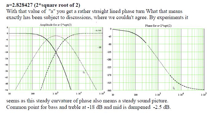

** Firstly, that a soft dome mid has a steep rise into its presence band. Nearly LR4. The bass filter however is second order, so is LR2. This is not what Celestion did in the Ditton 66. They used steeper 4th order bass and it worked better. So phase is a mess between the bass and the soft dome mid. Hence the unusual ++ polarity. About 700kHz crossover.
** Secondly, with a second order LR2 rolloff to the soft dome mid, you must use second order slope and 3.5kHz filter on the tweeter. This is a negative polarity solution with good time alignment, which of course is a bit driver dependent too, but the overall polarity is ++-.
** Thirdly, Wilmslow have a huge variation of drivers on this model. The bass and tweeter filters are quite a moveable feast. But actually, the mid filter resolves itself to be quite fixed.
So the second image is the troublesome and wrong KatieandDad filter. The third image is the much better juancho filter. The fourth image is my generic solution followed by its frequency response and phase on ++-. I'd be comfortable tuning the tweeter and mid level by ear just by changing resistors, but I'd need to model the precise bass carefully because slopes are very driver dependent.
Overall, I think Wilmslow finally got it about right with the juancho filter in image 3. I came up with similar if we get the polarity to ++-. Complicated post for a complicated speaker. Hope it helps.

Thank you for an incredbly thorough post and analysis of the various iterations involved. I think that will take me the weekend just to digest! Hopefully it will clear things up for some of the other prestige owners.
You do realize the simulation is based on Visaton drivers from
their database in Boxsim? Yes, I understand it's harder to trace the
plots of the actual units, a couple of hours of work easily.
Even then it would have been flawed to a certain degree.
