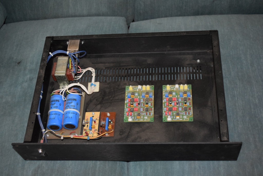

Sorry about the mis-description of the active crossover.
The project was slightly more advanced than I remembered.
There is indeed a PSU with 0-15 + 0-15V 50VA transformer into substantial high speed bridge and Philips 22000uF caps.
There are two LM317/LM337 boards set to approx +/- 15V I seem to recall.
The 2 x P90 Linkwitz cossovers are as yet un-mounted. The Euro Mains Plug has been fitted.
Basically you get what you see in the photo plus the lid for the chassis.
The Op-Amps are OPA2604s. Quality components were used throughout the build and all closely matched.

It will be good to see how things develop. Are these active analogue crossovers using op-amps or something else? Is it what you intend to use longer term? Do you intend to use the crossover for more than the crossover slopes?using three power amps and an analogue crossover.

Basic analogue variable pro crossover - dbx.
I find it very useful for modelling different crossover points and taking measurements whilst protecting the drivers in their passbands.
I believe the quested and ATC active versions that use the same drivers as these, use 4th order electrical slopes, and I was pleased with the measured phase and coherency of the set-up as is.
I was planning on going fully digital - PC source - digital crossover, or PC based crossover - but they sound really excellent now, so I will give it a few weeks to see how things go.
