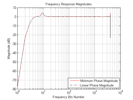

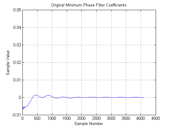

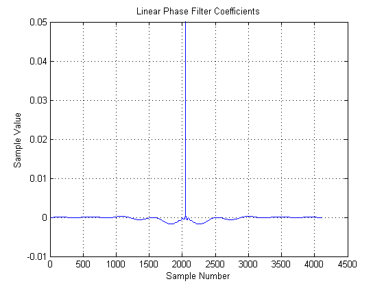

If you can take the convolution steps on the minimum-phase FIR file i attached and provide your linear-phase version,
then I will run a transfer function on the two versions.
No better proof positive than that, i think.
I usually get paid for things like this, but for now I'll let that pass and just say that three pictures are worth a thousand words. Note the vertical scales on the waveforms, and also that there is a peak at sample "0" in the minimum phase plot with value near 1.0.
Thx for that.
I've been talking about real FIR files, with tap limitations.
Do the graphs you show reflect tap limitations?
Or are they pure math based on the trace of the FIR file I posted ?
Seems like they must be, because I simply cannot reconcile magnitude response being the same with real FIR files.
Can you provide a linear phase FIR file that you made from the convolution steps outlined, that I can load into a processor?
Like said, I can run a transfer function one against the other, in about 30 seconds 🙂

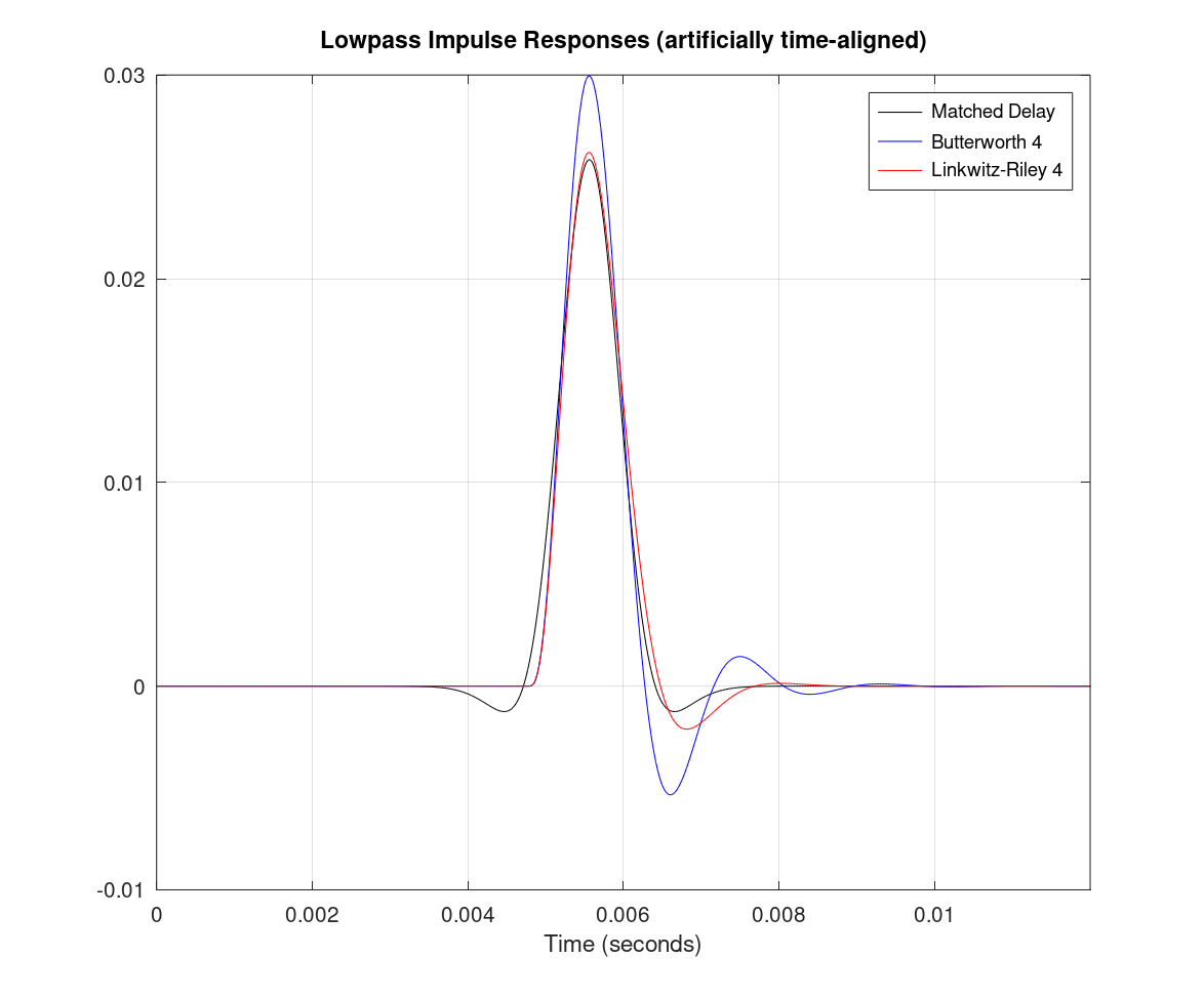

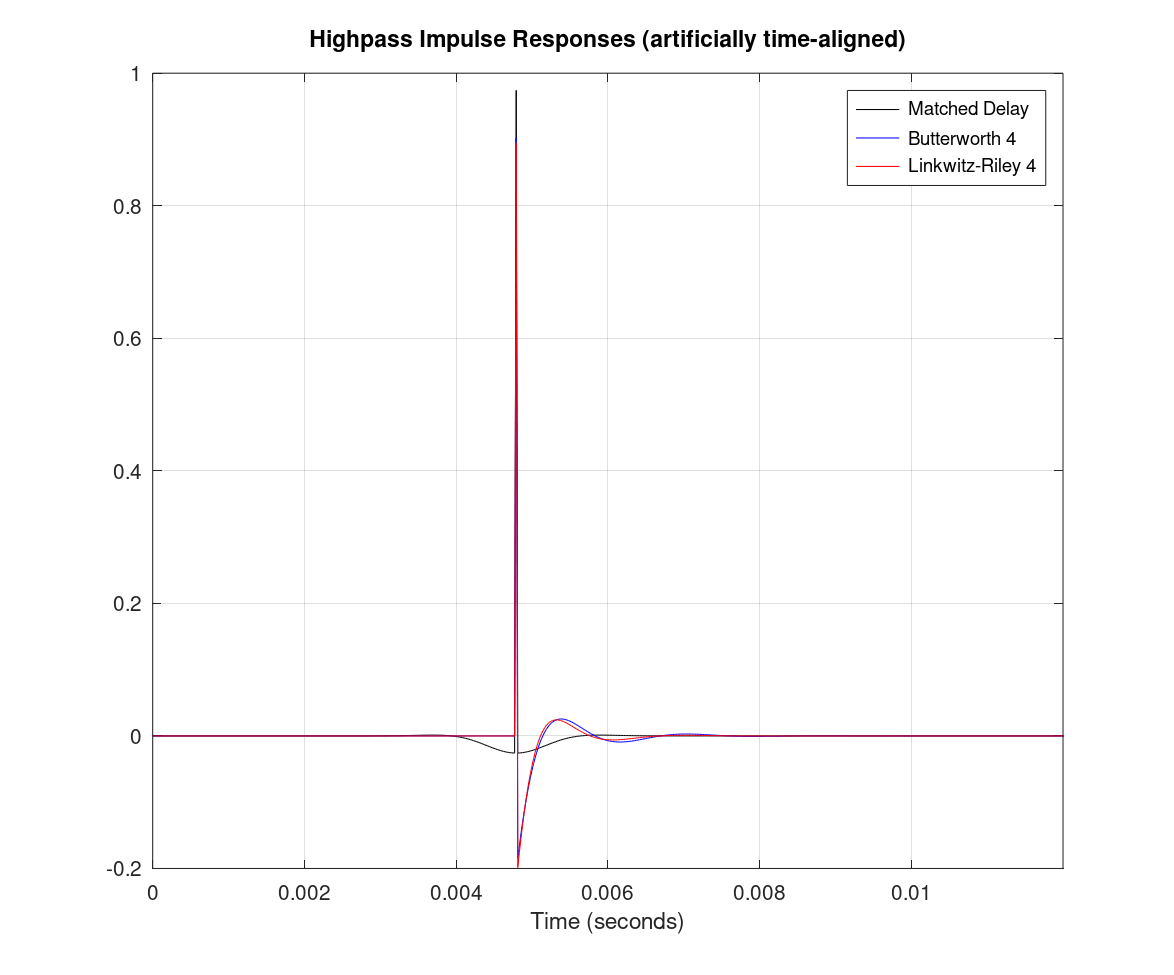

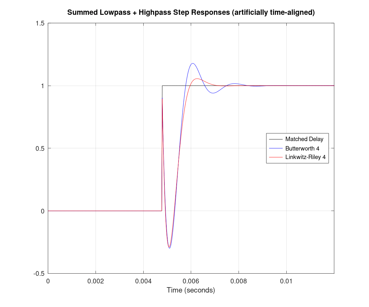

Hi @pos thanks for looking,
@gberchin shared a paper with us of a Matched-Delay Subtractive Crossover Pair With 4th-Order Highpass Slope. When the two are combined (LP filter and HP filter) there's no ringing. See this summation example:
step-png.1123218
This paper he shared with us trough PM, see this post:
I'll be happy to. Anybody who's interested, just send me a private message with your email address. I'll send you the latest version of the paper.
(actually, a PM was enough as the paper could be attached to a DM)
In a later post he shared his continuous development of his work here: https://www.diyaudio.com/community/...nearization-by-fir.393435/page-6#post-7213543
I believe this crossover type would be easiest to implement using FIR files, so that made me think of your RePhase program. If there's no objection from @gberchin to do this. And you'd be willing to work out the implementation. We can hope though, right? 🙂
I have no idea what you're talking about. You choose to disbelieve the truth even when the proof is presented to you. I'm finished.
Thanks for the info.
I am probably missing something and need to take the time to read the thread and paper, but if implemented using FIR what is the advantage compared to a pair of 4th order LR filters, which will also sum with no ringing.
Sorry I meant to say linear-phase LR
Well, if you're comparing one FIR linear-phase perfect-reconstruction crossover to another, then it comes down to just a couple of items: number of coefficients and transition-band slopes. Frankly, the difference in the number of coefficients is probably not worth arguing about. The Gaussian-derived MDS lowpass filter has much steeper lowpass slope, and similar highpass slope in its 4th-order highpass version (there is also a much simpler 2nd-order highpass version).
The MDS crossover also has the option of using an IIR Bessel LPF instead of a FIR Gaussian LPF, while still achieving perfect reconstruction and approximating linear phase. This may lead to some implementation advantages.
In rePhase there is the "reject high" linear-phase filter type that has a similar behavior.
Sure, being able to use IIR is a clear benefit.

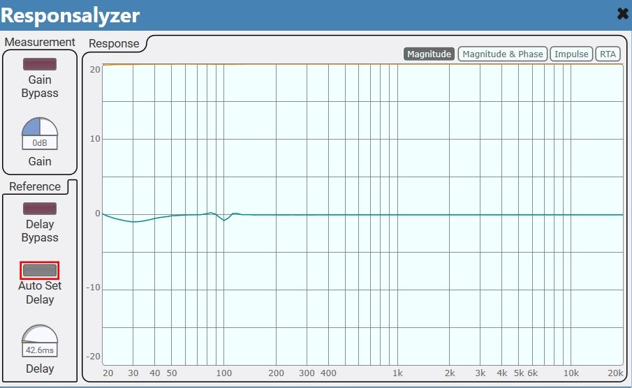

Thank you very much for those! 🙂 we cross-posted i see...
Just tried them.....something appears amiss.
I'm measuring that both your versions show a FIR time delay of 85.29ms, which is about 2 samples short of the entire 4096 taps@48kHz filter length.
The min phase FIR I posted, with impulse center at 1 sample , has essentially no delay.
I'd expect a lin phase version, with impulse center at 2048 samples to have 42.67ms delay
edit: here's a transfer function using the min phase version i posted as reference, and a lin phase version i made shifting impulse to center, as measurement.
It has the lack of frequency resolution, I am used to seeing in such comparisons.
Reactions: Oabeieo
