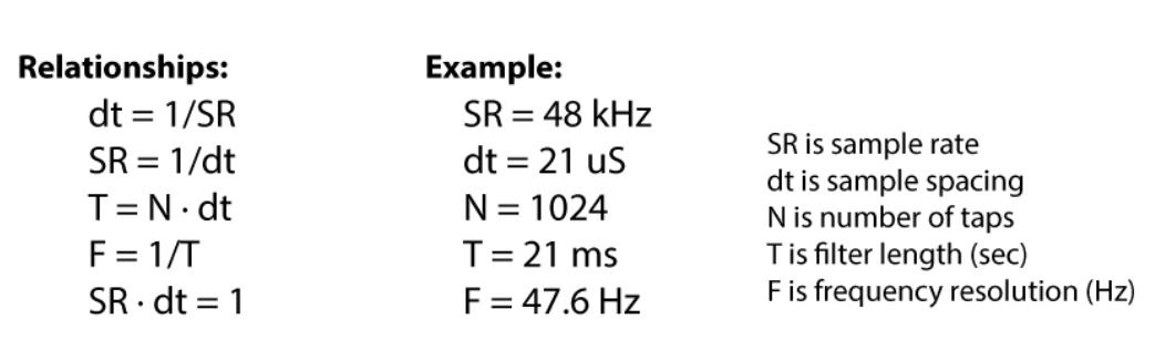

I understand that F=1/T, where F is frequency resolution, and T is time in seconds.
What I think to be true, is the "effective" T in a FIR filter, is the time duration of the samples that are after the impulse peak.
My thinking comes from articles such as this one. https://www.prosoundtraining.com/2016/05/20/fir-ward-thinking-part-5/
And a minimum phase FIR example of frequency resolution.
The article goes on to contrast the minimum phase resolution with the same size filter used for linear phase.
"By using 1/2 of the filter length for “negative relative time” corrections, the frequency resolution of the filter is halved. For example, a 1024 tap min phase FIR has 47.6 Hz frequency resolution. The same tap length for a linear phase FIR has a frequency resolution of 95.2 Hz, since up to one-half of the filter length is reserved for phase equalization."
I've no doubt with your expertise, that can find a number of points in the article that are either in technical error or need restating.
But setting those aside, is the article pragmatically correct? Frankly, that's all I care about....simple real-world, how to make stuff work.
That is a trivial definition of "resolution". What is true is that the frequency bin spacing in a Discrete Fourier Transform is the reciprocal of the time spanned by the samples being transformed (whether those samples are nonzero or not), and that the time domain sampling period is the reciprocal of the sampling frequency.
There are more sophisticated ways to determine duration and resolution of real signals. They often use moments are are therefore similar to statistical methods like variance and standard deviation. As I mentioned once before, simply adding a bunch of zero-valued samples to the end of a time-domain waveform doesn't increase frequency resolution.
No, no, no, no, no! There is no concept of "before" or "after" in measurement of the duration of an impulse response (coefficients of a FIR filter). You can create a minimum-phase impulse response, with its peak near the beginning, truncate its length to something manageable, and measure its duration. You can then reverse the order of that impulse, so that the peak is near the end, and its duration will be identical to that of the original "forward" impulse.
That would only be true if one were to convert a linear-phase filter into a minimum-phase filter by simply zeroing the first (or second) half of the filter. That is not how it's done. A minimum-phase filter and its linear-phase equivalent have exactly the same length and duration -- they must, since they produce identical frequency response magnitudes. You've seen some examples of that right here.
I don't know what the author of that article was alluding-to, but that's not how it works when done properly.

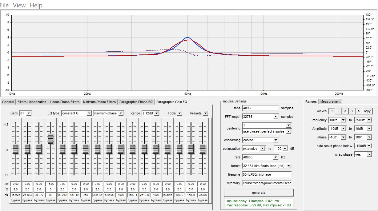

And make that the only filter up for comparison, for further simplification.
So nothing but a min-phase 50Hz, Q=6, +5dB PEQ.
Using same size file as previous, 4096 taps@48kHz.
Even with impulse centering at the start and extensive optimization, 4k taps can't quite track the PEQ without error.
(Output gain is lowered 1dB to preclude clipping)

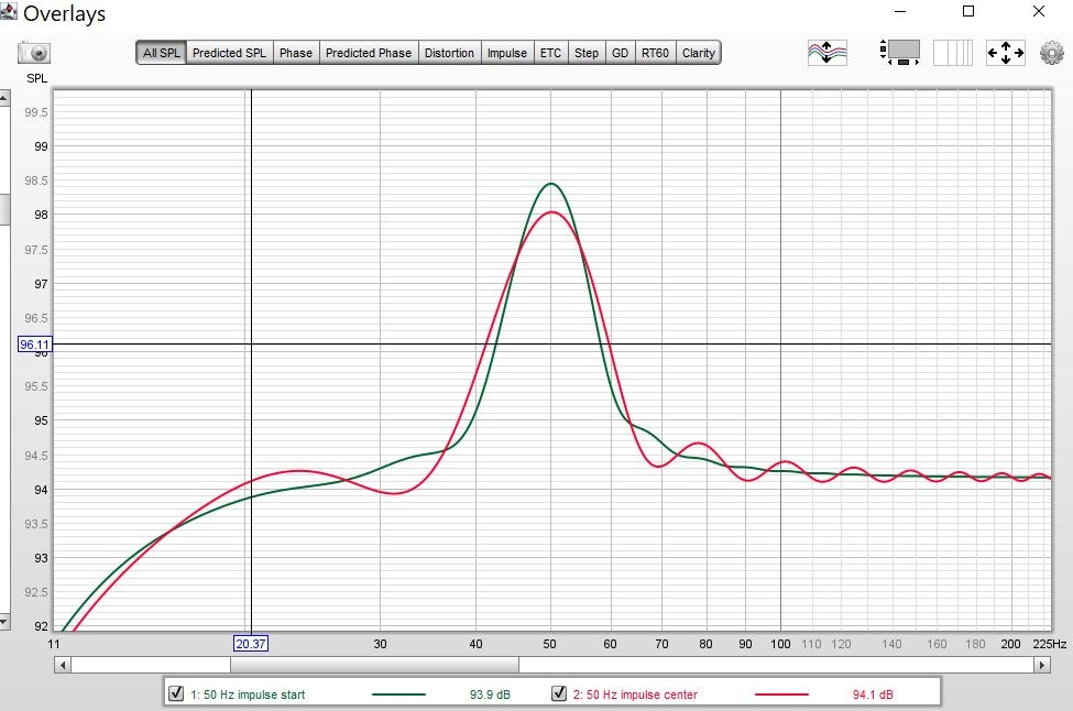

Moving impulse to center.
That the best rePhase's extensive optimization could do with the taps available.
Here's the FIR file with impulse at start.
If you can move impulse to center and match its magnitude response, that would be really cool. (same size file of course)
Better than RePhase I think, isn't it ?
Yes it is ! Nice.

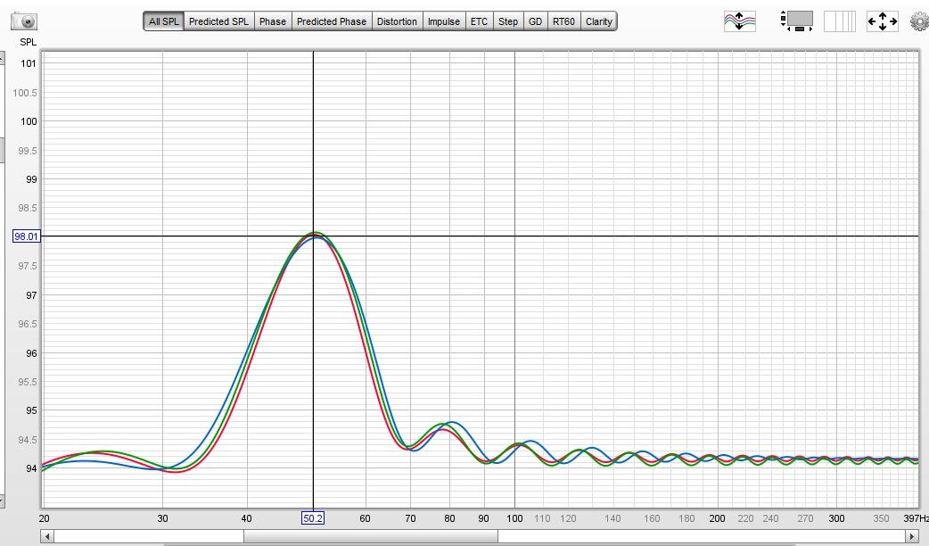

here's REW comparing the impulse strart version i posted in green,
and your impulse centered version in red.

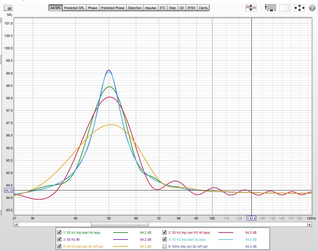

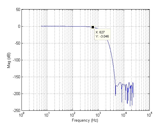

To illustrate the need for more taps to handle the 50 Hz PEQ and fully match IIR.
Purple: pure IIR
(following used rephase 'extensive optimization', other than newvirus's as designated)
Blue: 8k taps and impulse at start
Green: 4k taps and impulse start
Red: 4k taps and impulse in center ala newvirus's optimization
Orange: 4k taps and impulse in center ala rePhase
Hey newvirus, you inspired me to make some more comparisons, with that nicer optimization of the 50Hz PEQ, 4k taps centered.
I went to my go-to FIR generator, FirDesigner, to see how its default output looks for 4K centered, ......to compare to yours.
(been using rePhase so anyone caring to, could duplicate what's posted)
Seems like whatever optimization you are doing, is quite similar to FirD's.
Red is your file.
The Blue trace is FirD with its default Cosine Tapered window.
Green, which lies even closer to your trace, is using Boxcar windowing.
Is boxcar what you used?

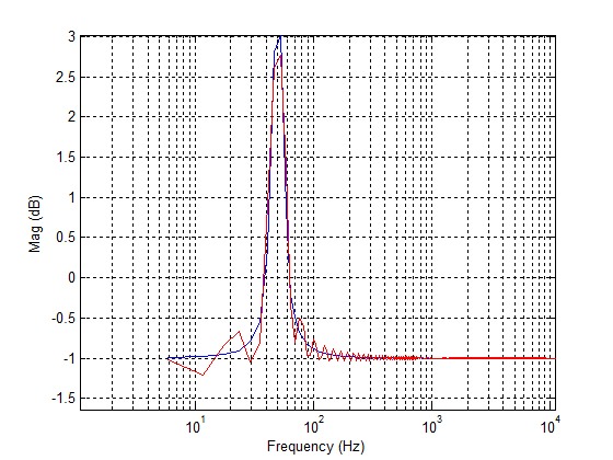

Here is an example from Stanford, math that I don't understand but the impulses are the same length and so are the magnitudes with a pretty steep filter.Point being the test wasn't that hard, and I think optimization can only go so far.
https://ccrma.stanford.edu/~jos/filters/Linear_Phase_Really_Ideal.html
It seems to me that you are looking at making rules based on how specific programs respond and I can understand as they do behave that way.
I found some of gberchin's previous articles kind of by accident but the FDLS algorithm seems to be very powerful.
https://www.iro.umontreal.ca/~mignotte/IFT3205/Documents/TipsAndTricks/PreciseFilterDesign.pdf
Example files attached
and there is a python version for those without Matlab
https://github.com/blair3sat/fdls

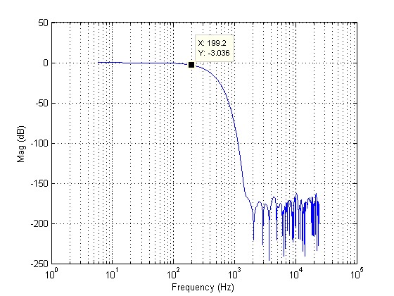

Here're FIR copies of the Gaussian function (4096 pts) for anyone interested in trying Mr. Berchin's crossovers.
