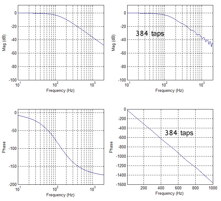

Some rule-bending below (wav attached).
The filter is non-linear phase but together with the non-linear phase of an existing Butterworth filter, can give more or less linear phase all the way upto fs/2. The impulse is not at the centre of the file and the delay is only about double that of the regular filter.

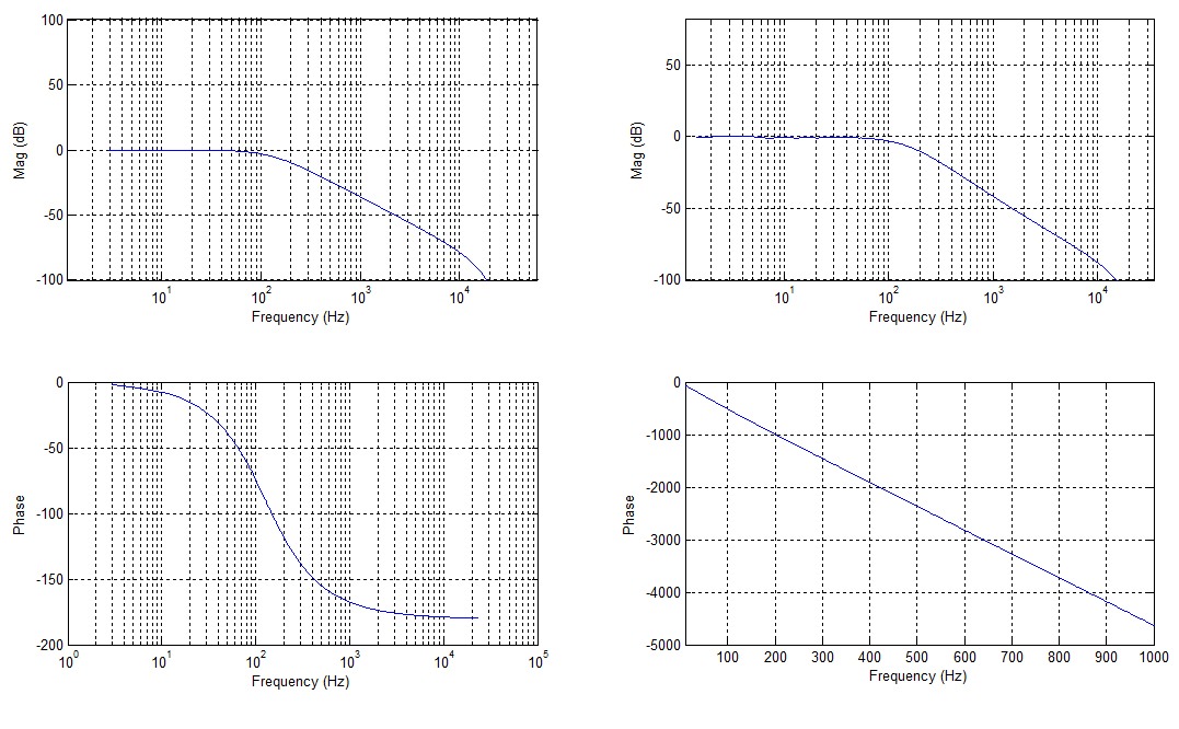

Directly applying a linear phase FIR gives a delay of N/2, but what if the linearity in phase is the result of combining two non-linear phase filters (FIR or not) with small delays ? Won't the net delay be much smaller then, in spite of the linear phase ? See a realistic case below.
For example, f = x^2 is non-linear, so is g = 1/x, but their product f*g = (x^2) * (1/x) = x, is clearly linear isn't it ?
In my opinion, "true" linear-phase is pretty much useless for real-time application, if it comes with a large delay (say 100ms). Most wise people would simply prefer responses with much smaller delays, even if there's some small error in the linearity of phase, especially outside the pass-band of the filter.
To me, "linear phase" is just a synonym for flat phase at zero degrees across the spectrum.........
......which is easily satisfied by an analogue / IIR first-order crossover with minimal delay. That is definitely not the kind of "linear-phase" we're talking about in here.
The processor I use (QSys) is the most flexible and programmable I've yet encountered. ........ with 16k taps per channel....

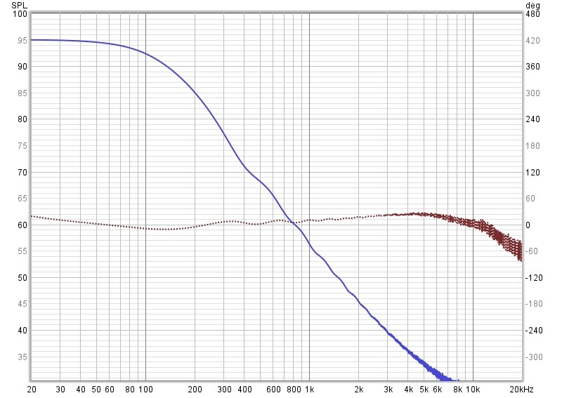

Here, try this 16k tap 100Hz low-pass filter (attached) and tell us if its phase linearity is good enough to you. The delay is approximately 15-20ms. Note that this is the entire filter IIR + FIR, both non-linear phase.
I have also attached the correction filter alone (8k), that you may apply on top of a 2nd order 100Hz (-3dB) IIR Bessel filter (8k) to obtain the same result, live.

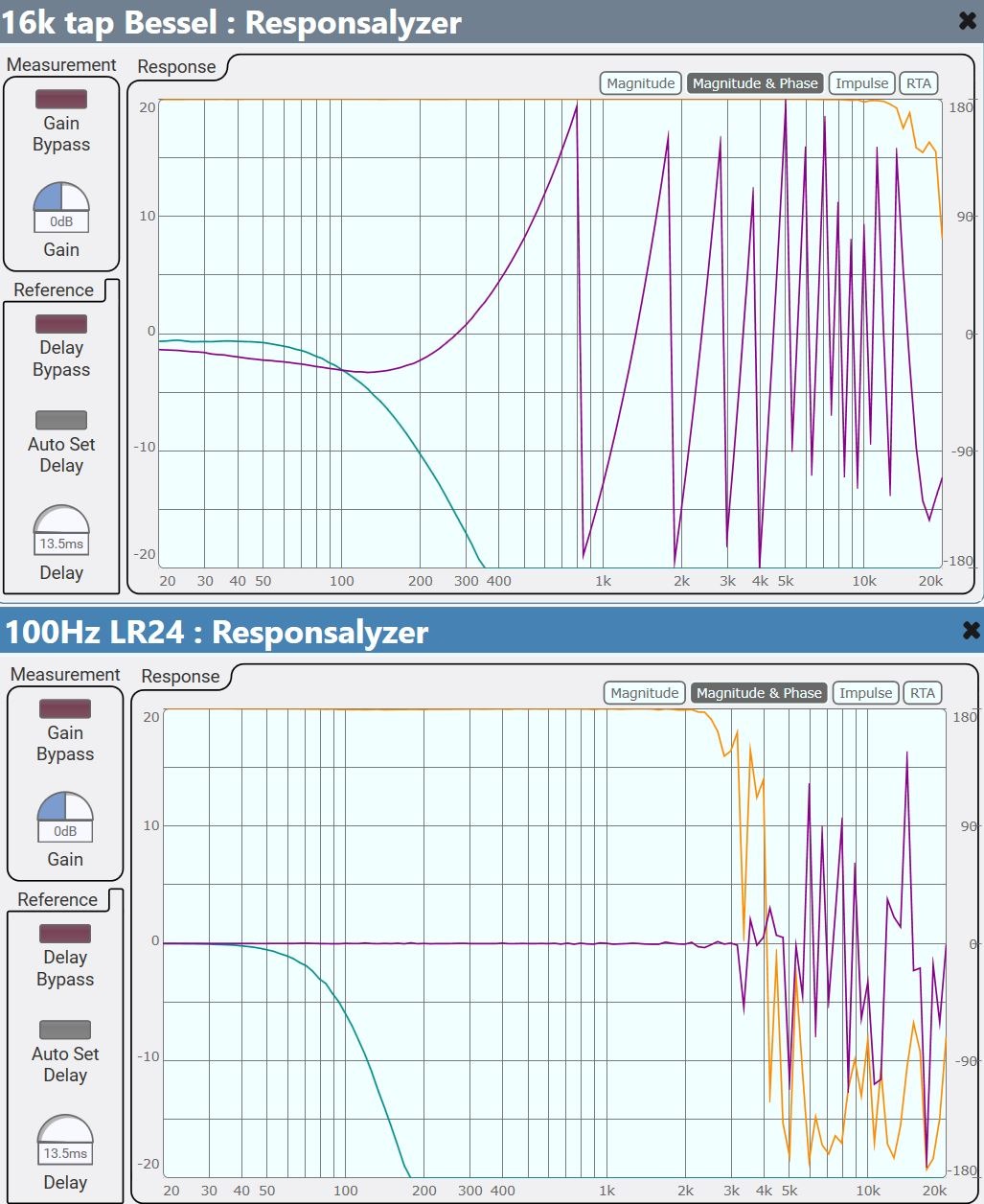

I got the same transfer functions for both your:
straight Bessel 2nd order @ 100Hz 16k FIR file,
and for the smaller 8k file for partially linearizing the same IIR Bessel.
Like you knew I would, and both had the same 13.5ms delay.
They look pretty good, but they illustrate the point I've been trying to make about why bother with something so complicated.
When for the same 13.5ms delay I can use a simple linear phase LR24. Or a LR12 with significantly less delay still.
Here's your Bessel transfer on top, and my LR24 on bottom.
Both with 13.5ms delay, and as you can see the LR24 is both phase flatter and has a higher-order rolloff (the harder to do for a given amount of delay.)

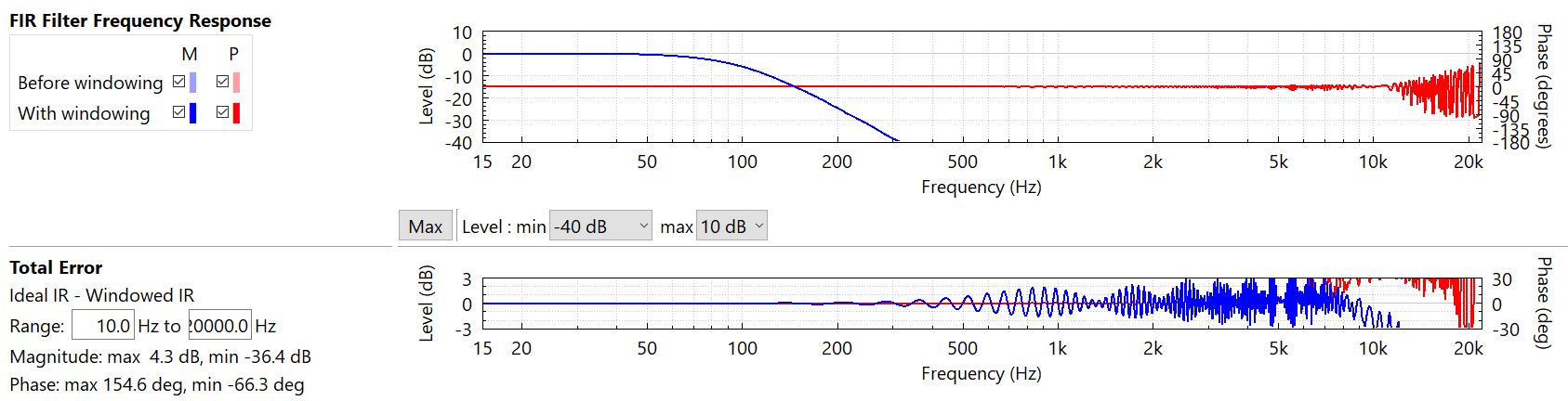

I played with just making a linear-phase Bessel 2 @ 100Hz, using half the delay above, or 6.75ms (648 taps total)
It's response, both mag and phase have essentially no ripple thru -40 dB.
Why make it harder than need be?

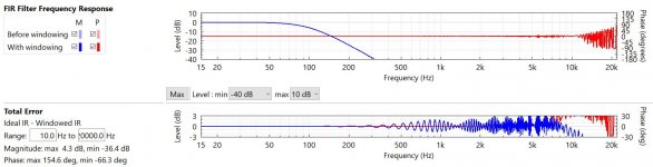

That's not the point. Like I said earlier, this is only a demonstration for learning purposes. Nobody would put a finished product onto an internet forum.
That is NOT a 100Hz Bessel filter, as the gain at 100Hz is about -5dB.

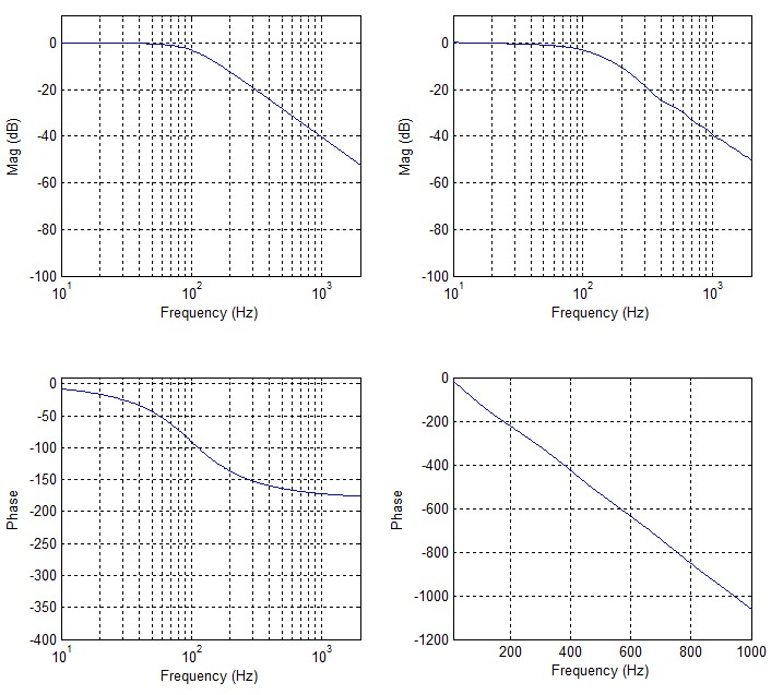

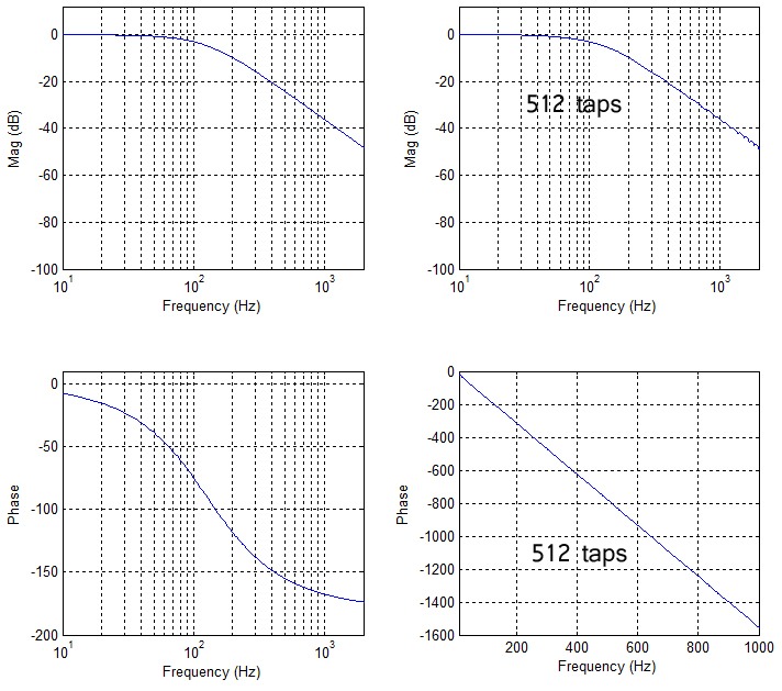

2nd Bessel, 100Hz, almost linear-phase, <5ms delay, 384 and 512 taps.
Hi newvirus, i honestly don't know what your point(s) is/are anymore.
My point above was that it is possible to get essentially linear phase (as in "linear" amplifier), without having to suffer the long delays of "true" linear phase filters. If you still can't believe it, then below is an essentially linear-phase filter (BUT2) with almost the same group delay (3ms) as that of its analogue version (~ 2.7ms).
Agreed. the more "true", perfectly flat, we want linear phase, the more time it takes. Nothing said by either of us goes against that. i think.

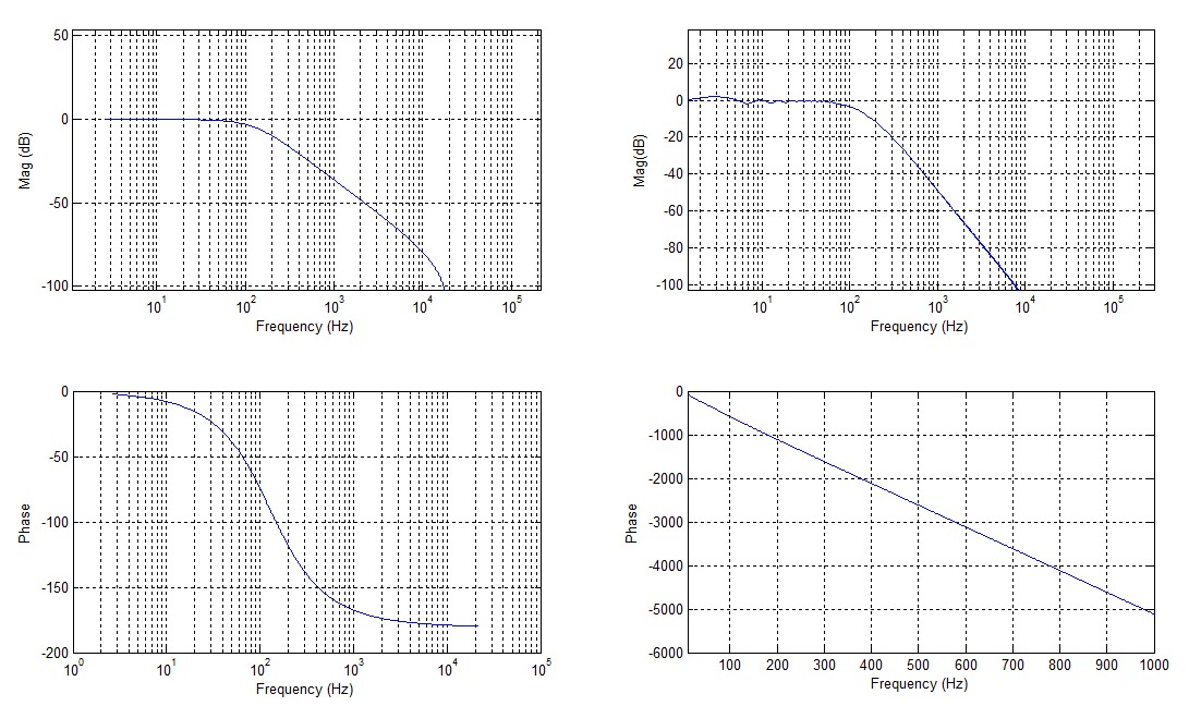

So I can obviously believe it 🙂

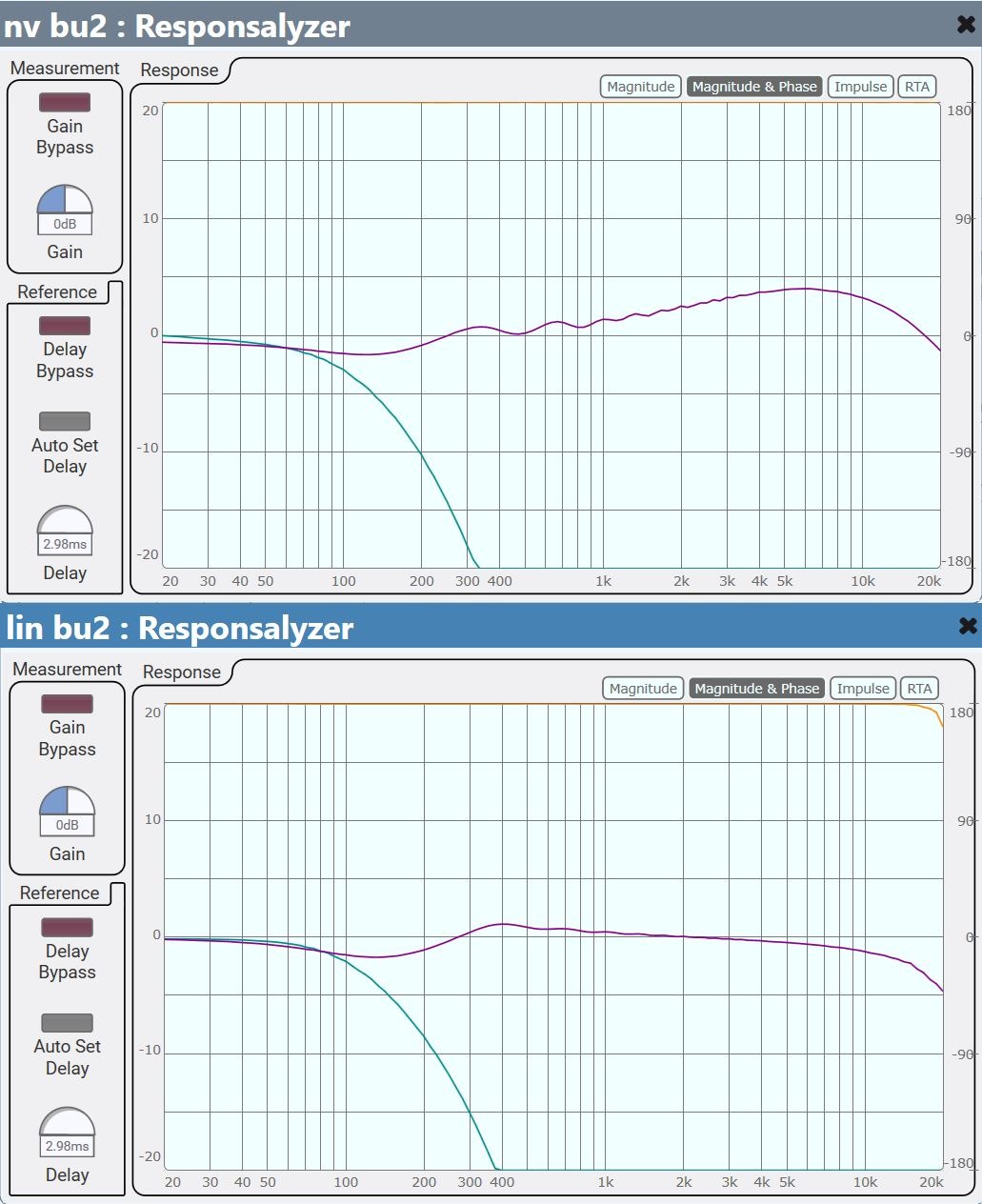

Below are transfers showing the same 2.98ms delay.
On top is the last BUT2 FIR file you sent.
On bottom, is a quick output of a linear phase BUT2 from FirD, constrained to the same propagation delay.
(I say propagation delay instead of group delay, because i'm in the camp that thinks constant delay is not a component of group delay)
Anyway, does it make sense to keep chasing a case where IIR plus some FIR phase optimization of it, rules vs lin phase with insufficient taps?
I don't think so.....I'm ready to let this lie...
Actually Mark, I'm sorry but I don't seem to follow those graphs. The filter I gave you has -120* phase shift at 100Hz (instead of the regular 90) but according to your software, there's little variation across the entire 20kHz band!!
Maybe "phase response" has different meanings in different parts of the world, after all.
Oh, let me see if i can help be clearer....
All the transfers I've posted have constant (propagation) delay removed.
The lower left corner of the transfer function snips, shows the constant delay that has been removed from the measurement.
So for instance, the last comparisons in #257 had 2.98ms removed from each.

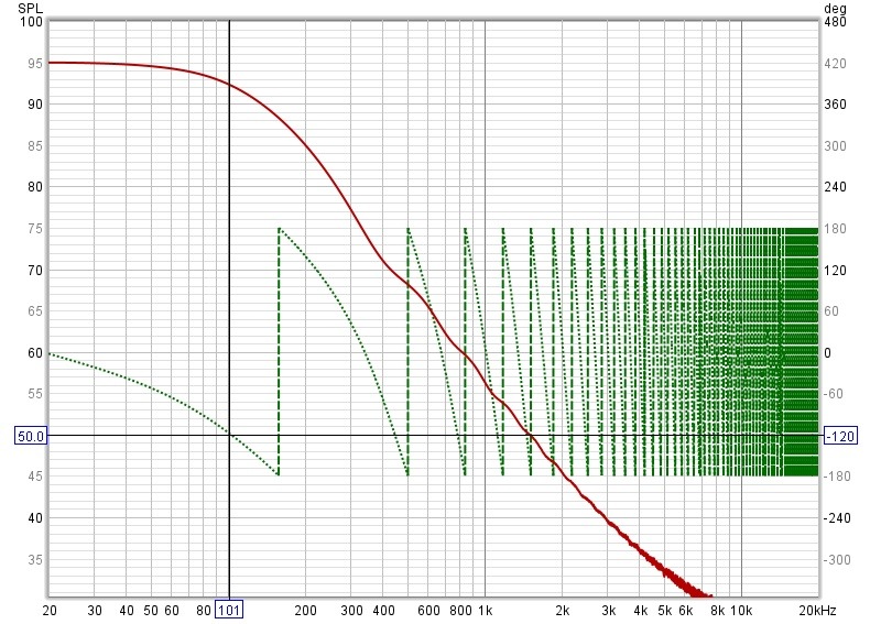

Here's REW on your BUT2 without that constant delay removed.
Has the -120* phase at 100Hz you expect.
And now with the 2.98ms constant delay removed.
Matching up with the transfer i posted.
I oh so strongly believe constant delay has to be removed from phase & group delay plots, to both make sense of them, and to compare them fairly..
