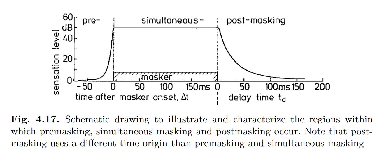

Pre echo distortion is a problem in perceptual coding and so quite a bit of study has been done in that realm.
https://www.ee.columbia.edu/~dpwe/e6820/papers/PaintS00-pcpcod.pdf
Most papers seem to refer back to Zwicker and Fastl's work on masking to determine if anything is likely to be audible.
This figure from Psychoacoustic facts and models has been re-produced in many other publications
This shows that the masking threshold goes down further into negative time from the masking tone. Pre ringing at lower frequencies therefore stands more chance of being audible, to create that kind of filter will need more taps, so as wesayso says the more taps you use gives a greater chance of making a bad filter.

Ahh I see what you mean now ….. interesting….. I never knew that….wow what a read , 68 pages…. All except the math , I can understand about 3/4ths of it….. I’ve become good at filling in blanks not knowing math…. I’m about half accurate lol
Most times it is described as softening the transients, in extreme cases fabricated to demonstrate it as a problem there is the sucked up sound to a snare drum. I can't say what it is you heard, looking at the filters responses that caused it might help, but unfortunately it is really easy to make bad filters when you modify the phase.It sorta sounds like rice crispies inside the speaker…. Or sounds kinda like a spring inside the speaker…..
