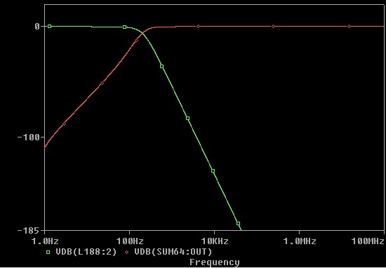

Yes, understood (picture). Thanks.You can use any order Bessel LPF that you want, and the complementary HPF will still only have a 12 dB / octave slope. That's the problem...
Try it with Hlp(s) a Gaussian. The resulting HPF will still only have 12 dB / octave slope.
As far as I remember, it was demonstrated long time ago by Ng and Rothenberg in IEEE paper. Maybe I'm missing some point and I need to describe the mathematics of your method in more detail, however, primary analysis using complex transfer functions shows that the result should be similar in both cases (i.e. using two serially connected substractive stages vs single substractive stage with two serially connected LP filters).
If you can show that "1 - (GaussianLPF * GaussianLPF)" (with appropriate delays) has a 4th-order highpass slope, then I would be very interested in this. It would simplify the solution by a considerable amount. I remain skeptical, however.As far as I remember, it was demonstrated long time ago by Ng and Rothenberg in IEEE paper. Maybe I'm missing some point and I need to describe the mathematics of your method in more detail, however, primary analysis using complex transfer functions shows that the result should be similar in both cases (i.e. using two serially connected substractive stages vs single substractive stage with two serially connected LP filters).
Obviously, that it can't be demonstrated that two serially connected Gaussian filters have 24dB/oct slope. Even simple cosideration of expressionIf you can show that "1 - (GaussianLPF * GaussianLPF)" (with appropriate delays) has a 4th-order highpass slope, then I would be very interested in this. It would simplify the solution by a considerable amount. I remain skeptical, however.
1-exp(-a*s^2)*exp(-a*s^2)=1-exp(-2*a*s^2) shows, that two serially connected gaussian filters still remain second order crossover. I missing the point, why two serially connected substractive stages gives 4th order Gaussian crossover as supposed by your design using convolution.

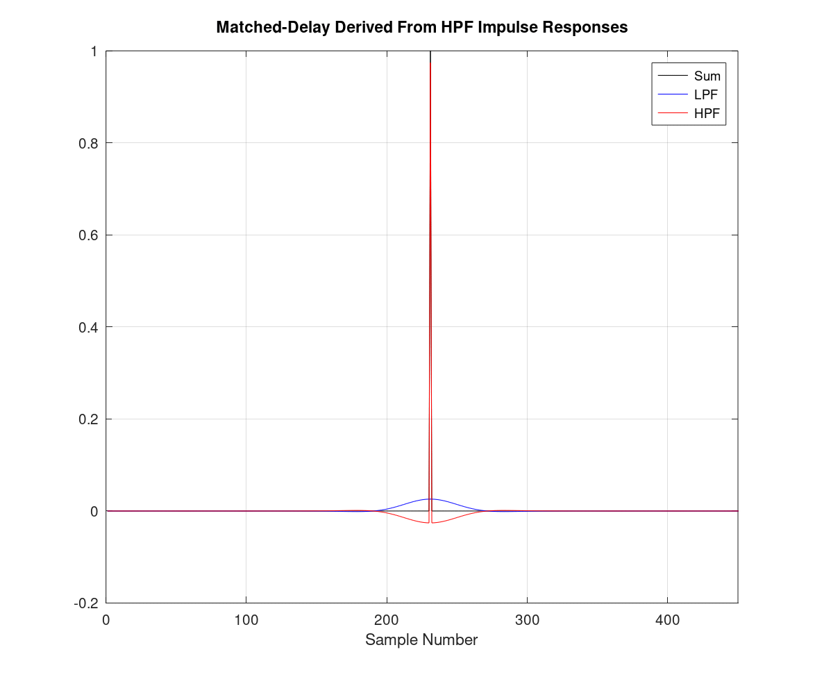

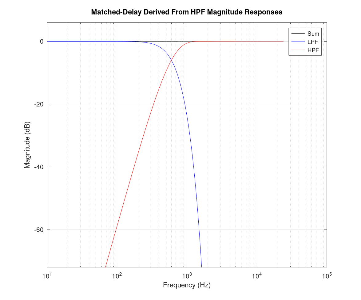

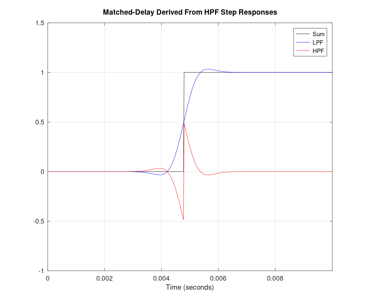

It doesn't. That's not what I created. I started with (1 - GaussianLPF), which has a 2nd-order highpass slope, and convolved it with itself, resulting in a 4th-order highpass slope. Neither of those highpass filters has a Gaussian shape. The lowpass complement of the convolution has slope approximately equal to the slope of the original GaussianLPF. Not exactly equal, just approximately equal.I missing the point, why two serially connected substractive stages gives 4th order Gaussian crossover as supposed by your design using convolution.
I've attached some graphics showing an example. For this I used a true Gaussian LPF and adjusted the width empirically to achieve an ultimate crossover frequency of 600 Hz. The resulting impulse and step responses are as shown. If you look at the highpass frequency response between 100 Hz and 200 Hz, you'll see that it changes by approximately 24 dB. Meanwhile, the lowpass response still rolls-off very steeply.
That looks quite nice to me, for when I could use 24 dB/oct high pass. (I really like the low-pass steepness!)If you look at the highpass frequency response between 100 Hz and 200 Hz, you'll see that it changes by approximately 24 dB. Meanwhile, the lowpass response still rolls-off very steeply.

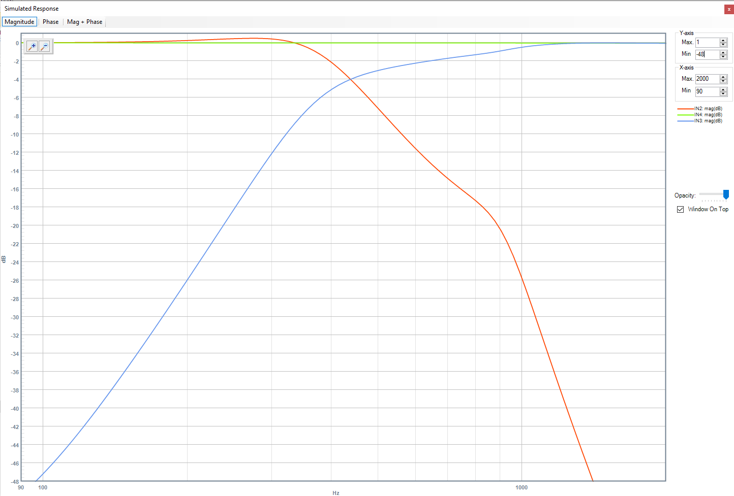

@gberchin , those look like excellent lin-phase target functions for an XO, thanks for posting this (and the corresponding paper). Being lin-phase filters, it will be also easy to extend that for more XO points. Time-domain behavior is really compact with minimal ringing.
For loudspeaker XO we will have to factor in the drivers' transfer functions to obtain the actual electrical filters but with modern DRC packages like Acourate it is not overly complicated to arrive at the proper FIR filter kernels. In some cases we might get away with relatively simple IIR post-filters to linearize drivers in magnitude and phase over the required range and thus we can use the implementation of the targets directly as is.
- Why not IIR filters + a global phase linearization by FIR
