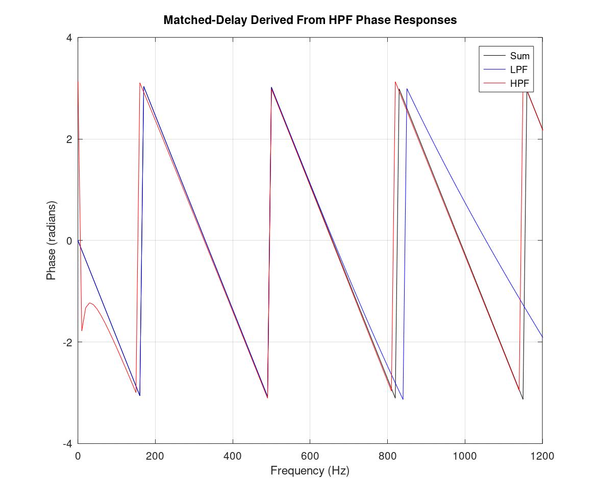

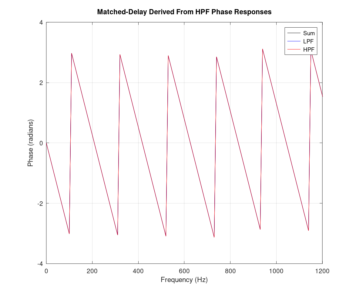

I just happen to have that information! The 8th-order Bessel crossover doesn't track perfectly, but keep in mind that as little as one octave away from the crossover frequency, one or the other of the magnitude responses is significantly attenuated. (Graphics from the 600 Hz, 4th-order HPF variant; the original 2nd-order HPF variant tracks even better.)
I am very pleased to see such informed discussion of this technique after it languished for such a long time.

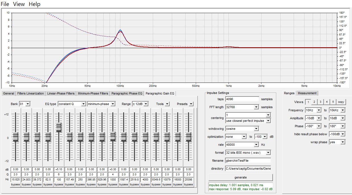

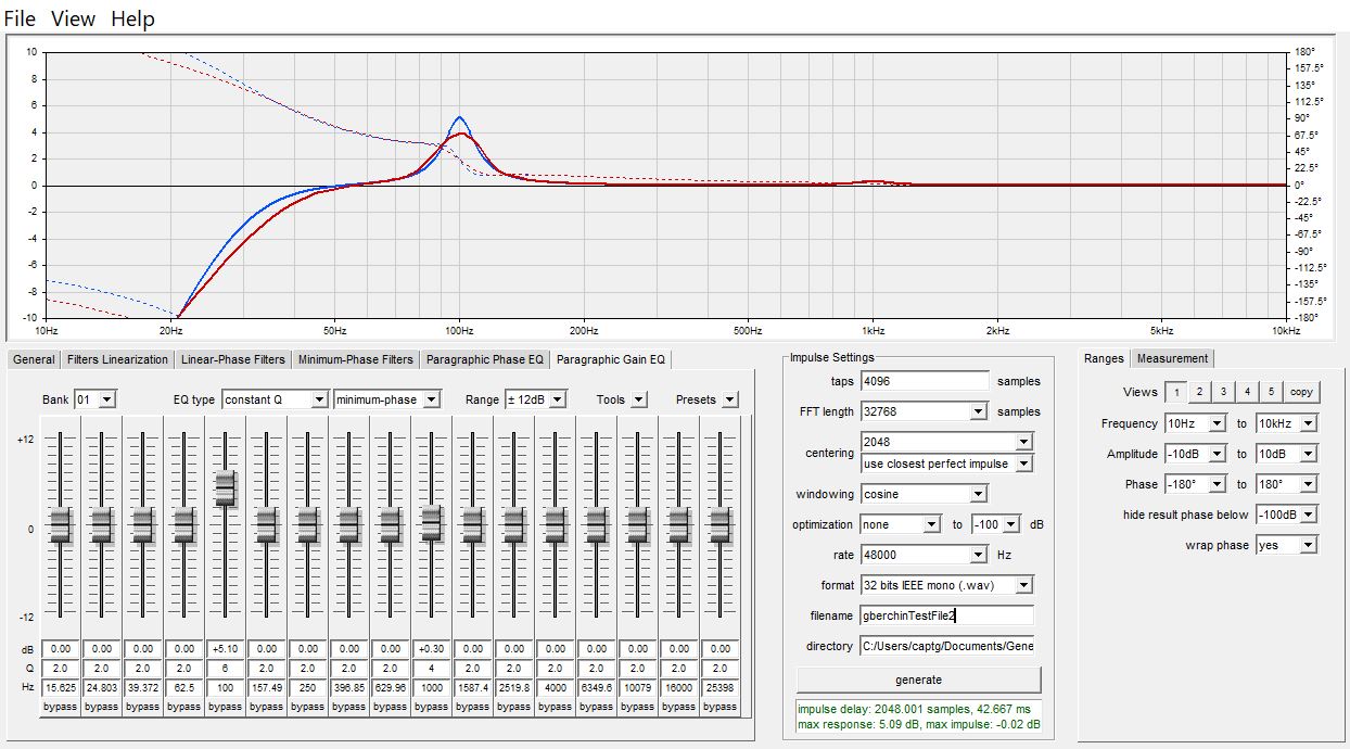

I haven't played with either time domain convolution of frequency domain multiplication in a while (simply haven't found the need given use of FIR)
Here's 4096 taps @ 48kHz minimum-phase FIR filter via rePhase. Single EQ as shown, Butterworth 3rd order high pass at 30 Hz. That's it for filters.
Impulse center at sample 1, and predicted match.
Impulse center at 2028 taps, and predicted match.
Different frequency resolutions equal different predicted matches, no ?
