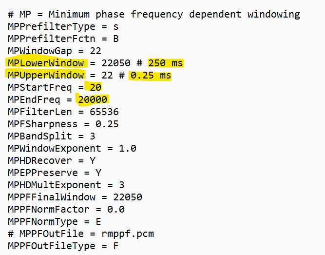

3 to 6 cycles is usually the range that works best for me but lower frequencies can be longer.Any guidelines on how many cycles should be included?
For talking purposes, say 100 Hz. 4 cycles would be 0.04 seconds. Would this tell me anything about what is happening at 100 Hz, or should I expand the window to capture more cycles... or ?
In terms of DRC-FIR, a recommendation is to start with the minimal template and then go up and down from there to assess the difference and if any artefacts start to become obvious. The minimal template has this configuration
With a sampling frequency of 44,100 the samples to time range have been included after the # 250ms at 20Hz, 0.25ms at 20KHz
With an exponent of 1.0, this gives a straight line from 1/2 cycle at 20K to 50 cycles at 20Hz.
Just remember that being able to vary the number of cycles on a sliding scale like DRC-FIR can is more flexible and can produce a better correction more easily than trying to replicate the process using multiple fixed window sizes. Perhaps no-one has asked @JohnPM for the ability to vary the window in this way? It seems like REW could provide an easier entryway if it did as more people are comfortable with it.

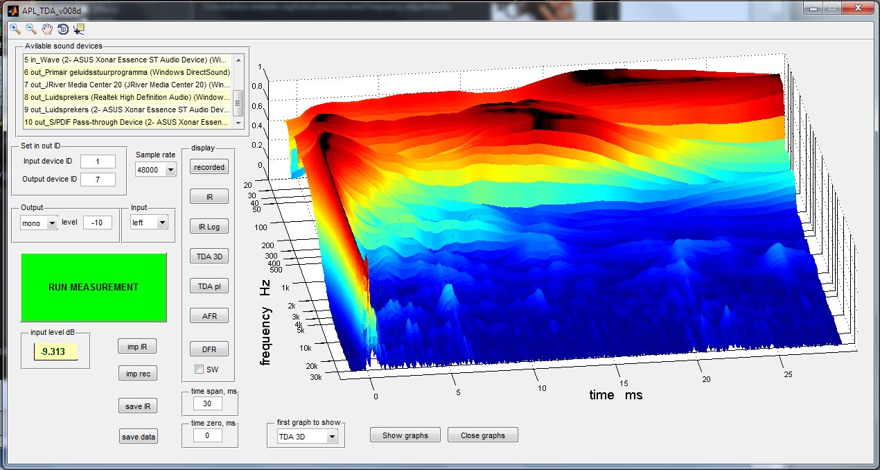

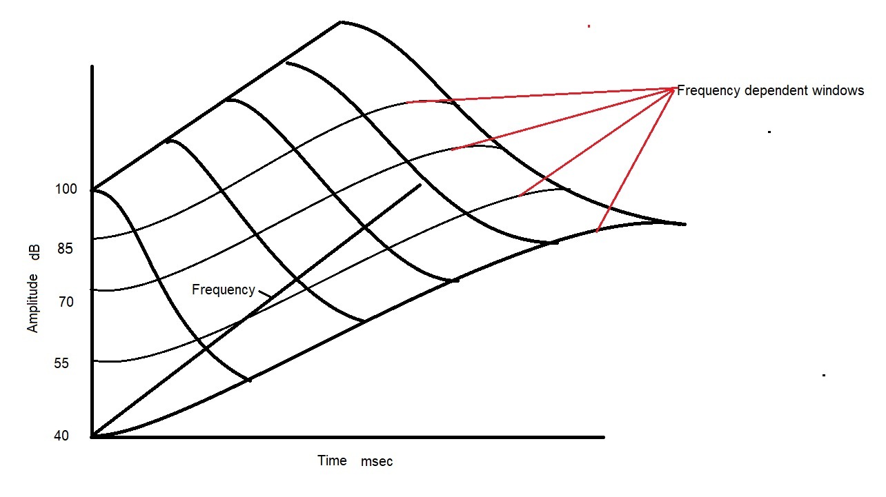

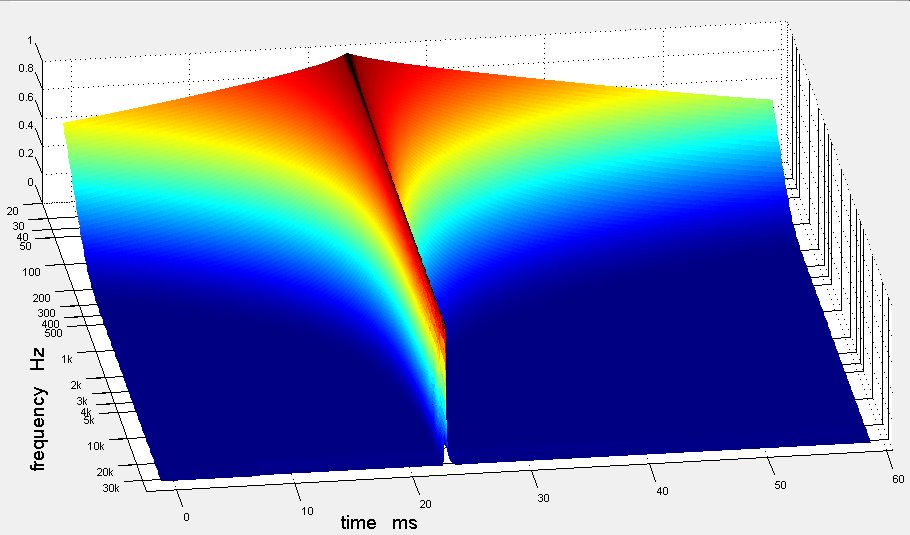

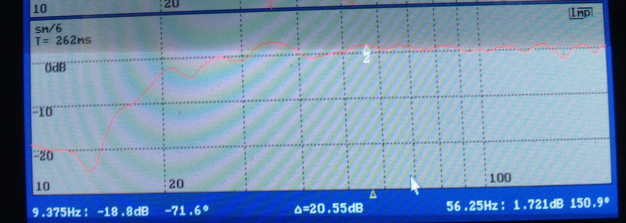

I was thinking about these FDWs and trying to get a better understanding of what they represent. I don't know if this has been discussed before, so here are my thoughts. I thought of RT60 and CSD plots (water falls) and how the decay time vary with frequency, . Typically the higher the frequency the shorter the decay time is. You can generate a 3-D plot (CDS) of the decay of a signal, Amplitude vs time as a function of frequency, as pictured crudely below. High frequency to low, front to back. Then if you cut a horizontal plane through that curve at a given amplitude you get a time vs frequency for the the signal to decay to that level. In a sense, would not each of these horizontal curves represents a FDW where you would be windowing out any contribution to the impulse where the level of the contribution at that frequency dropped below a certain dB level? Thus, in essence, using a FDW seems like imposing a decay curve for the room. So, when you choose a FDW for a measurement, the resulting response is perhaps similar to that of an un-windowed response of a room with a similar decay vs frequency, at the measurement position.
Do you suppose one could hear the difference between this:
And this:
As measured, a stereo pair of speakers at the listening spot? The program used to view this "wavelet" is APL_TDA which was available as a Demo.

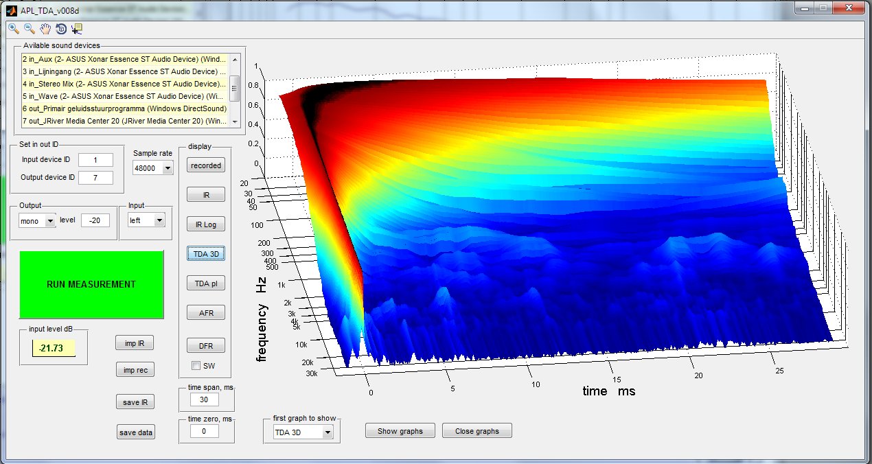

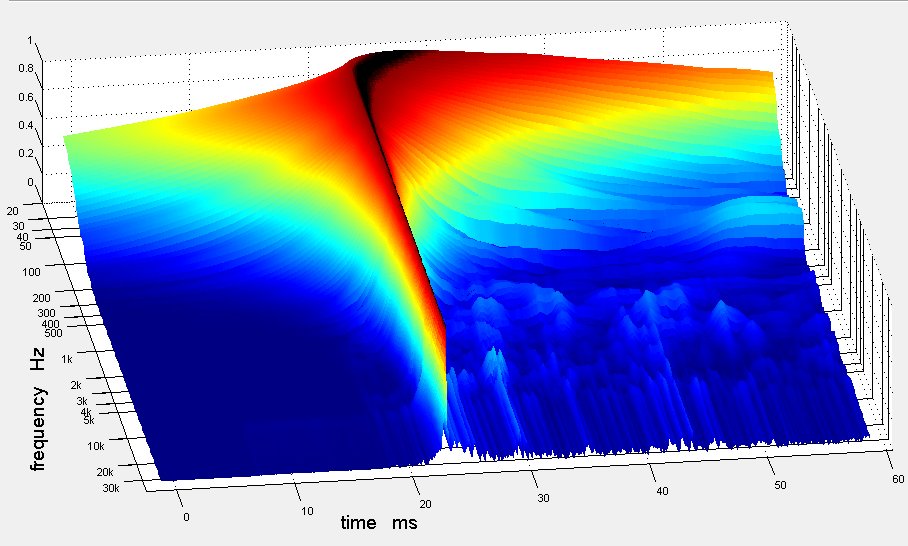

I used that program to make these two comparisons, one without and one with my correction in place. I did this just for fun as a trial measurement on the thread: https://www.diyaudio.com/community/...can-we-do-with-dsp-power-now-availabl.284916/
(the correction was made using DRC-FIR, REW, JRiver and a lot of leg-work around the room to be sure it wasn't a single point wonder)
Comparing input to output, a view of my DAC output, measured the same way (running the output of DAC to the Mic in):
And the Stereo result of my speakers at the listening spot, as measured with a real microphone:
It won't act as nice as a real nice room with lots of absorption and diffusion used, as member jim1961 demonstrated in his "Studio like" room:
(that blue ridge in the "deep blue sea of silence" is a Haas kicker, strategically placed panels that reflect/diffract back to the listening spot)
No DSP was used for this above in-room measurement. I asked Jim to run the APL_TDA demo as I was deeply impressed with the work he had done in his room. This is a Troels second order speaker pair in a heavily treated room I think his subs were off, I can't recall. As said: no DSP or EQ used. That room looks nothing like a regular living room.
You can see the work involved here: https://gearspace.com/board/studio-building-acoustics/817205-my-listening-room.html
Looking at the top two plots, I would imagine that there would be an audible difference. WIth the exception of the modal region I would imagine the response that generated the lower plot would sound deader, with more precise imaging. But that becomes a matter of degree and personal preference, and obviously I couldn't judge w/o actually listening. .Some like pin point imaging. Some like a more open, natural sound.
