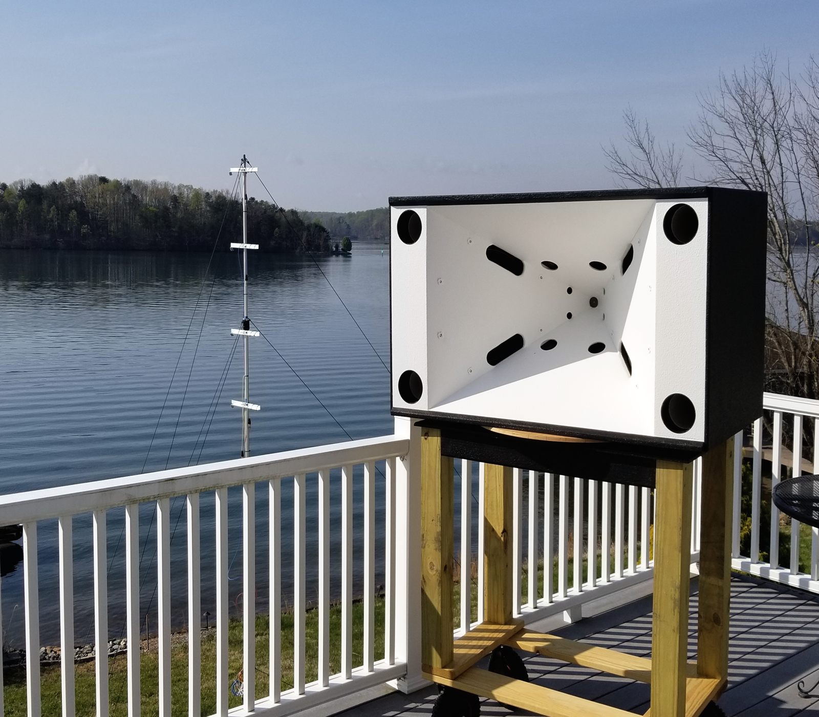

Hey guys, got no time for low hanging fruit......I'm all busy picking an orchard !!It is obvious that you are not interested but much of your reasoning seems faulty to me and my own experience suggests that you are undervaluing the gains that you could have. There is some low hanging fruit that can be exploited without going to the lengths wesayso and I have.
Here's the new orchard I have to pick
Now that it's warm enough to start testing, i've added bass-reflex ports to syn11 and put it back together.
been waiting for this since November...STOKED i am.
(Won't post any more about it on this thread...will do so on the syn11 i started a while back.)
Although, as happy as I am to get going with this project again, it does come at a cost.
My 3 ch LCR rig has dropped down to 2 ch stereo, to provide the pair of 18"s needed for syn11.
The LCR rig has been the best indoor sound I've ever achieved, maybe ever heard.
But I'm more than willing to set the LCR aside to explore a path that I think might lead to even greater potential.
This is what's fun for me, and really doesn't allow my stopping to try to milk all the potential out of a particular design.
I mean heck, my syn/sub stacks are on dollys because I try so many placements and setups. When I read books that say distances to speakers in the stereo triangle, need to be within 1/4" of each other, for good DSP correctable measurements....I'm like no thank you...tis a complete non-starter for me.

But for now, it's time to put the mics on the mast and start taking some measurements !

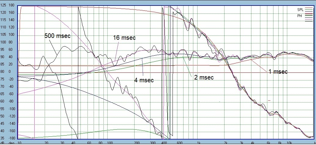

Hey, completely shifting gears and thinking about FDW.....
Pls help me see how it differs from any other form of frequency selective measurement massaging, where the goal is to get best representative measurement for correction.
Seems to me, FDW is applied post-impulse capture, and therefore doesn't effect the actual time window used to capture the impulse.
I've read FDW is needed to ensure a long enough time window to allow both direct sound and tail reflections into low frequency measurements, while keeping relections out of high freq measurements.
Unless gating were applied to the original impulse capture, how can it not already have all the low freq info, both direct and reflected?
Seems like FDW is an elegant, continuous form of frequency dependent gating, where cycles are substituted for a series of frequency dependant gate timings.
Bottom line, doesn't it ending being another form of smoothing?
It's hard to see much pragmatic difference between FDW and fractional octave smoothing for example, particularly when fractional octave can be set multiband.

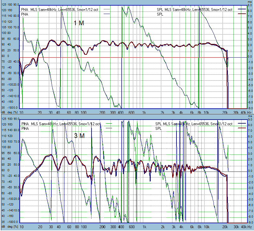

So, what wrong with building a speaker with IIR only and when FR, distortion and directivity is OK, do a final FIR correction of phase. This was the premise. (As oppose to use FIR for "everything" i.e. XO, FR and phase...)This thread was based on a faulty premise
I became curious about these frequency dependent windows and was going to try something to look at the difference between using just a long window and frequency dependent windows. Then I decided it would take too long to do it manually and I really wasn't that interested. But Just a couple of weeks ago the developer sent me a new version of my design software, 11 updates since the last version I had. Turns out he implemented frequency dependent windowing. So I figured time to compare. It took measurements at about 1 M and about 3 M. One using a 400 msec window and a second using frequency dependent windows that were from 5 msec to 400 msec. I seems he allows 8 cycles for the frequency or interest. So the frequency dependent windowing starts at about 1600 Hz and below. At 400 msec the cut off is about 20 Hz, below that the 400 msec window is held constant. Below are the results. Top 1 M., bottom 3 M. Blue SPL and green phase = 400 msec window, Red SPL and blue phase = frequency dependent result. Other than some what I would call insignificant difference in the 800 to 1600 region of the 3 M result, which would pretty much disappear if stronger smoothing were used, there's not much going on here, IMO. Certainly not much in the modal region where frequency dependent windowing appears to do pretty much nothing.
NothingSo, what wrong with building a speaker with IIR only and when FR, distortion and directivity is OK, do a final FIR correction of phase.
Not it was not, the premise was that you couldn't because a global FIR inherently introduced significant pre-ringing, which is not true.This was the premise. (As oppose to use FIR for "everything" i.e. XO, FR and phase...)
Indeed when you apply a basic frequency dependent window with settings that don't introduce a real difference you don't see a difference. Holm impulse has a basic FDW routine, so does REW. They can introduce a difference much greater than what you show but nowhere near as well as being able to change the number of cycles with frequency as adding an exponent or other method does. When the only tool you have is a hammer everything looks like a nail.Certainly not much in the modal region where frequency dependent windowing appears to do pretty much nothing.
- Why not IIR filters + a global phase linearization by FIR
