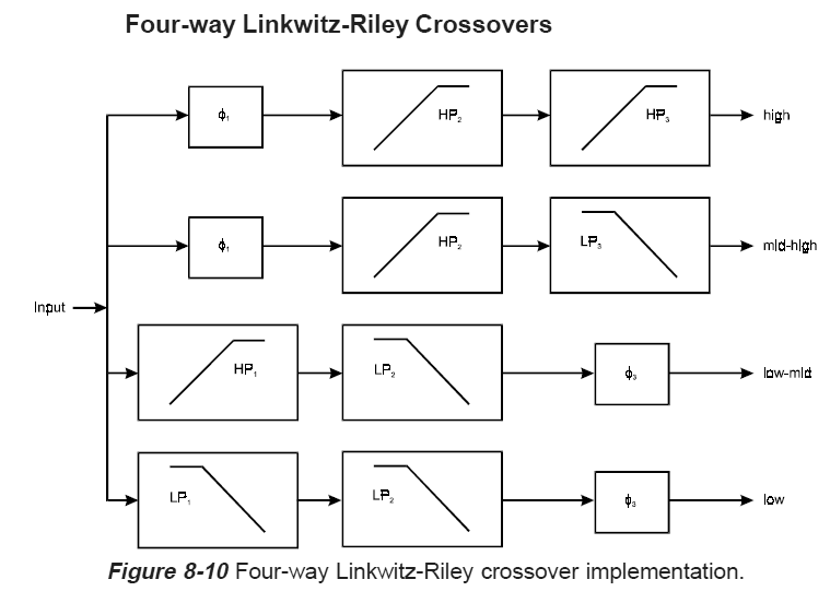

Interesting, so your cascade is for a 4th order complimentary?
I always use a LR2 on HF, mid, and midbass LP (polarity flip on mid)
Then a LR4 on sub LP and midbass HP
Then that midbas LR4 as a cascade on mid and HF
Yours is a little different…… interesting

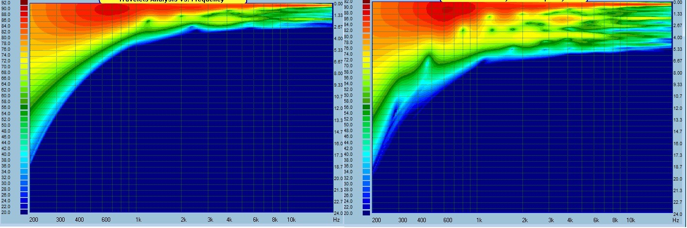

I think I misspoke here when I said "deader". more accurate description would probably to say it pushes the system more towards anechoic sounding. And it still depends on how the impulse response is processed. For example, looking at these wavelet plots which would sound better?
I think we would all be temped to say the left plot looks better but in reality this is the same speaker measured at the same position with no changes. In fact, both plots were generated from the same impulse. The only difference is how the impulse was windowed.

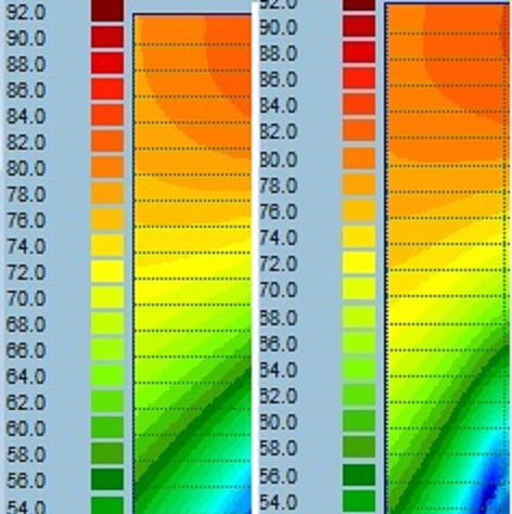

I can assure you that the two top plots I posted both used the exact same settings, they were taken just minutes apart 😉. Even the other ones were done with the exact same settings.I think we would all be temped to say the left plot looks better but in reality this is the same speaker measured at the same position with no changes. In fact, both plots were generated from the same impulse. The only difference is how the impulse was windowed.
Those plots are normalised and fixed, so I couldn't have played with the top SPL level like you just did, 92 on the left graph and 82 on the right 😀.
The APL_TDA software I used presents the wavelet in a "standard" non controllable way.
The thing to notice in your plot are the parallel lines beside the arrival of direct sound. Reflections?
I'm curious about the time scale on the right...
Wasn't implying that they weren't the same. But check the levels. they both go from from 92 to 20. 😱I can assure you that the two top plots I posted both used the exact same settings, they were taken just minutes apart 😉. Even the other ones were done with the exact same settings.
Yes, Windowing... duh... The windowing cuts off the rest of the stuff, should have read a little better 🙂.
But that's not what we were on about, was it? We do use a form of windowing to get the information we want to use, but we don't use windowing to make our plots look better 😀.

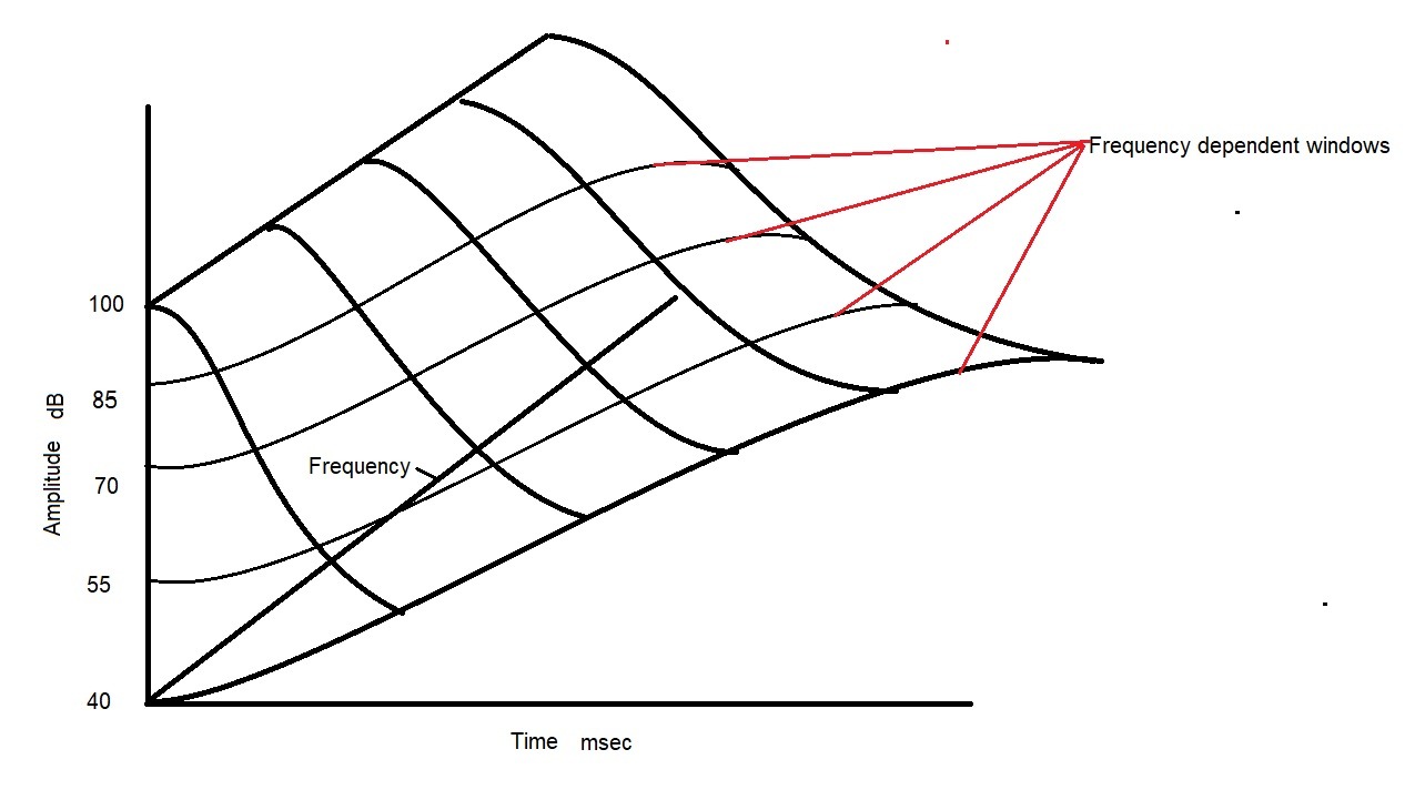

Hi John K..., seeing this post reminded me of things I've seen in the ARTA manual. Do you use ARTA?I was thinking about these FDWs and trying to get a better understanding of what they represent. I don't know if this has been discussed before, so here are my thoughts. I thought of RT60 and CSD plots (water falls) and how the decay time vary with frequency, . Typically the higher the frequency the shorter the decay time is. You can generate a 3-D plot (CDS) of the decay of a signal, Amplitude vs time as a function of frequency, as pictured crudely below. High frequency to low, front to back. Then if you cut a horizontal plane through that curve at a given amplitude you get a time vs frequency for the the signal to decay to that level. In a sense, would not each of these horizontal curves represents a FDW where you would be windowing out any contribution to the impulse where the level of the contribution at that frequency dropped below a certain dB level? Thus, in essence, using a FDW seems like imposing a decay curve for the room. So, when you choose a FDW for a measurement, the resulting response is perhaps similar to that of an un-windowed response of a room with a similar decay vs frequency, at the measurement position.
It has a very good chapter on impulse analysis, and goes on about the differences in Burst decay, CSD, FDW ,and windowing techniques in general.
And how they change measurements. I realize how much of it i still don't understand, so I'm going to hit the books a little....

I had ARTA, HOLMImpulse, but pretty much I use Sound Easy and the good, old IMP. All these things like CSD, Wavelet, Spectograms, burst response, are nice to look at but ultimately they are all just impulse processing. Soundeasy can generate them all but the graphfics are as sufisticated as some of the other software. What I have been trying to do is to look at a response generated with FDWs and then develope minimum phase EQ and then phase correcting to make the FDW response flat with linear phase,. Then apply that to the actual speakers in room response (single long FFt window) and compare the impulse for the 3 configurations. I've run into some software limitations but a crude approximation to doing that yields something like this.Hi John K..., seeing this post reminded me of things I've seen in the ARTA manual. Do you use ARTA?

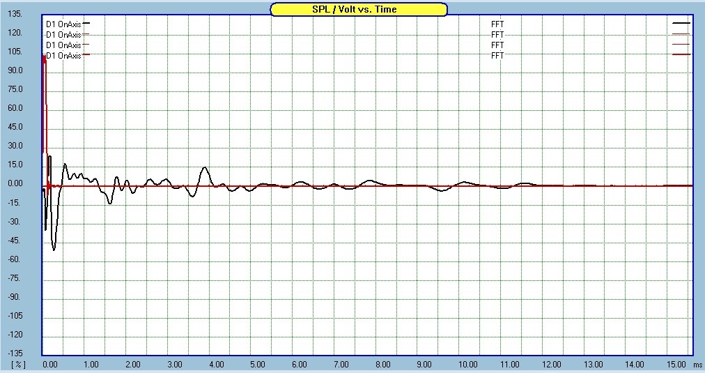

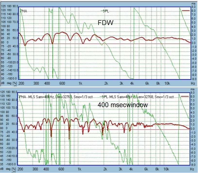

Applying the eq and phase correction to the FDW response results in this. Black is the raw (approximate) FDW response impulse, Red is after EQ and phase correction, i.e. perfectly flat, linear phase. (I say approcimate FDW because while I can generate an FDW response I can't seem to export it into a driver file. So I did a cut and paste using different window lengths for different frequency ranges, 200-400, 400-800, 800-1600, etc.)
Applying the same EQ and phase correction to the "real" speaker response yields this. The added blue curve is the intermediate of just applying the minimum phase EQ. Note that up to about 4msecthe real and FDW responses are pretty much the same because the minimum window length in the FDW case was 4 msec.
Anyway, weather is going to be in the 70s and 80s this week so I'm getting off the couch and getting out side and play with my 🚗 🚕. 🙂
Just use the FDW function of the free DRC_FIR tool👍.
You can export the windows it generates to file for use in more familiar tools.
1) I thought that is for generating the fir filters. I have no problem there. SoundEasy does that if I want to,and applies them. But I'm just doing simulations. I just can't save the starting point FDW frequency of the speaker.
Here is the FDW response with the "real" room response below. I wanted to EQ and phase correct the FDW and apply those corrections to the "real" response and look at the impulse. Since I can save the FDW I generated an approximation and used that for the FDW.
- Why not IIR filters + a global phase linearization by FIR
