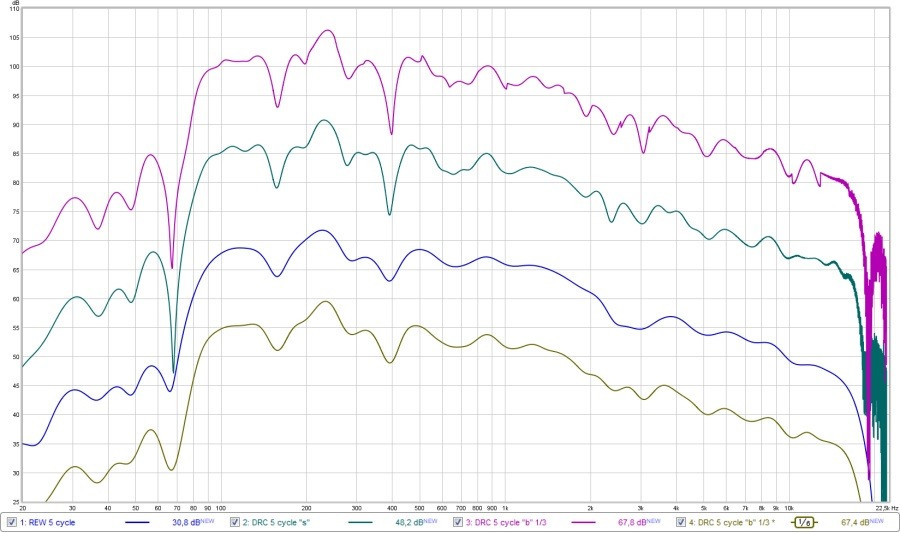

Yes, DRC-FIR can be used to generate FIR filters, but it can also produce wav files of the frequency dependent windows it uses internally. In fact, it's a very open app and you can change every step of the way. But it's strength may well be how it produces the frequency dependent windows.
Here's an old example where I compared the FDW from REW with the one produced by DRC-FIR, based on the same number of cycles:
They all are representing a 5 cycle window.
The top one is DRC-FIR with a 5 cycle window using MPPrefilterType = "b" which is explained in the quote below.
2nd one from top is DRC with a 5 cycle window using MPPrefilterType = "s"
3rd one is what REW produces if one uses a 5 cycle window. I'd agree with Mark that that one looks smoothed 😉
4th one is the top DRC-FIR result with a 3rd octave smoothing filter put on top of it, to show how big of a difference there is between a frequency dependent window generated by the dedicated tool DRC-FIR and it's more casual implementation in REW. Even the 1/3 rd octave smoothed DRC window is more detailed than using the same number of cycles within REW. Which can come in handy but the end user should be aware of these differences.
Not all frequency dependent windows are created alike!

Hi Ron, which of those would you choose to base corrections off of?
Just to convey mindsets, if those were made outdoor quasi-anechoic, I'd use one of the two bottom ones simply because i think the upper two have regions with Q's too high to correct.
Ime, correcting any high Q region is likely not to hold well up off axis. And if that's the case outdoors, how can it not be magnified further indoors?
I'd choose the second from the top window, the "s" version, and just set the appropriate dip limiting tools to my liking 😉.
A less detailed view wouldn't make sense if you want to use the shortest number of cycles.
But there's enough settings that can avoid boosting nulls and ignore any dip with high Q.
Like i said earlier, it is a tool. it's effectiveness depends on how you use it. Using the second from the top and dip limiting would avoid boosting the dips you are worried about. Dips that still are present in the smoother curves. But that's just my take. With a program like this, you get to choose what you want it to do.
