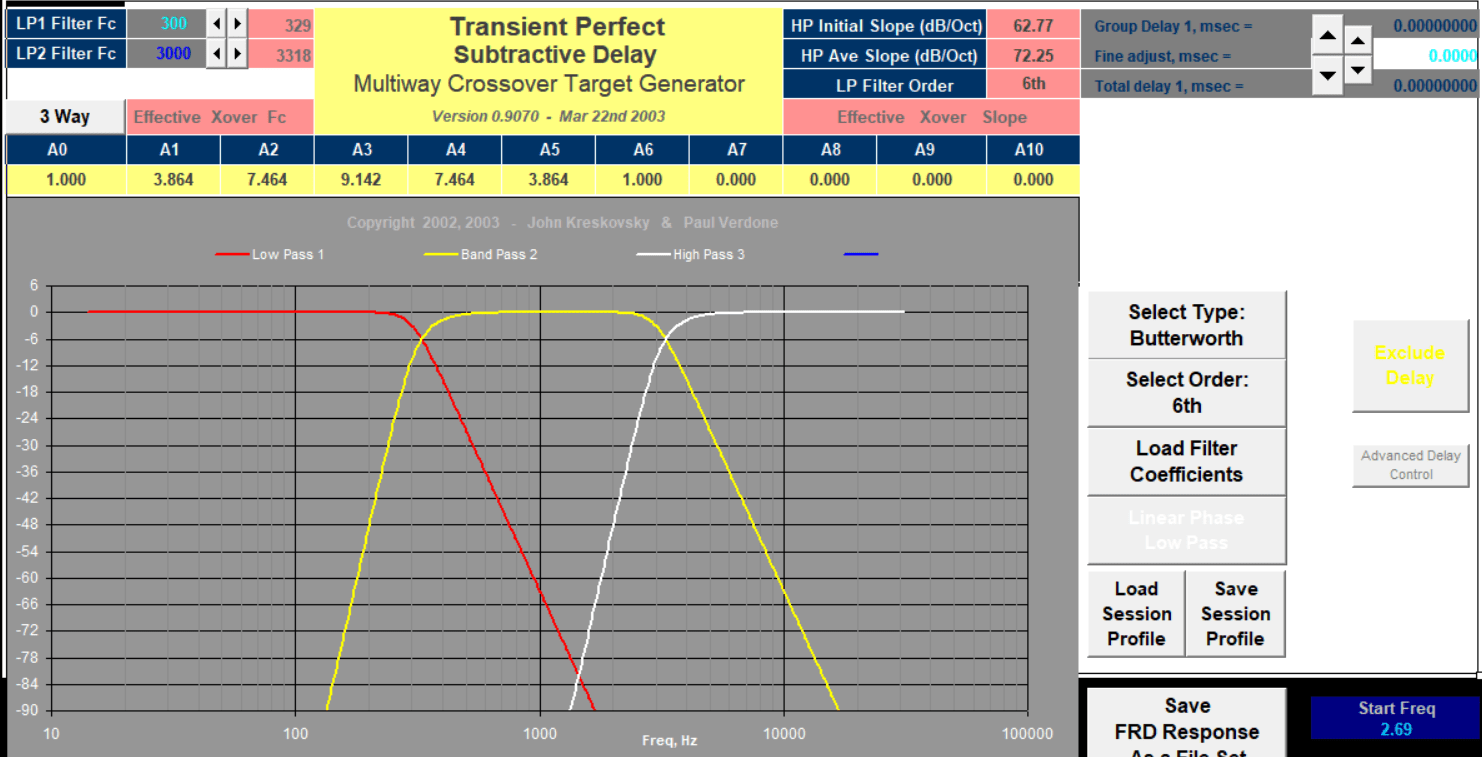

Years ago I had developed a spread sheet for 2-way subtractive delay crossover. It allowed yuo to choose the crossover point, low pass filter type and order, and whether the LP filter was linear or minimum phase. Later, Paul V of the old FRC took it s a step further and made it more general, allowing up to a 4-way crossover. It seems to have some glitches in it but is still functional. It includes Butter worth filters and show what I found that when using a linear phase, Butterworth LP section the subtractive HP section roll off at a slope twice that of the LP section. Here is a screen shot of the crossover section for a 3-wy using 6th order Butterworth amplitude LP sections with linear phase. Attached is the spread sheet. Don't know how well it will work with newer Excel, but fun to play with if it works.
Almost all of those old FRC Excel based programs work fine with newer versions of Excel, but only if you install the 32 bit version of Office instead of the 64 bit version. On my Win 11 machine I have both Excel 2010 (32 bit) and Excel 2021 (64 bit) although MS doesn't support multiple Office versions. A perhaps cleaner and safer way (which I used in the past) is to create a virtual machine (I used good old Windows 7) to run the 32 bit version of Office. What ever works for you.
I did find a slightly newer version of the app on the old FRC website via the way back machine (LINK). The TPSD (Transient Perfect Subtractive Delay) file, tpsd1.10.exe, is a self-extracting executable that contains TPSDMulti-.9071.xls, a user manual and fftdll.dll. The DLL speeds up the FFT process, but probably isn't needed on today's machines.

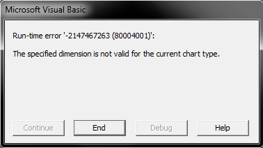

I'm on Office Enterprise 2007, got the following upon opening the spreadsheet, dismissed it (End). But most buttons worked and I was able to see some graphs as expected. Thanks.

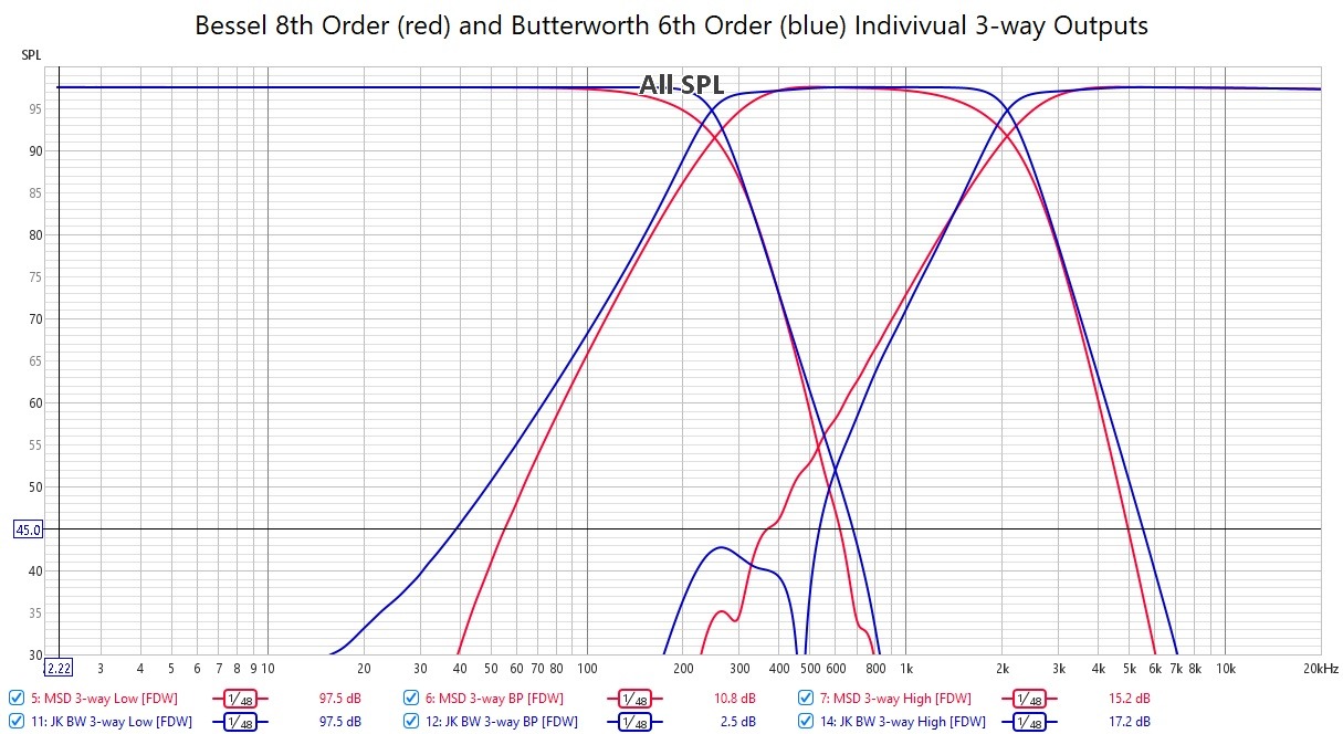

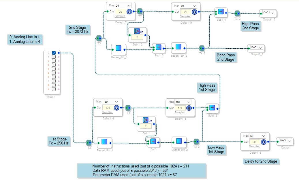

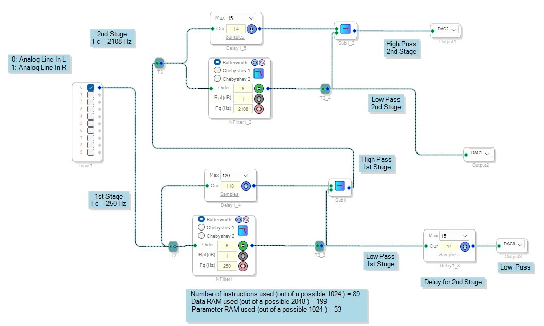

I’ve been interested how subtractive delay filters would use the meager ADAU1701 DSP resources and how they would perform in an inexpensive 1701 DSP board. So, I designed two, single-channel, three-way subtractive crossovers: Gregory Berchin’s simplified 8th order Bessel and John Kreskovsky’s 6th order Butterworth. Each of the three crossover outputs were measured and then added together to check for their summed frequency and phase responses.
Both crossovers have nearly identical crossover frequencies of ~250 and ~2100 Hz. The first two attachments are the SigmaStudio crossover schematics with the compiler resource usage statistics added as comments. The third attachment shows the individual measured outputs of both filters. The filters’ responses track quite well up to ~50 dB below the fundamental, but below that level the high pass filters’ responses begin to lose track. The fourth and fifth attachments show the filters’ frequency and phase responses when the individual outputs are summed together. Linear phase!

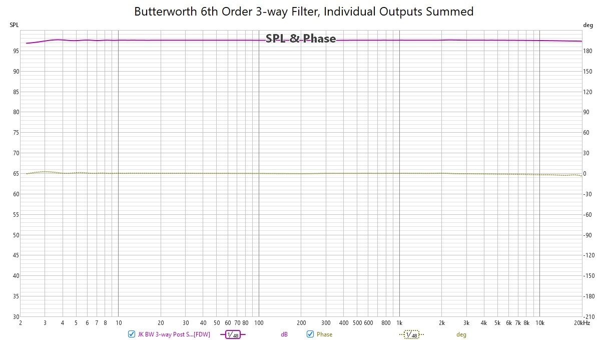

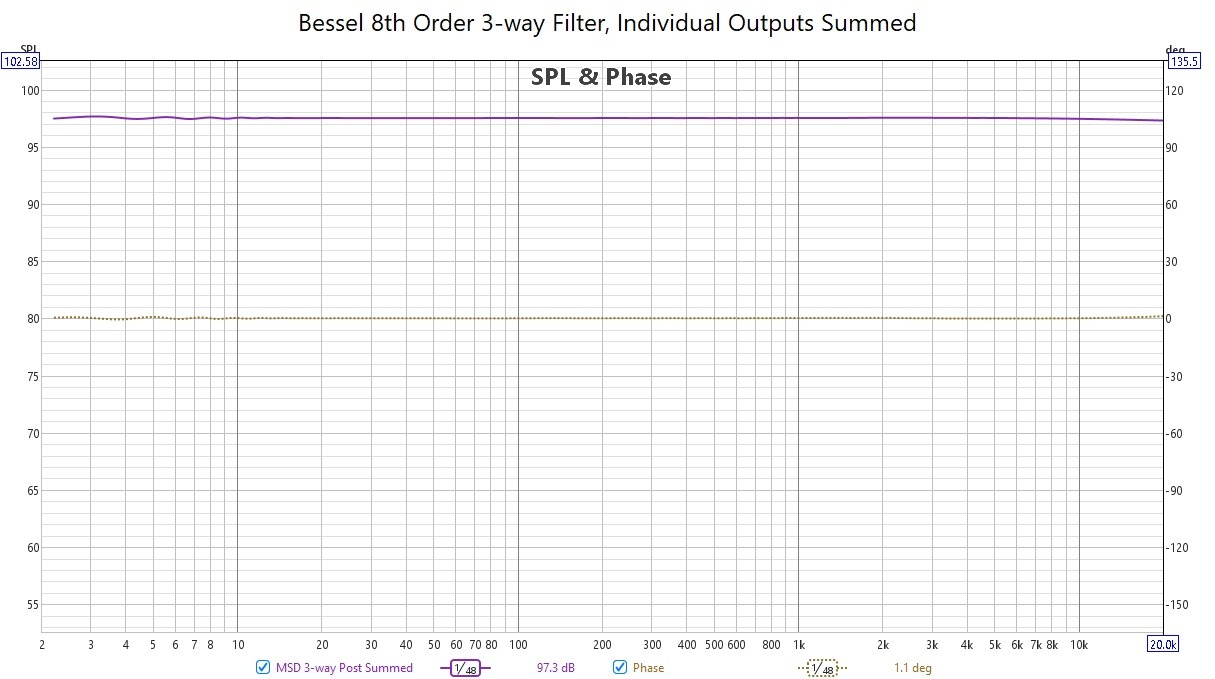

Overall, I’m quite impressed with the performance of both filters. They offer a way to achieve linear phase filters for users of the ubiquitous 1701 DSP. Special thanks to Gregory and John for their work on these filters. It’s been 20+ years since their initial development, but better late than never!
Details, details……
Details, details……
- I created a zip file containing both SigmaStudio projects which can be downloaded HERE.
- I used THIS TinySine DSP board with Fs set to 48 KHz. I used REW for measuring, also at 48 KHz. The DSP board’s native frequency response rolled off at the upper and lower ranges which affected the phase. I converted the native response into a “microphone” calibration formatted file which resulted in a totally flat frequency and phase response using a “straight through” (input directly to DAC) project.
- Don’t use the SigmaStudio “Fractional Delay” as it causes phase shift in the higher frequencies. See these links for details (LINK1, LINK2). Use the standard delay which delays integer multiples of 1/Fs.
- The SigmaStudio “Simulation Probe” doesn’t correctly display the filter’s phase. The magnitude is displayed correctly though.
- The 1701 DACs output in negative polarity. See the 1701 datasheet for details.
- I used SigmaStudio’s “Nth Order” filter for the Butterworth filter and John’s Excel worksheet for the Butterworth delay times. I used SigmaStudio’s “Parametric EQ” and selected four “General Low Pass” filters for the 8th order Bessel filter. Their Q values and frequencies along with their delay values were calculated from posts in this thread.

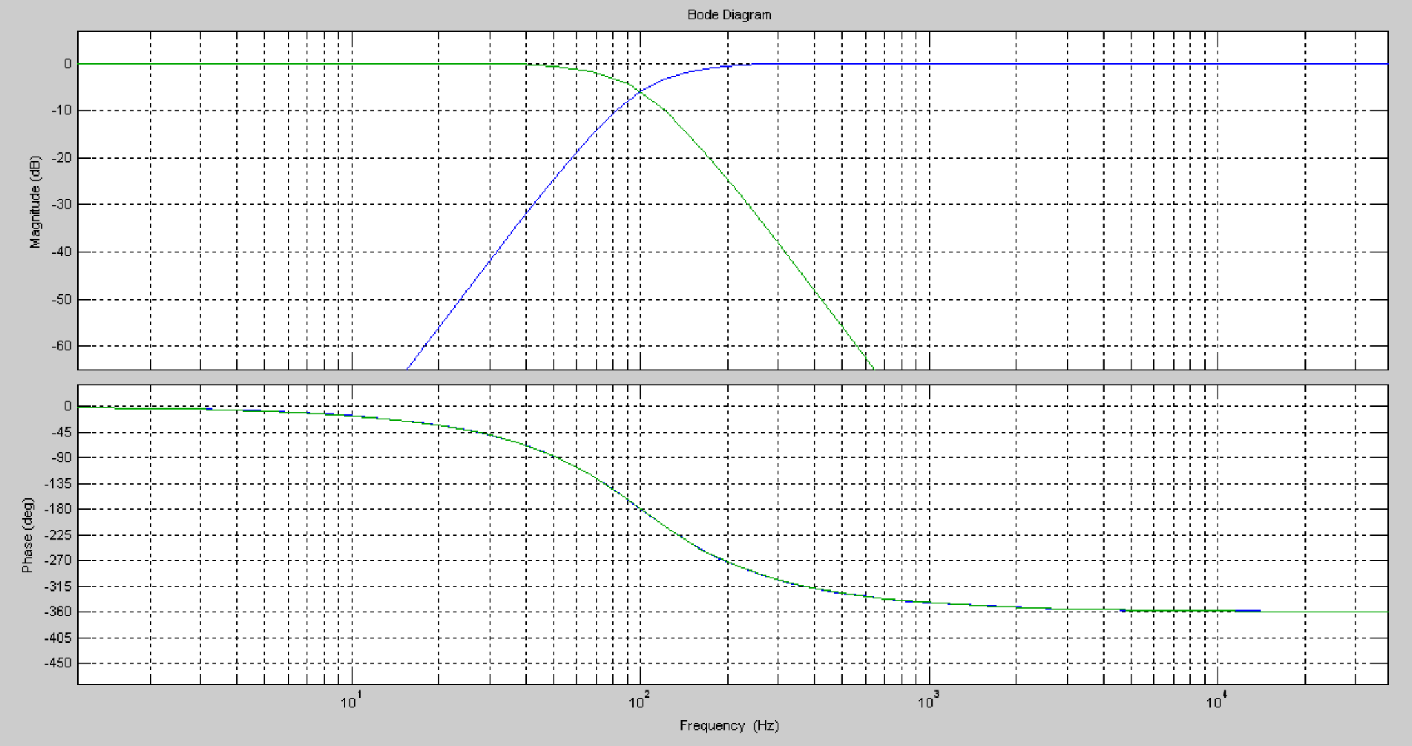

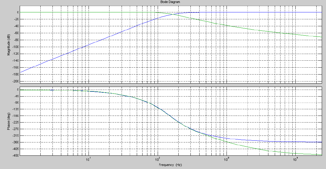

You could get rid of the hump quite easily, keep reading.There is a hump in the derived output, that's why it should be better to define the HPF and derive the LP because the woofer should handle the peak more comfortably.
It is easily realisable, just replace the "delay" with an all-pass filter of the same phase as the highpass filter.So my first idea was to define the HPF, add a time adjustment to the input and subtract to produce the LP, just the dual of the standard version.
The time adjustment would be the group delay of the HPF, just as in the the canonical version it's the delay of the LPF.
But the group delay of the HPF is not a "delay", and decreases towards zero, so I'm not sure it's realizable.
Yes, please see below ... It's LR4 not Bessel, but Bessel must be similar, except for that the symmetry won't be there.My question was whether anyone had done a subtractive delay crossover with a defined HPF and the LP derived from that, as described above. The dual of Lipshitz & Vanderkooy, similar to Berchin's but continuous time.
If you follow MATLAB or Octave, here is the code. Hope that helps.

bode(hp_sys,ap_sys-hp_sys,options);
This is Bessel, see code for details..
Code:
%LOWPASS
freq1 = 141.92;
Q1 = 0.5219;
wc = 2*pi*freq1;
bq1 = tf([wc*wc],[1, wc/Q1, wc*wc]); % analogue lowpass transfer function
freq2 = 159.12;
Q2 = 0.8055;
wc = 2*pi*freq2;
bq2 = tf([wc*wc],[1, wc/Q2, wc*wc]); % analogue lowpass transfer function
lpf = bq1*bq2; % Bessel LPF
%HIGHPASS
freq1 = 141.92;
Q1 = 0.5219;
wc = 2*pi*freq1;
bq1 = tf([1,0,0],[1, wc/Q1, wc*wc]); % analogue lowpass transfer function
freq2 = 159.12;
Q2 = 0.8055;
wc = 2*pi*freq2;
bq2 = tf([1,0,0],[1, wc/Q2, wc*wc]); % analogue lowpass transfer function
hpf = bq1*bq2; % Bessel HPF
%ALLPASS
freq = sqrt(freq1*freq2);
Q = sqrt(Q1*Q2);
wc = 2*pi*freq;
apf = tf([1, -wc/Q, wc*wc],[1, wc/Q, wc*wc]); % analogue allpass transfer function
% DISPLAY
options = bodeoptions; % bode plot
options.FreqUnits = 'Hz';
options.XLim = [1,20000];
options.YLim = [-450,20];
options.grid = 'On';
options.Freqscale ='Log';
%options.MagVisible = 'Off';
options.PhaseWrapping = 'Off';
options.PhaseMatching = 'On';
figure(1)
bode(hpf,apf-hpf,options); % LPF obtained by subtraction
