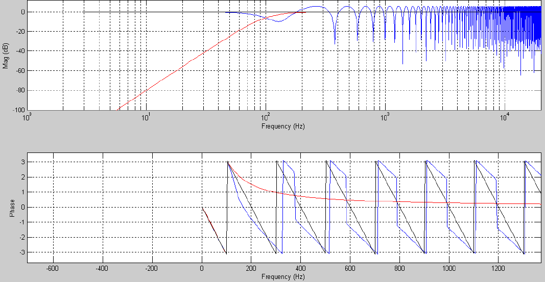

If you follow MATLAB or Octave, here is the code. Hope that helps.
Code:
% LOWPASS
freq = 100;
Q = 0.7071;
wc = 2*pi*freq;                                                                        % Cutoff frequency
but_sys = tf([wc*wc],[1, wc/Q, wc*wc]);                                    % analogue lowpass transfer function
lp_sys = but_sys*but_sys;                                                          % BUT2 to LR4
%HIGHPASS
freq = 100;
Q = 0.7071;
but_sys = tf([1,0,0],[1, wc/Q, wc*wc]);                                        % analogue lowpass transfer function
hp_sys = but_sys*but_sys;                                                          % BUT2 to LR4
%ALLPASS (half-order, same Q)
freq = 100;
Q = 0.7071;
ap_sys = tf([1, -wc/Q, wc*wc],[1, wc/Q, wc*wc]);                          % analogue allpass transfer function
% BODE PLOT DISPLAY
options = bodeoptions;
options.FreqUnits = 'Hz';
options.XLim = [1,20000];
options.YLim = [-360, 0];
options.grid = 'On';
options.Freqscale ='Log';
%options.MagVisible = 'Off';
options.PhaseWrapping = 'Off';
options.PhaseMatching = 'On';
figure(1)
bode(hp_sys,ap_sys-hp_sys,options);
I am not very familiar with MATLAB or Octave, but I don't see that this is the maths for a subtractive crossover, either simple or with delay.
Happy to learn more if I am mistaken.
Best wishes
David.

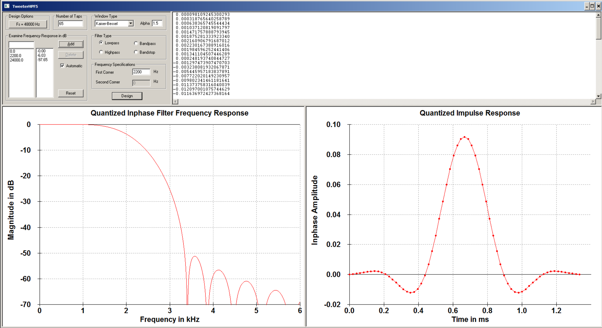

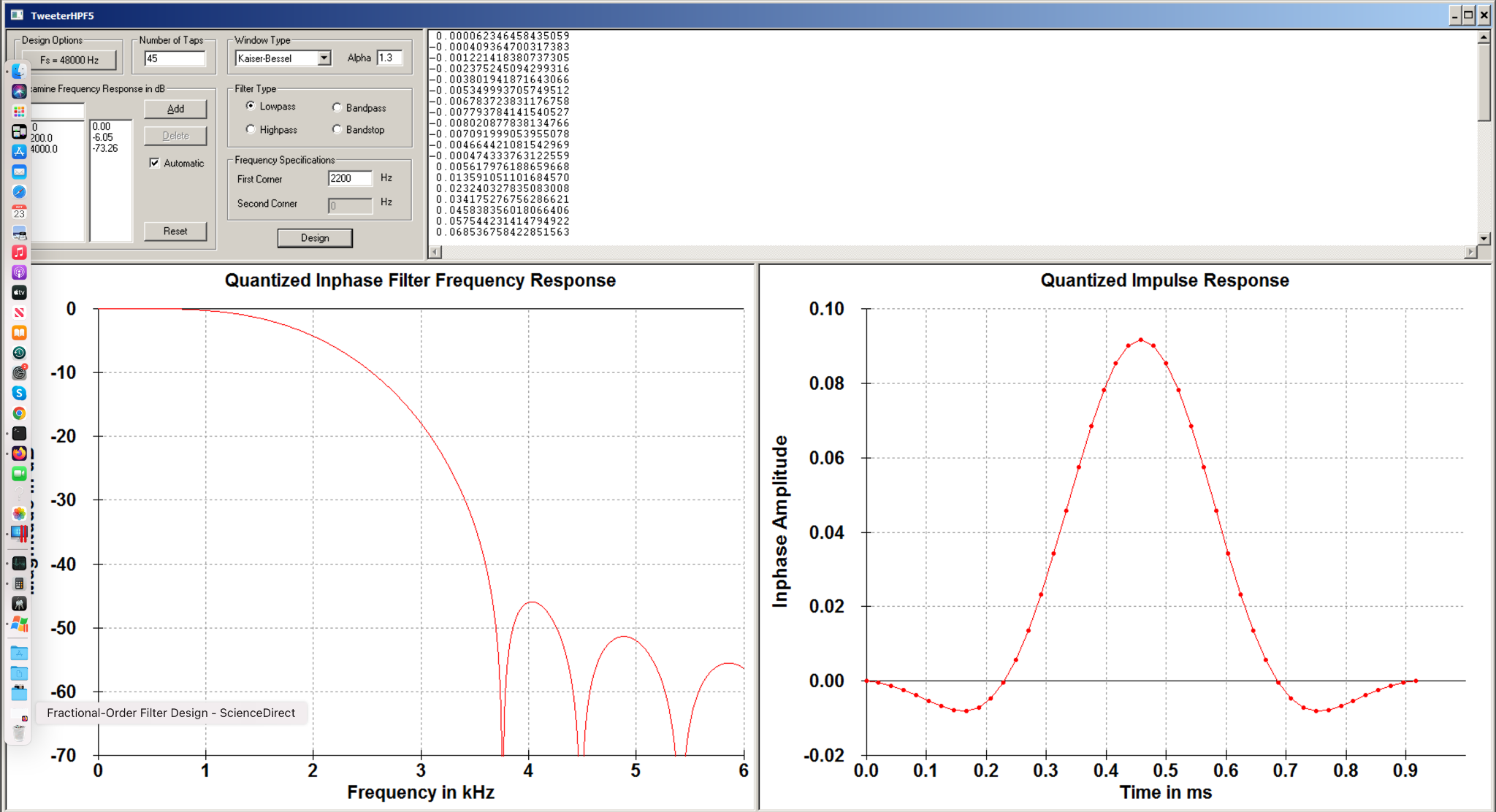

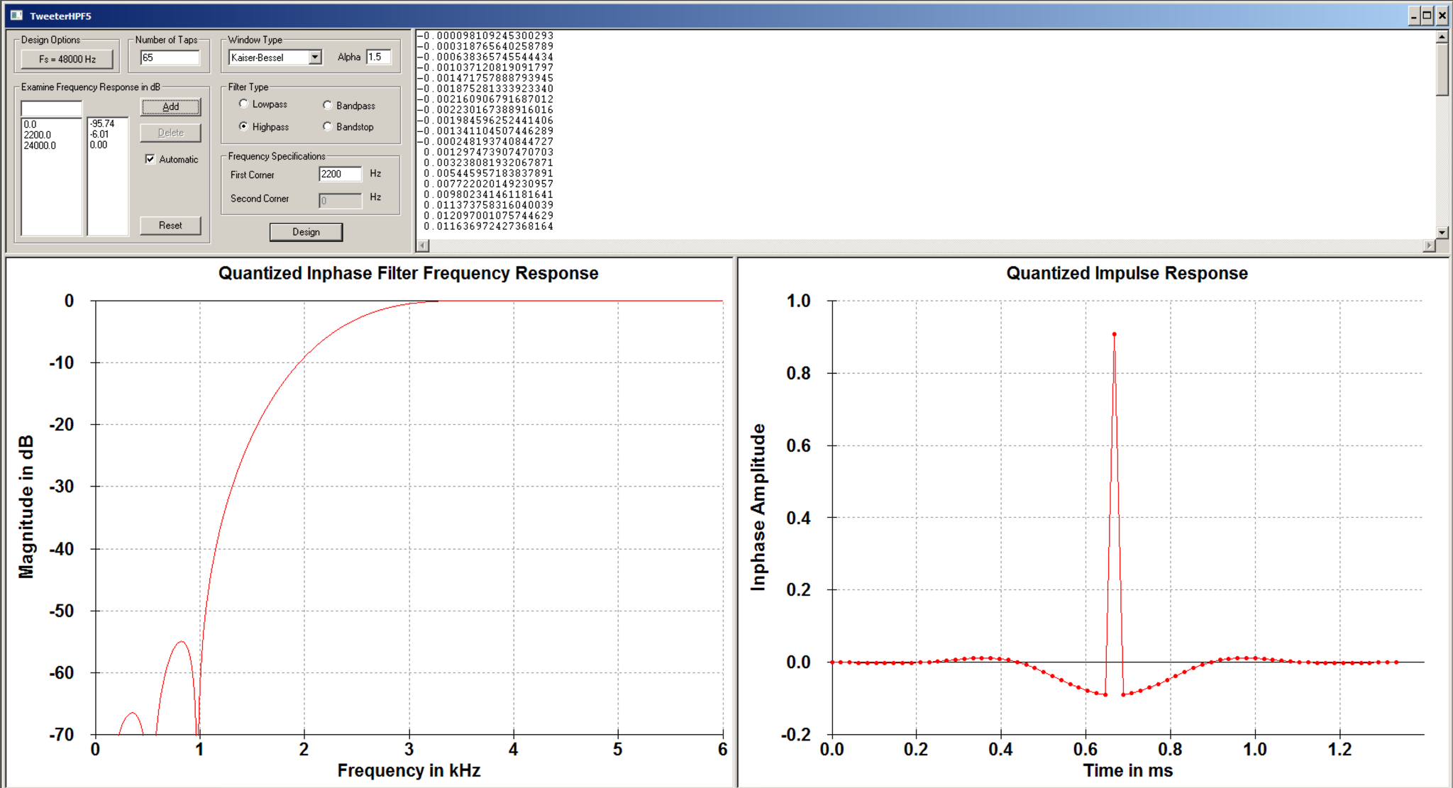

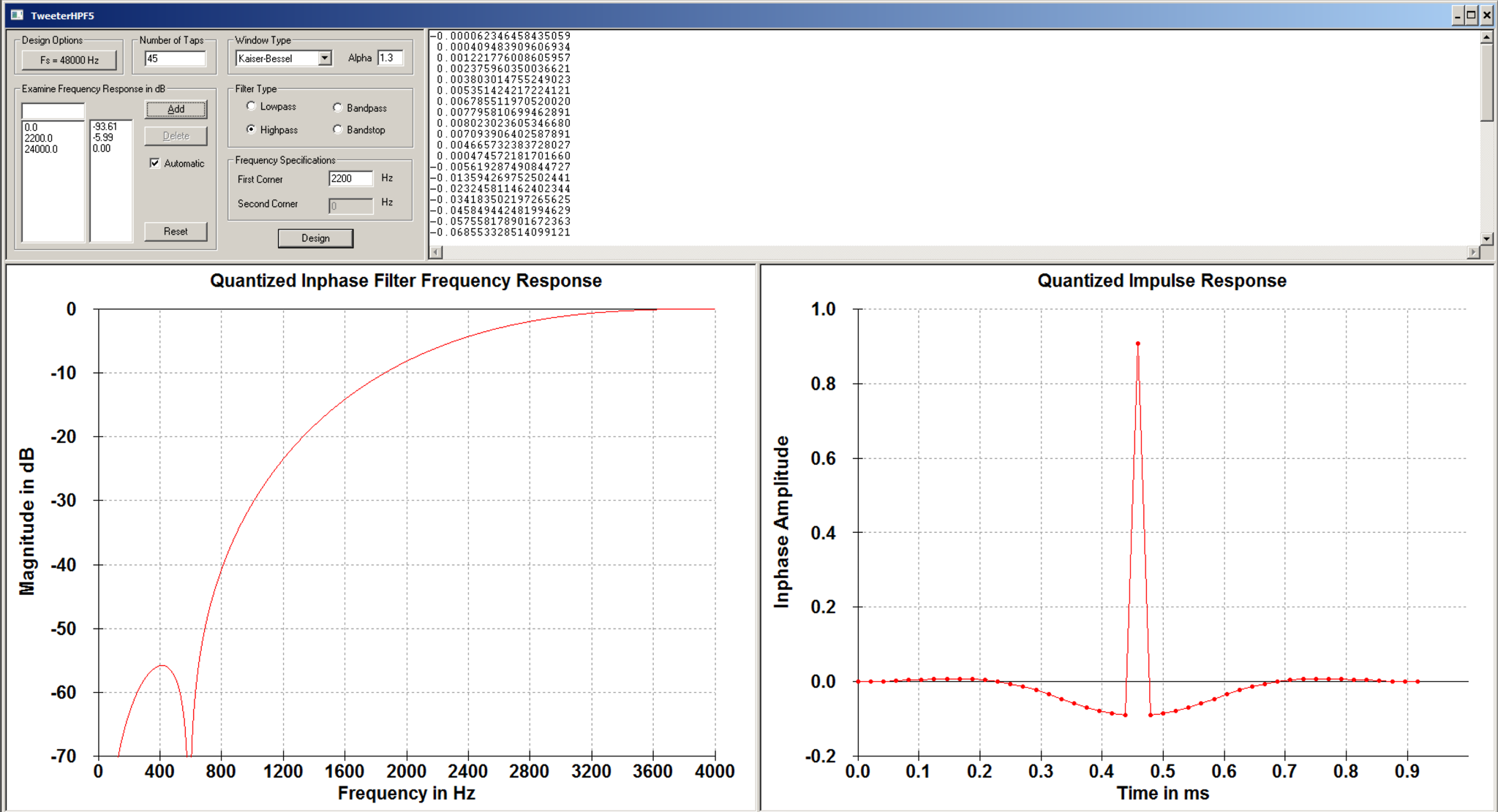

Now here are the filters I like to use. The first pair are tweeter highpass and mid lowpass at 2200 Hz with gentle slopes. Note there is only one sidelobe on either side of the central lobe, which is about as small as a usable filter can get. The second pair have two sidelobes on either side of the center. The second filter pair has slightly higher sidelobe energy, although still considerably lower than the main lobe energy. In any case the lowpass and highpass filters sum to a single peak in the time domain, as one would expect for a system flat in amplitude and phase response. Either set is fine for crossovers, although the second pair has considerably less out of band energy to the drivers, which might be important for tweeters and mid drivers with resonances out there.
.. I don't see that this is the maths for a subtractive crossover.... with delay...
Why not? The last line obtains the LPF by subtraction of the HPF from the APF (with same GD as the HPF).
bode(hp_sys, ap_sys - hp_sys, options);
As far as I understand, the allpass is the best delay line you can implement in the s-domain. Please see link for the scope of a pure delay.
https://lpsa.swarthmore.edu/BackGround/TimeDelay/TimeDelay.html
And welcome to z-domain !!

They sounded horrible! Music with any high frequency content such as cymbals or high-hats was like having a hatpin scraping away at my eardrum. I asked the chief to let me widen the transition bands, and while the problem didn't entirely go away at least I didn't feel like throwing my Sennheiser 580s against the wall.
Something sounds amiss. Given sufficient taps, and truly complementary xovers, my experience is virtually any order lin phase xover can be used without audible effect. It appears the xovers shown are lin-phase??

Remember the aforementioned horrid filters were lowpass filters with lots of ringing, not crossovers. The crossover filters shown in the pictures are much shorter, which helps considerably with off-axis response when driver radiation tends to fall out of phase alignment so sidelobes would not cancel completely. Under those conditions ringing could make an appearance, hence my preference for shorter impulse responses as crossovers. Note the example rolloff characteristics are not a million dB/octave: the gentle slope is about the same as a 4th order Linkwitz-Riley, and the steeper one is closer to 6th or 7th order. Why not use standard filters if the attenuation is attainable by those? The answer is linear phase: I prefer unrotated phase response until slightly over 2 kHz or so. The literature says phase can be detected below about 1350 Hz or so, undetectable beyond 1500 Hz, but I like to err on the side of caution.
Yes, I know that having shorter filters with lower orders helps to reduce the potential for off-axis sidelobe summations not canceling completely.
Good strategy I think.
An alternative I've come to like, is to go ahead and use longer filters with higher orders, being willing to accept pre-ring potential in exchange for limiting the width of acoustic lobing regions.
I figure not only does the potential for pre-ring decrease due to being confined to narrower critical crossover regions,
but also ordinary acoustic lobing decreases due to keeping more of the full critical crossover region within tight c2c spacing.
So a double win for steep complementary linear-phase xovers, albeit at the expense of perhaps audible, perhaps not, pre-ring potential.
