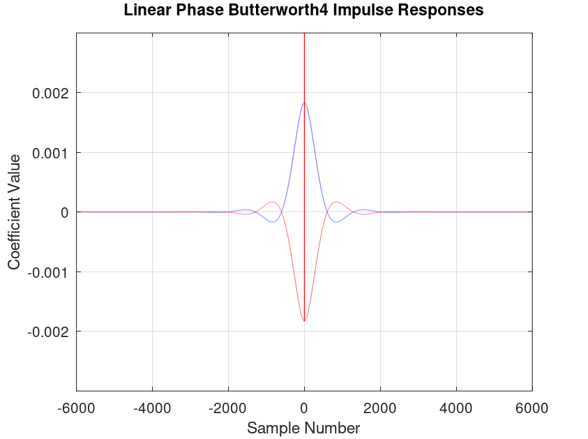

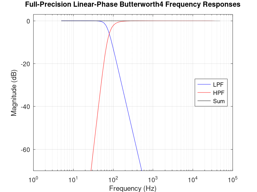

@newvirus2008 , attached are some plots that I'm preparing for my updated MDS Tutorial paper. It works.

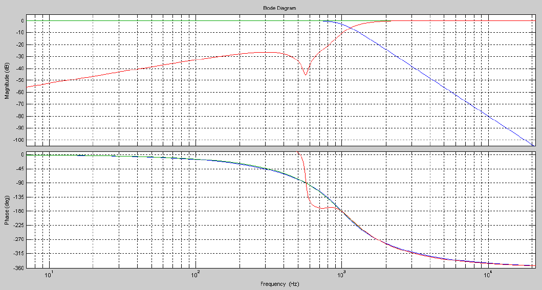

That's probably with the true delay... To mimic the JohnK crossover, one needs to match an APF2 phase/delay with that of the LPF4. The closest APF2 I can find is one with Q = sqrt( Q1*Q2 ) where Q1,Q2 are as above and result looks like below. And, even if someone finds out a better filter, there needs to be an explanation for the 8th order slope accompanying a 4th order phase/delay. Thus this method probably is only for the FIR people.

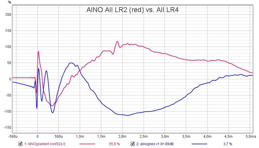

virus, please could you open this a little? Arrival time difference in step response (FFT) is another way to tell xo type and frequency, if I understand correctly. Xo type eg. LR2 VS. LR4 rotate phase 180 or 360deg and have difference in arrival time of peaks and polarities
Arrival difference at low freq is longer, is this the reason why low freq phase shift is esier to hear (from single speaker)
Stereophonic listening is very sensitive to polarities, both speakers must have same polarity and same type of xo if they are multiway. As well center speaker of HT should match L/R speakers.
