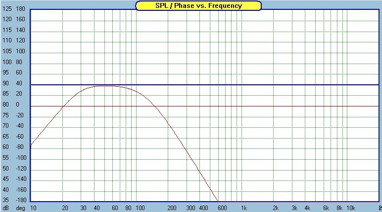

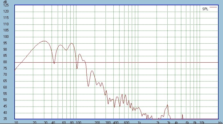

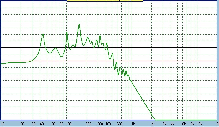

Ok, take it or leave it. I did this this afternoon in about 30 minutes one I got all the stuff set up. All measurements were taken at the same position.
1) I measured the response of my systems woofer at the listeng position. Pretty nasty.
2) I defined a target, B3, 30 Hz HP, LR4, 125 Hz, LP.
3) I generated the minimum phase EQ.
4) I started the play back of the Eqed woofer and measured it (had to use my old measurement system since the other PC was doing the filter processing). Not perfect, but 15 minutes work. And I could easily take this and generate a 2nd correction filter to improve the result.
Now, if you want to mess withthe phase it's a separate issue.
