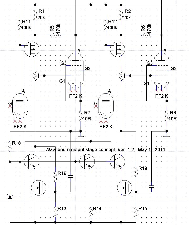

Like that your amp will not smoke for shure 😉"Cheating" 😀

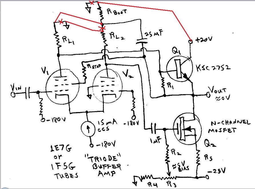

the "Cheating" "Triode" Buffer Amp
still could use a DC bias servo loop, to keep the output at 0V (at least a bias adjust pot on V2 grid 1)
The BJT never conducts.
And why not two mosfets ?

Woops! U R so right Mona!
Guess I wrote that down a little quickly.
The bipolar, at Q1, was used due to its constant current gain Beta and near constant 0.6V drop, not introducing any significant I or V distortion into the driving triode output. (so preservation of the "triode" characteristic). However, a Mosfet at Q1 would reduce the loading on V1 for lower tube distortion. (but this IS supposed to sound like a tube!)
The Mosfet at Q2 is only providing a complementary current source to Q1, so not as important V distortion wise. But the amp could be worked out with Mosfets or Bipolars in either position, due to the N feedback to the V1 screen.
This is emulating the near "perfect" 1E7G (or 1F5G) "triode" curves. 6080 and other regulator tubes are not so perfect. (too much roll-over in the plate curves) I'm still trying to figure out something comparable to "Crazy Drive" for fixing up triodes too, but have only found complicated, pointless (like Schade around a cascode) (or unlikely) schemes so far.

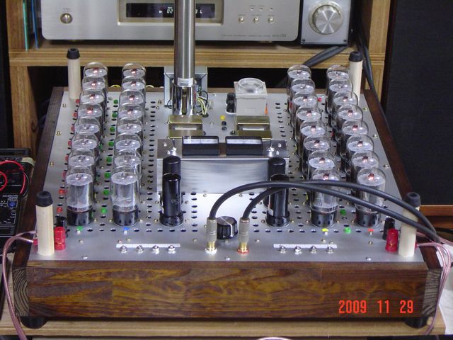

The big problem, I think, is the number of sockets, and the individual tube biasing or tube matching. Still, 22 tubes would look impressive. Eh, maybe use 50!! Like this one (OTL):

The amp sounds absolutely beautiful ! It would be good to see more of your amp testing posted on youtube .
What is that piece of organ called , and by whom ?
Adagio dAlbinoni, Gari Karr. Amati contrabass, 1610. It is 2'stage pentode amp, with local feedback around output tubs, class A2. That's why linearity and output impedance better than triode, and power is higher than in case of wasteful arrogant triode connection. I.e. high-tech usage of vintage tubes. SMPS for filaments

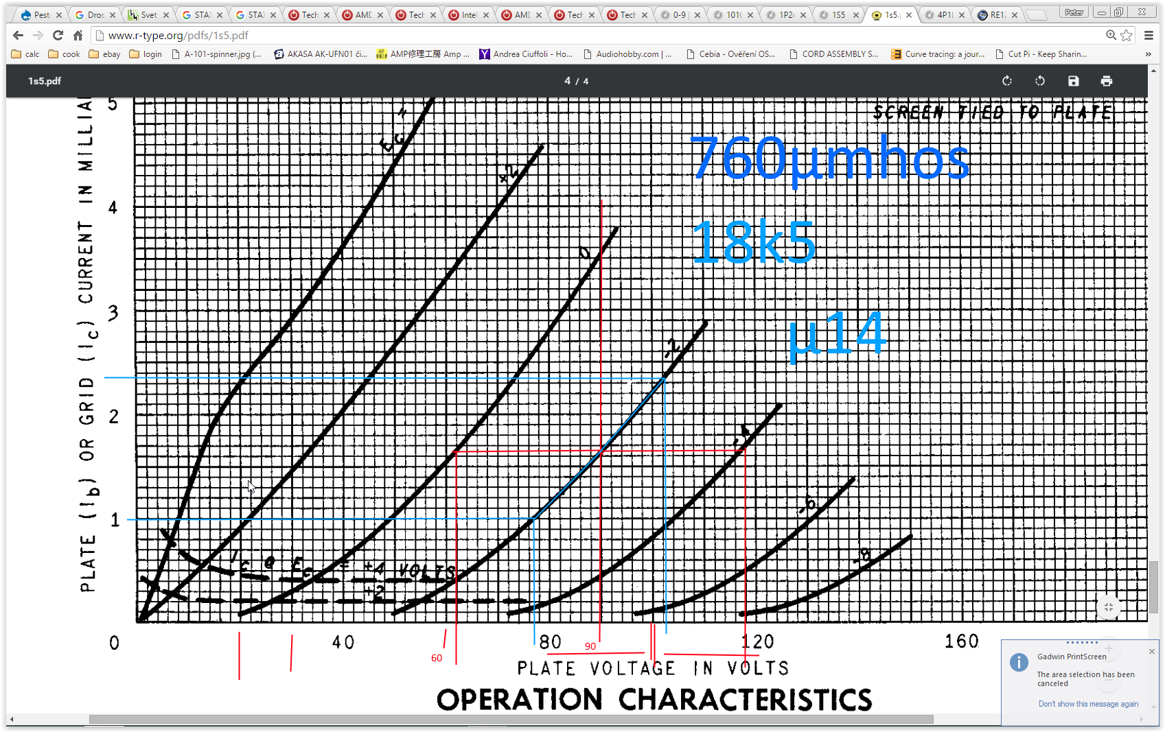

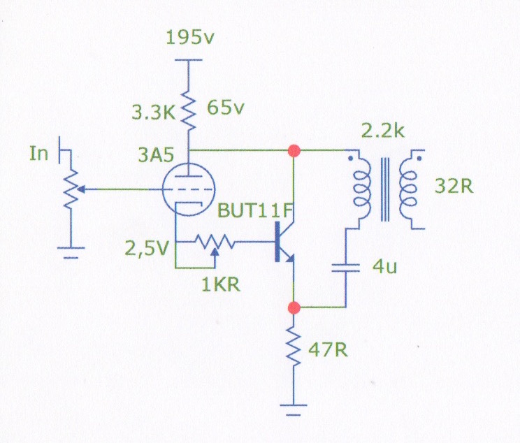

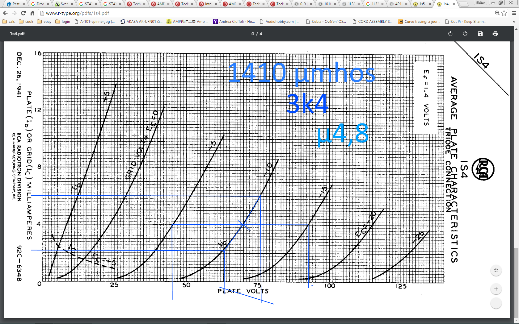

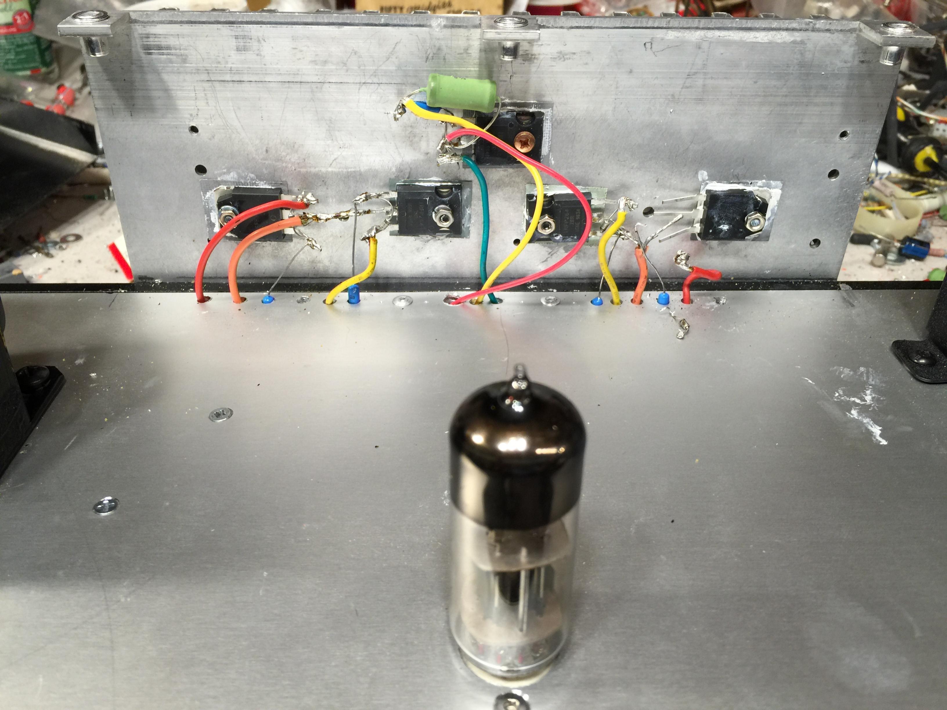

I'm going to build a triodelington - just for fun. This Bjt is the best I could find: http://www.mouser.com/ds/2/149/BUT11AF-102541.pdf
I ordered a few and tested them. Very consistent beta of about 23. Mu of around 10, and linear at low current for the valve would be nice. I'll actually make it as a headphone amp if it works well. Plan is a very simple, resistor loaded parafeed, with a small toroid output, and primary returned to emitter resistor. Was planning on using 3A5, but triode connected pentode might be even more fun.
Now that we've sorta highjacked this thread (but in good fun), here's what I was thinking. Remember, it's for fun, and yes, I know it's completely unnecessary. Now, if I could combine this with crazy drive, without too much gain, and at 1-2ma for the tube, that would be really fun.

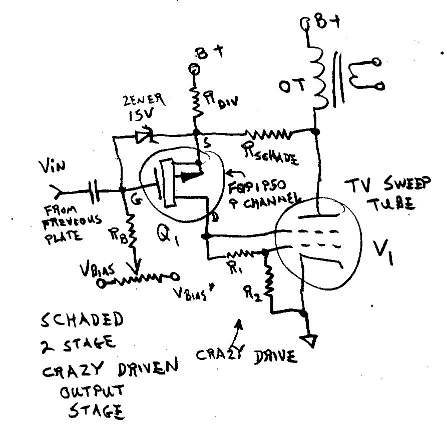

I came up with this the other day for a Schaded Crazy Drive (turning it into a "triode"). I think Anatoliy had something similar once for a PSRR fixup for g1 driven Schade.
G2 drive or Crazy Drive does not leave as much loop gain available for Schade N Fdbk as normal G1 drive. (which would not lower Zout so much) So this uses a P channel Mosfet driver stage to greatly improve the Fdbk. (and the PSRR too for the Schade) Should end up with a rock solid low Zout, and a Schade emulation of a triode with remarkable linearity. (the Crazy Drive being very linear for V to I to start with, and then the high loop gain Schading with the Mosfet) The P Mosfet also solves the high voltage drive swing issue for Crazy Drive or g2 drive.
(the Mosfet needs a gate stopper resistor yet)
Yep, that's it. Excellent idea.
If only we had a P tube now. But the Mosfet is easy to hide under the chassis at least.
It is what I use in my hybrids now, a P-output tube, directly coupled to N-driver tube. ;-)

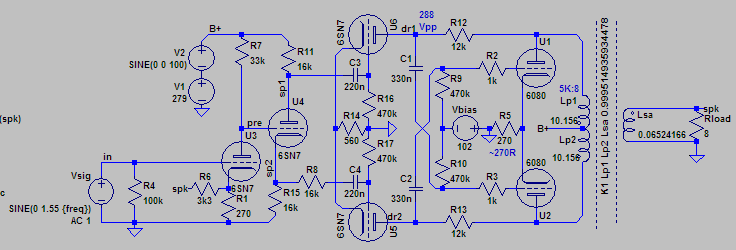

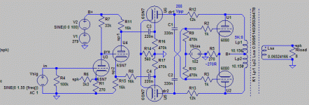

Getting back to the power triode subject more directly, one should mention this scheme posted by Goldenbeer recently.
Over Unity Positive feedback from the output OT to the driver stage bootstrapped loads. It apparently nulls out 3rd harmonic distortion of the 6080 (or any regulator type triode, with plate curve rollover) by sloping the 6SN7 driver loadlines with an effective negative resistance. (the loadline slopes upwards at higher plate V, the opposite of the norm) This allows one to put expansive 3rd harmonic into the 6SN7 driver output, to null out the compressive 3rd harmonic from the output tubes. See below. (R12 and R13 look like Schade feedbacks, but they are crossed to the opposite plates to get positive Fdbk)
Global N Fdbk keeps the whole thing under control. Although it would be safer to put some "local" N Fdbks around the P Fdbks, so the OT bandwidth does not become a stability issue at HF. (The N Fdbks need to remain effective at HF, to prevent oscillation from the over unity positive feedbacks. Global N Fdbk might not make it.)
This general theme can be used in other ways. I have been thinking of using P Fdbk driver bootstrapping (somewhere below unity gain, not over unity gain) to get sufficient drive for g2 or Crazy drive. Then some "local" (no OT in loop) N Fdbks around that to keep it stable. (OT UL taps used for positive bootstrap sources to the driver loads, and also used for N Fdbks to the driver grids or cathodes. Phased correctly. More gain in the N loops.) (one could TRY over unity gain in the P Fdbk loops to eliminate any 3rd harmonic, as long as it all stays stable)
The scheme however does not address higher harmonics (than 3rd). Which are likely to be non negligible if starting from a poor quality triode characteristic. But then one could try the resistive tail trick on a differential driver stage, adjusted to null 5th or 7th harmonic of the whole amp. ( I do see a 560 Ohm R14 in the Goldenbeer amp schematic driver stage below.)
