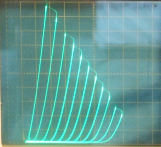

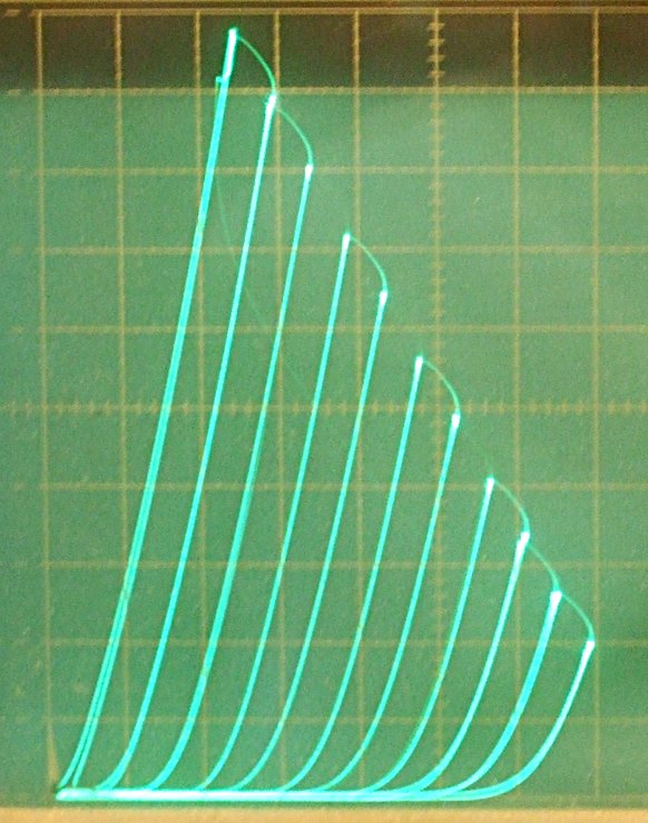

The curves for the $3 "perfect" triode came from a tube on this ESRC list below. They are still $3 because no one wants them!
Its a dual octal DHP, total Pdiss of only 3 Watts. Mu 10 in triode.

Then there is THIS $1 tube (again at ESRC, the "dollar list") that makes a great 10 Watt triode: gm 21,000
Mu 28.5 (hint: the Tube from HL, and a curve tracer selected example shown)
And a 33 Watt sweep tube in triode (selected 36MC6)

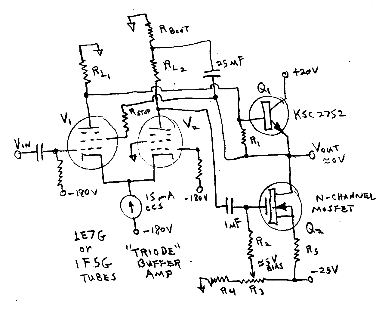

the "Cheating" "Triode" Buffer Amp
still could use a DC bias servo loop, to keep the output at 0V (at least a bias adjust pot on V2 grid 1)

The "Cheat" buffer above avoids most of the Beta variation issue by using N Fdbk from the final output back to the screen grid. The high (loop) gain, from the pentode plate current drive, locks it all closely to the internal tube "Mu". A Mosfet as the top follower output could enhance the loop gain.
The same screen grid N Fdbk scheme could be used for the Triodelington in Sziklai form (P type up top). [HV PNP is easier to find with constant Beta, HV P channel is getting rare now, FQP1P50 I think is obsoleted]
