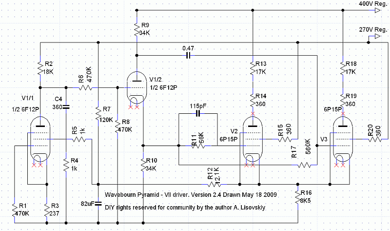

Wavebourn Member Joined 2006 wavebourn.com 2016-07-22 8:20 pm #61 2016-07-22 8:20 pm #61 Don; your schemo is half Williamson, half my Pyramid. 😀 I have directly coupled driver, and pentode LTP. And I have servo to keep it stable. Attachments Pyramid-VII-driver-2.4.gif 40.3 KB · Views: 239
