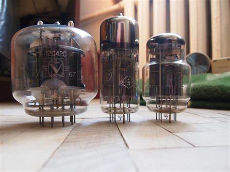

Soviets also made 12c42c...which are unlikely to ever be found...but what a beast!
Yes v4lve, I have been satisfied with 6c19 in a differential output stage and Morgan Jones used a 6528 in a published SE design, achieving 6.8 watts at 3.2 % THD. However, I think using these regulator valves is going to be a pretty minority activity. The Americans seem to have huge stocks of the TV beam power valves of many different types. I don't know about continental Europe but that is not the case in the UK; the only one I ever see in any quantity and at a reasonable price is EL36 (black and white TV). It's easier and cheaper to get Russian ones (6P36S is a fantastic sleeper, nice in triode even without feedback).
Wow acg, a beast indeed! I know that 6s33 is two paralleled 6s41; is the 12s42 four in parallel?
What is the valve in the middle?

Piano3, I believe that is the 6C47C.
The 12c42c is I believe 3 x 6c33c sections connected internally in parallel. I have never seen one...that is an internet photo. Rp is extremely low, something like 75ohm. Would love to find some to play with.

Russians made a number sort of “similar” regulators tubes: the low gain triodes - 6C19P, 6C41C, 6C47C, 6C33C, 6C18C, 12C42C. The 6C41C, 6C33C and the 12C42C are essentially the very same tubes but with different number of anodes, and consequentially with different dissipation power
However, in several places I heard different ratings of the first 6c41c, which should be in fact a "real" ordinary triode and by the logic of things should sound the best, from recommendations to ratings that can not be compared with the bigger brother 6c33c ...

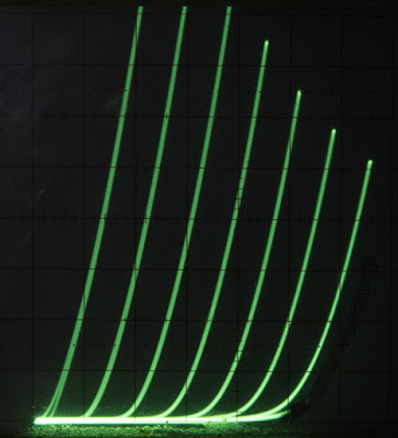

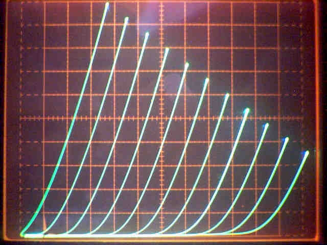

Thomas Mayer (VinylSavor) had a 6AG5 on his curve tracer:
VinylSavor: Tube of the Month : The 6A5
unfortunately he does not tell us the scales ...
Probably the same scales at least, look similar
2A3 then 6A5 curve pics from VinylSavor
both of them have some limited roll-over, but the 6A5 looks to have a little more
3rd pic 1E7G, a small DHP in triode, with low roll-over

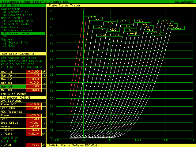

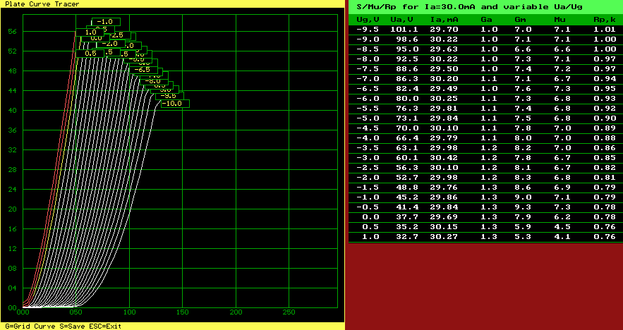

6P 43P triode curves from Klaus: And the low voltage curves:
