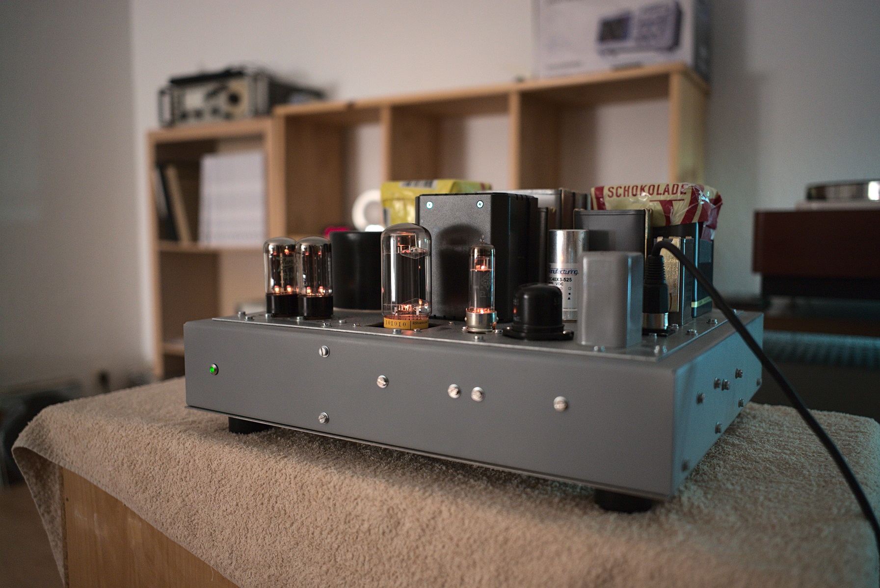

Who needs SET when there is SEP?

Btw, no nightmare feedback applied. This is NO Williamson.
Very nice, i think EL803s and EF12 driver stage?
Edit that Stahlröhre could be everything, you could also use the triode half of EBC11
If you really want to give the studio guys a hearth attack, say that that are VF14K
Why the 2x GZ34 though, that looks a bit overkill.
One for input and screen, one for anode supply. Two different complete PSU. Double mono, 50 pounds each. No overkill, just two good amps for 8W output.
EF12K and EL84 for driver. Had to slaughter a Klangfilm for those.😀
