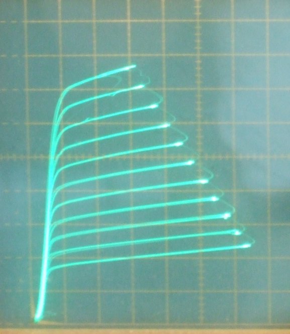

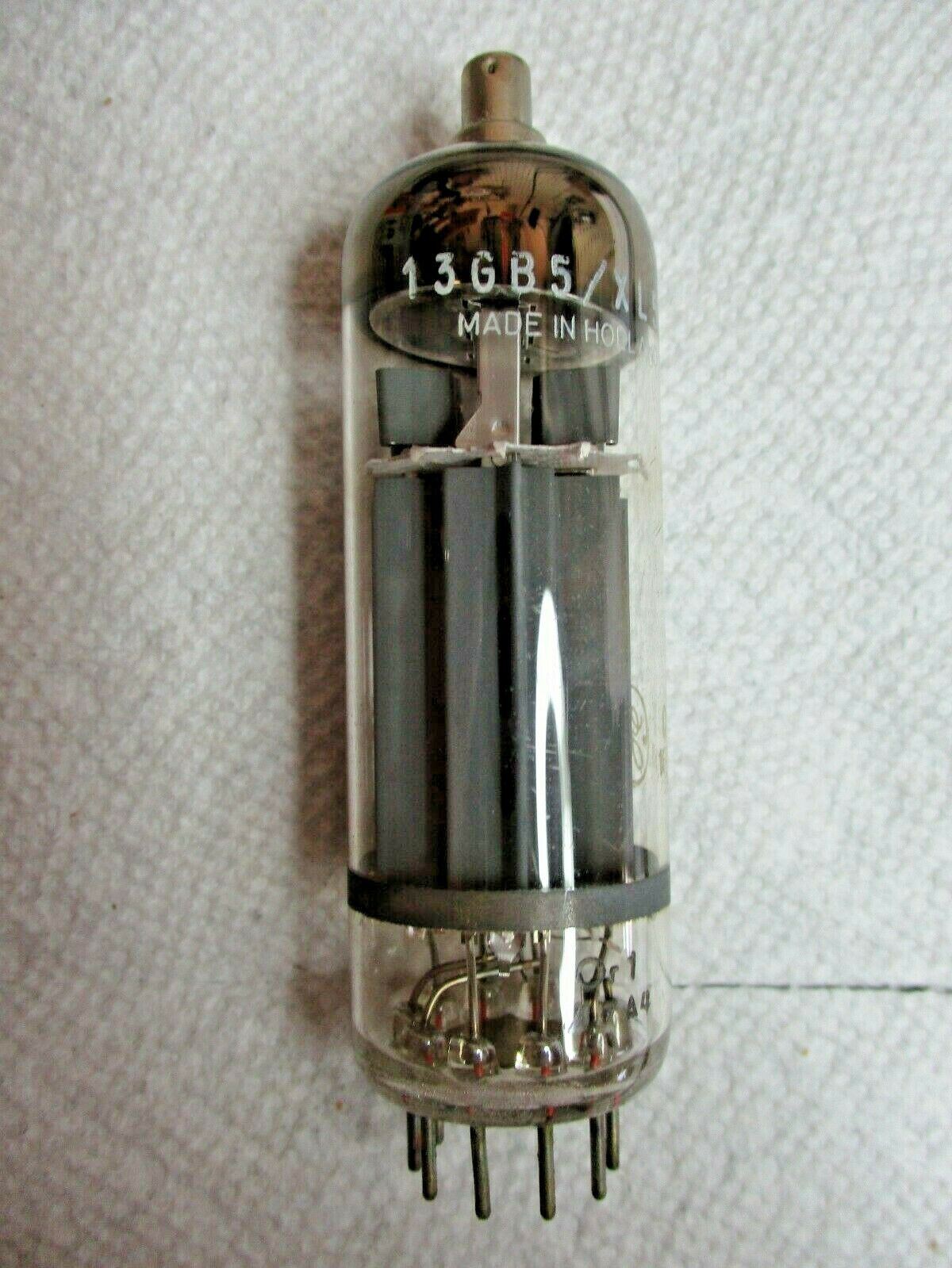

Here are some curve sets for 13GB5, including g2 drive and Crazy drive. (1st pic below)
https://www.diyaudio.com/forums/tub...ariants-screen-driven-amps-3.html#post4841935
As you can see, Crazy drive takes less drive voltage to reach the same output due to the grid 1 assist (about 30% less drive Vg2 for 13GB5). George (Tubelab) recently commented that he gave up on g2 drive due to too many Sweep tubes biting the dust. Just takes two resistors to get from g2 drive to Crazy drive for a safer and easier drive.
But the "new" series Schade (UnSET, CED at Tubelab) can get you constant Mu with low grid 1 voltages. This gives you low output Z, which Crazy drive doesn't have (needs N Fdbk around it).
Unfortunately, the above linked 13GB5 g2 drive curve set didn't get traced down to low V. That may have been before I did the 2nd mod to the 576 tracer to get 170V stepping for grid 2 plots. ( from 60V stepping for the 1st mod, would have used a 50V series fixed supply to reach 110V back then)
13GB5 is almost identical with 21HB5A for curves. And 21HB5A doesn't have any plate cap. (and the Chinese plate caps for 13GB5 just fall off besides)
Here are the 21HB5A grid 2 curves with probably the same 110V max g2 V (2nd pic below).

In the next post after the 13GB5 curves link, George mentions that ESRC sold 40,000 _GB5 tubes to some OTL maker. There may not be many of these tubes around any more. I see Graaf sells a set of 32 tubes for $500. ESRC sold them in quantity for $0.30 each.These tubes have been used in OTL amps by Graaf (16 tubes per channel).

Just to be clear, the two curves sets above: 13GB5 and 21HB5A were both using g2 drive. (I put the 1st pic comment in the wrong place above)

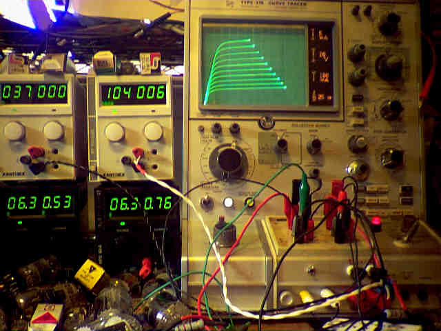

Picture of the 576 curve tracer below, with 4 Xantrex supplies for the 2 screen voltages and the 2 heater voltages. The DUT toggle switch on the tracer can flip between two tubes, with different continuous heater V and automatically selected screen V for each tube.
Easy to compare dissimilar tubes like 13GB5 and 21HB5A on this.

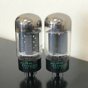

I think you are referring to the repacked sweep tube to replace 6B4G
I looked it up: 6A5G. Data sheet says explicitly it was designed to substitute for 6B4G. Unfortunately, there is no plate characteristic graph.
