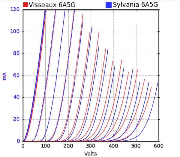

attachment.php

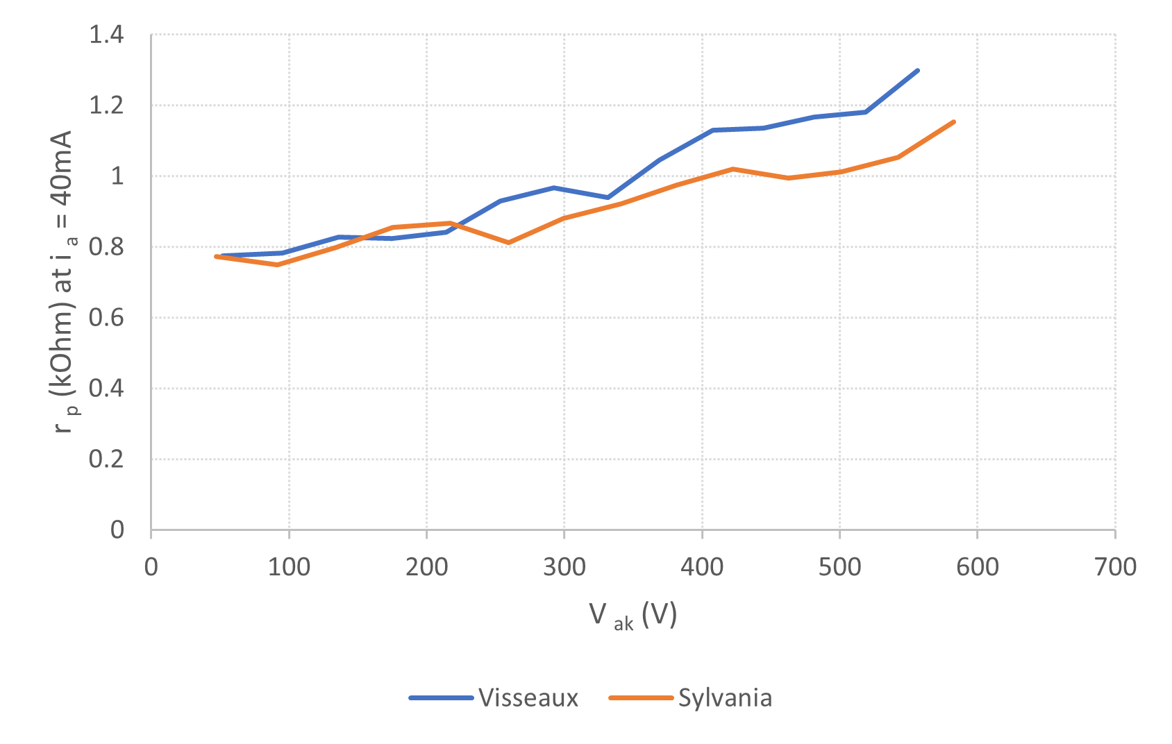

Less rollover on Sylvania curves
At 40mA plate current, the plate resistance (rp) of the Sylvania has a slower rate of change as Vak rises than the Visseaux. Put another way, the Sylvania's plate curves show less "rollover" with rising plate voltage. Looking at the plate curves, the Sylvania would be considered more linear.
