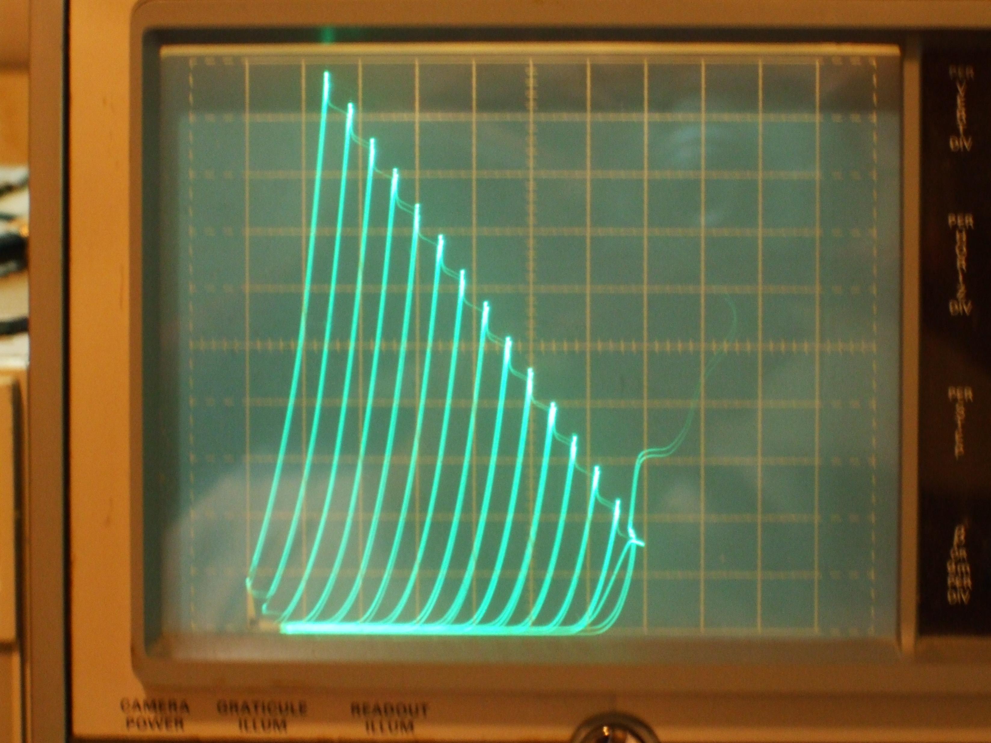

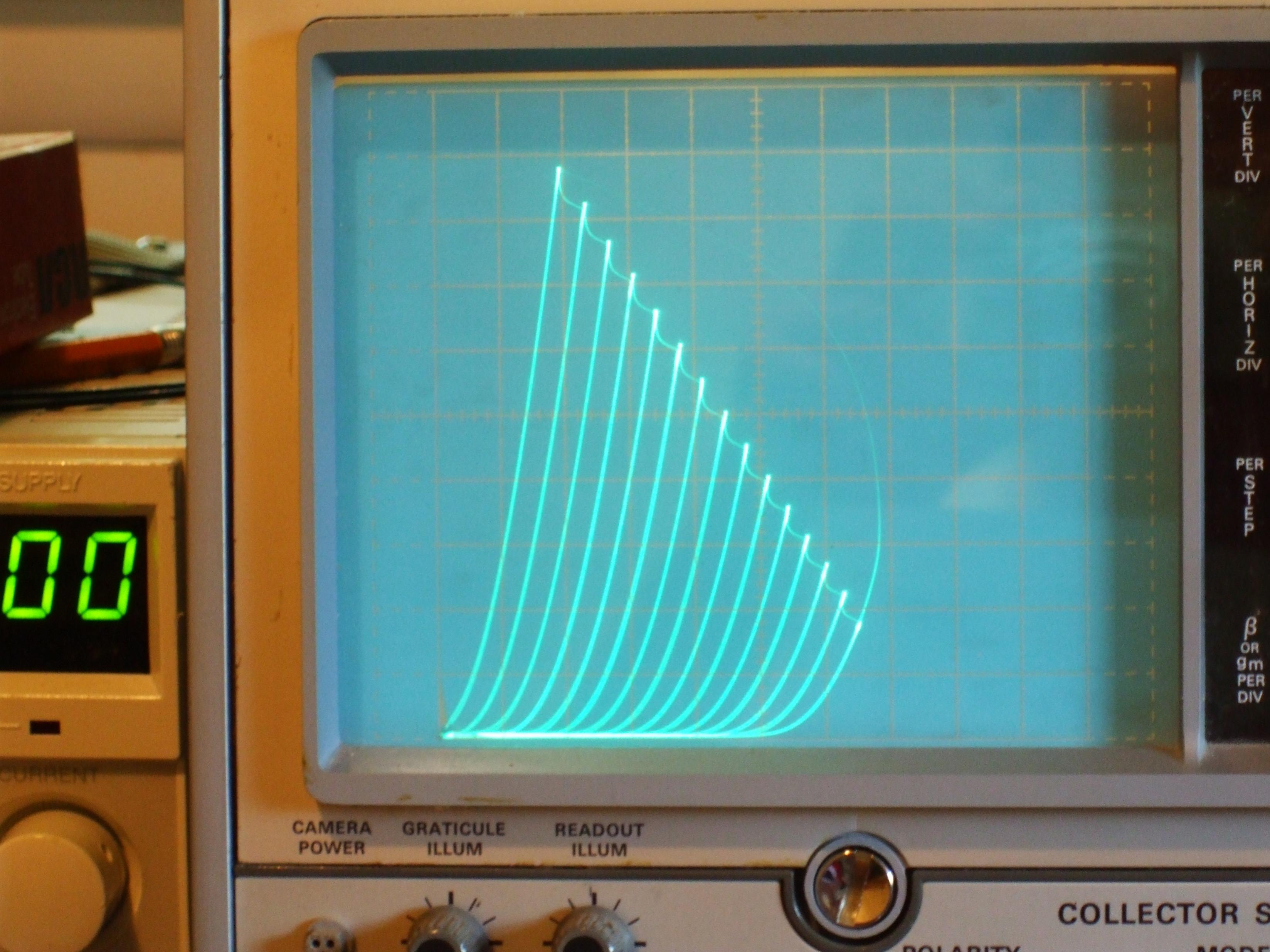

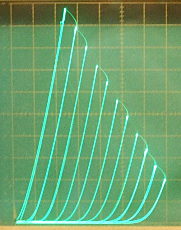

Here is a 6HJ5 TV Sweep using "new" series Schade (UnSet, CED at Tubelab).

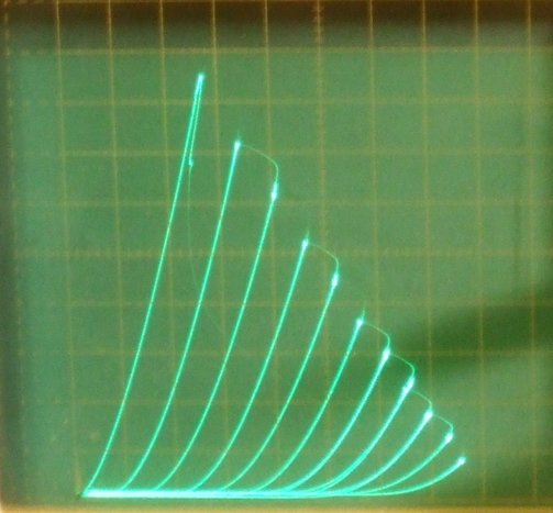

2nd pic is the 6HJ5 using conventional internal triode mode. (with typical high triode plate curve rollover of Sweeps)

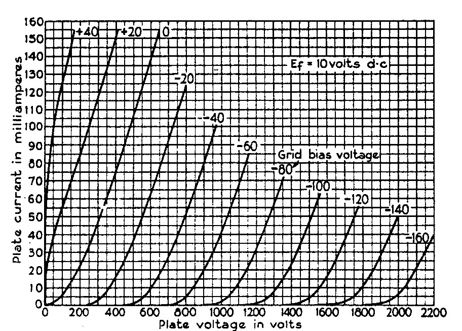

3rd pic is a 211 DHT (rollover mostly gone)
DHT typically gets rid of most of the plate curve rollover. Reducing 2nd harmonic dist. greatly. The latest series Schade, UnSet, CED can do it too. (and 1/2 an Amp at top of the screen)

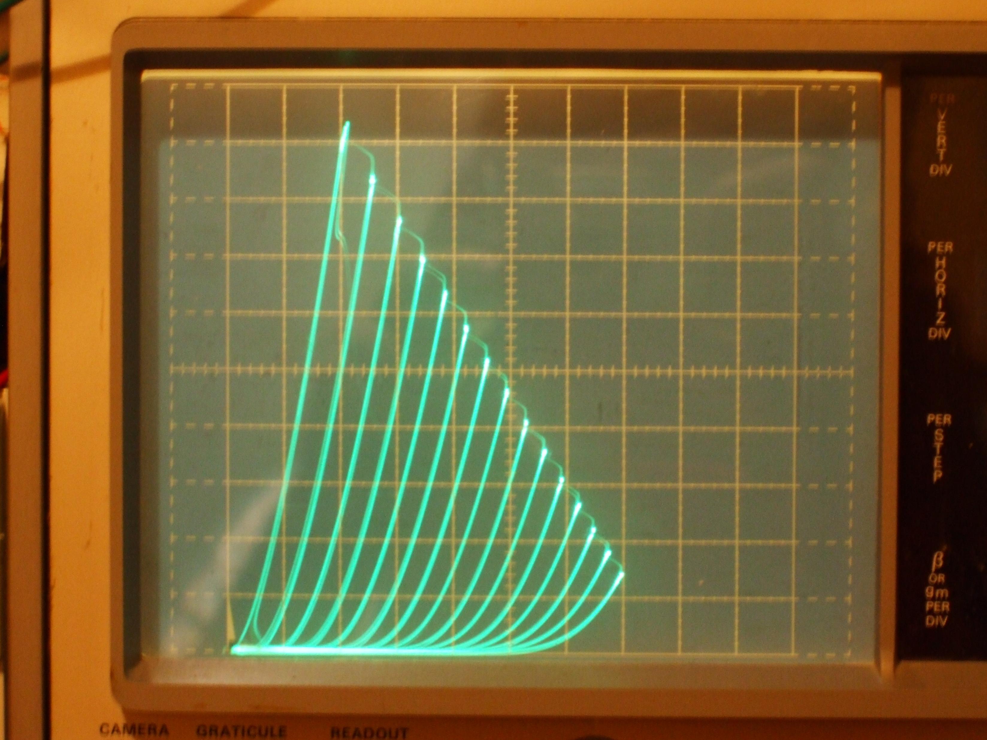

1st pic, is a series Schade corrected Sweep curve set adjusted for near to no roll-over (over adjusted a little actually). 2nd pic is a DHT with naturally low roll-over. 3rd pic is high roll-over (actually the same tube as the 1st pic, but without the heavy roll-over correction).
4th pic is the previous posted series Schade 6HJ5 curves, with modest correction.
5th pic is same 6HJ5 with no corr.
6th pic is a frame grid video tube with naturally low roll-over
7th pic is the 211 DHT curve set with low roll-over
Roll-over refers to the triode curves at the HV end having a higher Ri, making them appear to roll-over to the right. Just compare the 0 Vg curve on the left with the rightmost curve. Are they identical? Usually not. The roll-over effect causes 2nd harmonic crowding of the curves on any load line drawn. DHT tubes have less, IDH ones usually more. CED/UnSET can fix them.
Those curves are shot on a tektronix 576? That is the mercedes benz of curve tracers.
You shouldnt get me wrong, this is not criticism but meant to be constructive.
SOME of the artefacts you see have to do with the way the sweep is generated in that machine. The step generator is a pulse integrator, that abuses some logic gates to make a zero crossing comparator for synchronizing the sweep with the staircase generator for the grid sweep. this is eventually fed into a pulse integrator, and this pulse integrator shifts somewhat. If you look at the manual you may see in the scope pictures of the schematic of the staircase generator that show the steps are not quite horizontal but have a very very small incline to them. This has to do with leakage current in the integrator stage of the machine, and i think if you douse the entire staircase generator board in IPA you can lower the leakage somewhat.
The anode sweep consists of pulsating AC so each curve is written twice, because there is no cut off at the peak of each sine so its not a sawtooth shape. If the grid shifts somewhat and the phosphorous dot walks back over the screen this will cause artefacts on the display. I think this causes some of the differences you see in your comparison between Directly and indirectly heated triodes. Because simply put the indirectly heated tubes you mention have WAY higher transconductance and MU. If you use the series resistance bank in the 576 this effect will be WAY more pronounced in indirectly heated tubes, because of higher MU and Transconductance.
The 577 is the cheaper, simplified version of the 576 because the latter was too expensive for companies to afford. It uses to matched NPN BJT pairs for the zero crossing comparator. Sometime ago i wanted to build my own tube curve tracer that used two floating high side current sense amplifiers to take the IA readings of two tubes simultaneously. So you could overlay these on a simple analog scope in XY mode. I actually made fixtures for testing two tubes simultaneously.
You may be describing the TEK 577 or 575 step generator. (using a pulse generator and integrator)
The 576 uses a D/A converter fed from a digital counter (ICs) followed by a high speed step amplifier with Neg Fdbk. The digital chips have also been changed from 7400 series TTL to 74LS00 TTL, and the counter logic race condition fixed with a 74LS132 in place of the 7400.
I became thoroughly familiar with the 576 after making extensive mods to it for doing tube curve tracing. This model can now do stepping up to +/- 172V versus the original +/- 20V. It also does 15 curves max now instead of 10 for the original. It now uses high speed HV transistors for the step amplifier as well.
The plate voltage sweep can be selected for either either half wave 60 Hz (in either direction with blanked retrace) or full wave 60 Hz sweep. So plate sweep voltage can be done with either 0 to Vmax or Vmax to 0 or both. It can even display tube pentode knee hysteresis by switching the sweep direction for both ways and using an odd number of traces.
I -have- seen some tube datasheets where every other plate curve is shifted a little, giving the appearance of "twinned" plate curves . This could be due to the type of step pulse generator you described. In the 576 tracer there is a comparator adjustment to center the step triggering from the 60 Hz sine wave to get equal spaced traces, and it can be checked easily by selecting between half wave and full wave sweeps. The load resistor can also be selected for value via the max power limit.
The 576 is rock stable, with regulated power supplies for everything internal.
And it weighs a ton from the large xfmrs used to supply all voltages including the HV plate V sweeps. The typical tubes tested here only draw a fraction of the 220 Watt power rating for SS devices it was designed for. The highest 1500 V sweep has also been modded to 750V at 2x current rating for a better and safer match to the tubes tested, although I usually use the 400V max scale.
I am confident the differences between DHT curves and IDH curves are real. And the series Schade / CED / UnSET can smoothly correct the difference.
The video tube posted above ( 6th pic) with DHT like curves has a gm rating of 21000, so that would dispel any connection between tube gm versus curve shape.
Series Schade / CED / UnSET also works well with the lower gm 6L6-oid tubes to fix triode curves.
The cause of plate curve "roll-over" is well known. The later tube designs pushed for more gm with the advent of Neg. Fdbk that could make use of it. This generally led to grid 1 wires being placed closer to the cathode, causing wire proximity effects, called island effect or inselbildung as described in Deketh's book or Spangenberg's book.

Spangenberg 1948 describes the situation classically, and his 1957 _Fundamentals of Electron Devices_ chapter 15 is a big improvement over RDH4 (IMO) for its discussion of non-linear effects.
I'm a big fan of type 211 but wouldn't believe GE's curves without testing. Curves in those days were drawn with French curves and sketched in the parts that "didn't matter". Call me cynical; just don't call me late for dinner.
A different issue is whether or not you should be operating down there anywho. This is DIY; pick a better spot for your picnic. Just another opinion.
This generally led to grid 1 wires being placed closer to the cathode, causing wire proximity effects, called island effect or inselbildung as described in Deketh's book or Spangenberg's book. It gives grid 1 something like a square law transfer function, versus grid 2 with a 3/2 power transfer function. As the current varies, the two different power laws mis-track. Causing variation of the internal grid 1 / grid 2 Mu factor and consequent variation of Ri seen as "roll-over".
The TV Sweep tubes generally have an internal Mu of 3.2 up to 4.2, so are right in the same range as the power DHT tubes used for SET. But the gm of grid1 and grid 2 are both increased significantly over DH tubes. Gm per se is not the problem, if the grid wire pitch is shrunk by an equally appropriate amount to match the closer cathode spacing. But Neg. Fdbk coming on the scene allowed for sloppier tube construction, more gm could just fix it using the N Fdbk. Fewer grid wires than needed for linearity allowed higher current, for more power.
