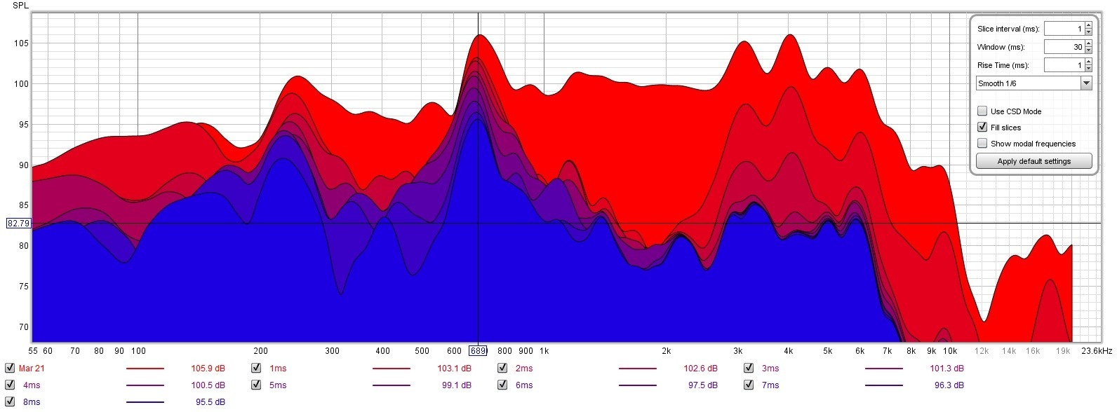

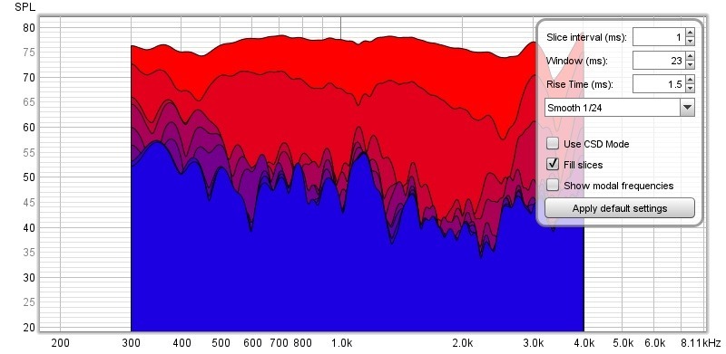

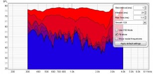

Here is the decay of the same model driver in two different boxes. One box has a bunch of stuff in it to damp and the other has nothing. When there is nothing the speaker can stop faster at some frequencies but has resonances. With 4" of melamine 4" from the back wall and stuffing behind that, I can zap it. But if you look at 800hz-2khz there is an added delay in the decay.

It's reasonably smooth, so I wonder if it's because of the scales?there is an added delay in the decay.
It's hard to say whether those resonances low down weren't hiding during the other shot too and have been uncovered. It's also uncertain whether they are related to the box modes. In any case they're a fair way down.
These two graphs are miles apart... one is smoothed at 1/6 and the other at 1/24, the scale is different and the timing settings (window, rise time) are different too.The choice to dampen hits a broad range of frequencies. I often wonder if the cure is worse than the disease. View attachment 1055620View attachment 1055621
Not quite telling a useful story this way. No way of knowing how clean those windows are at 23 ms or even worse 30 ms, what are we looking at? If it's a measurement
from within a room, there's quite a bit of 'room' in the pictures here already. I'd bet we're not looking at the results of the driver + box here by itself, isolated from other factors.

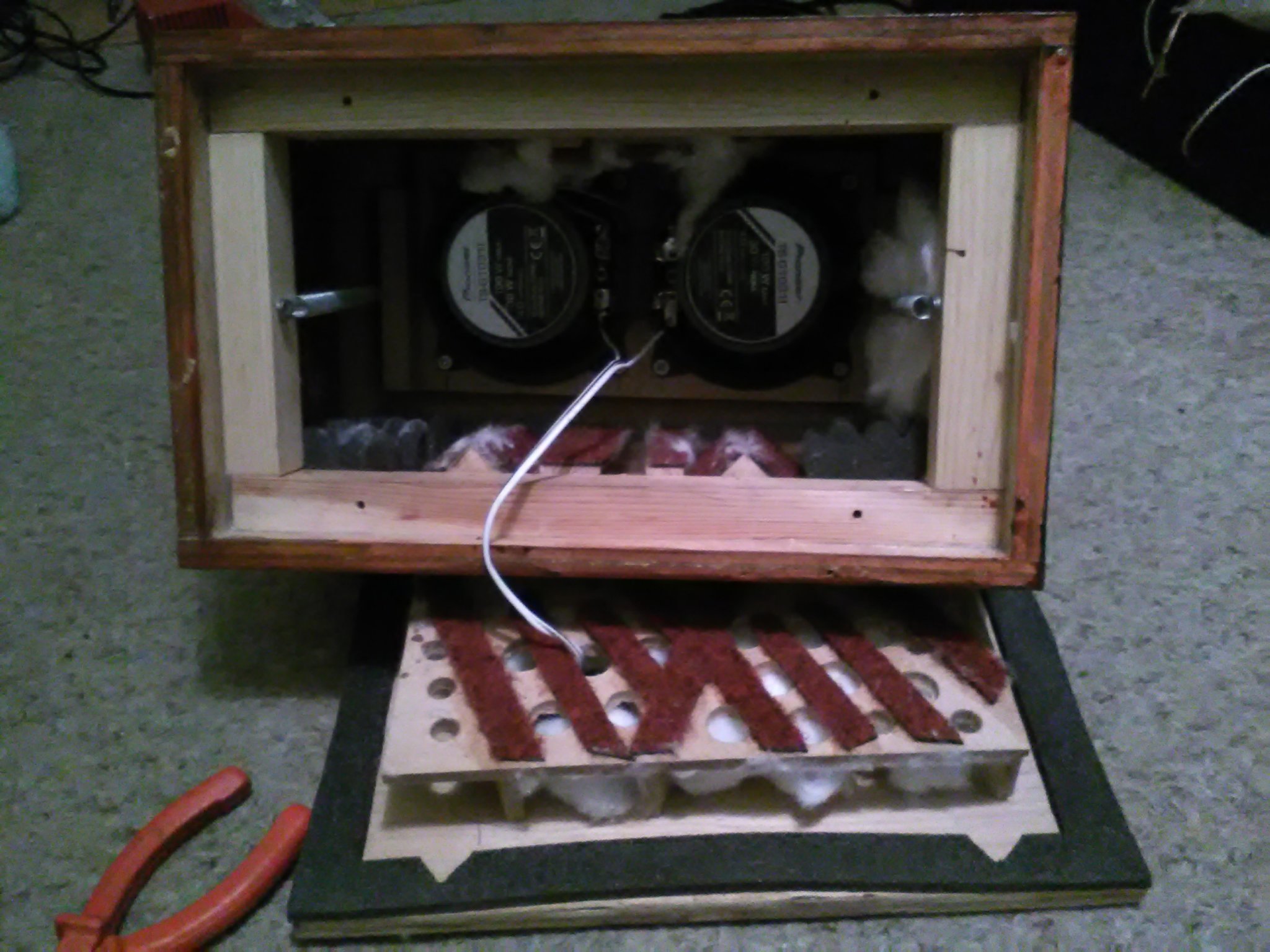

Here's a few ideas as to how you can absorb the sound radiating from the rear of the speaker cone. When I was starting out making speakers, I tried a driver ( with a weight behind the magnet to reduce mechanical vibration ) in un-stuffed boxes, and the boxy echo was awful so ever since I've don my best to reduce the effect.
