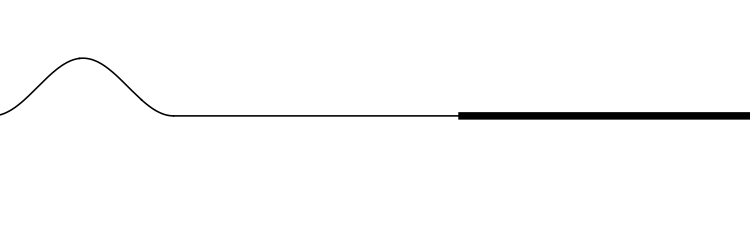

How much of that is actually transmitted through the cone while it is working?
When a wave encounters the rear of the cone, part of the wave is reflected from the cone and part is transmitted through the cone.
The exact ratio of reflection to transmission depends on the material of the cone - the denser the cone, the less the amplitude of the transmitted wave.
The animation shows what happens when a wave travels from a low density (high wave speed) region into a high density (low wave speed) region.
