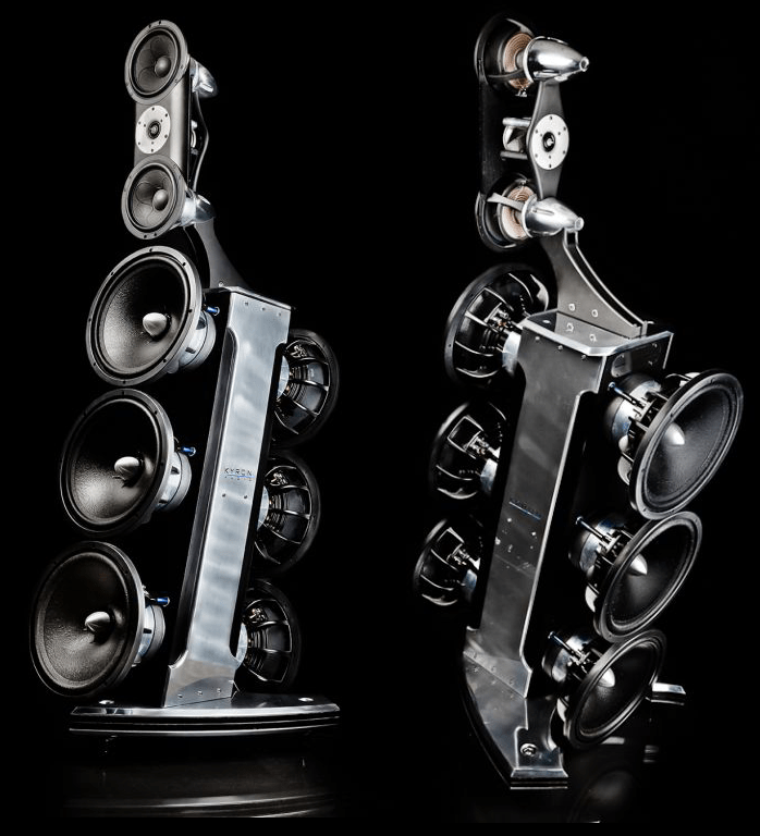

there are those who defy even open baffle and use speakers free air, which he said is never used 🙂

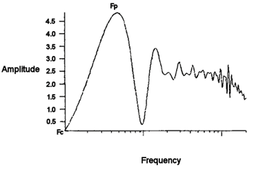

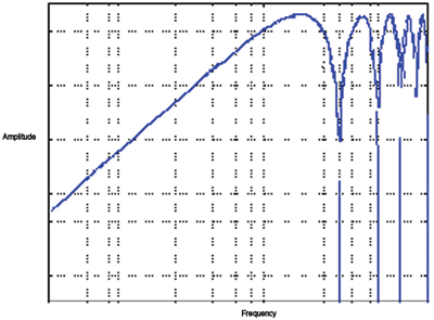

The first two attached images show, respectively, theoretical frequency response for a point source mounted at the centre of a circular baffle, and an actual measured frequency response of a 100-mm (4-inch) driver in a 300mm (12 inch) circular baffle. The only good words to describe either frequency response are "awful", or perhaps "horrible", or "atrocious".

It's true that changing to a non-circular baffle, and offset-mounting drivers, make the awful frequency responses slightly less awful. But throwing away the OB and mounting the driver in a box of the right volume, properly built, braced, stuffed, and measured, will give you a vastly less-awful frequency response. And a good (read: flat) frequency response is the single best thing you can have if you want better speaker sound.

Like face tattoos OB is not for all applications but for some they should work very well. Frequency response graphs don't tell about psycho acoustics. For OB one uses (or should use, many try misuse) the part below diffraction (or dipole null) and have sufficiently many ways (4+) and woofers to get full bandwidth SPL capability, no diffraction, no coloration from the speaker structure at all since the drivers can be positioned at null of each other. Yes, many drivers and big, probably DSP and many amplifiers, expensive. Baffle is unnecessary, just naked drivers. What is needed from such system then is sufficiently large room where the back radiation does not interfere where it would matter, if the speakers are positioned so it does not arrive as first reflections but for the late reverberant field I see no downside. They have constant directivity, no box sound, no diffraction (crossed below diffraction), possibly reduced early reflections. Should make very good system, no other problems than finding the cash and big dedicated room. Never heard any OB systems though 😀
