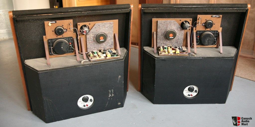

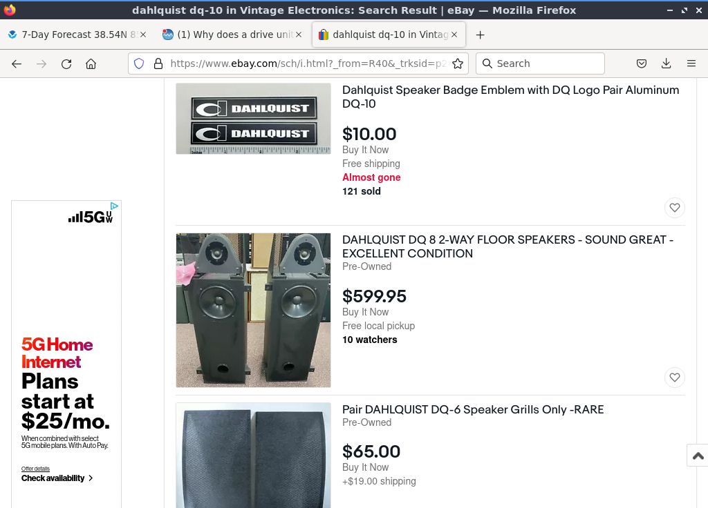

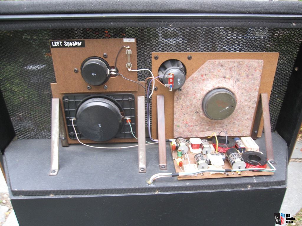

Finally some light. ebay has a pair of dahlquist 8 speakers for only $200 more than I paid for of my SP2(2004). $600 https://www.ebay.com/itm/234498431827?hash=item3699321b53:g:S1gAAOSwp~5iTnw5 Dahlquist 8 is pretty obvious bass reflex box for a 10" woofer 50 cm? high. On top of that a triangular flange for a 3"? 4"? tweeter. Tweeters don't gain anything from the box except shipping/cat/dog/child protection. OB would be fine 3000 hz up. Room effect dominates radiated sound from naked tweeter with small open baffle. .Indianajo - the Dahlquist 10 speakers introduced in the mid-70s had minimal baffles on the mid and hi freq. drivers, so the "open baffle" or min. baffle concept existed in those days.
I'm building some SP2-XT copies (15"+1.4"CD) to replace my stolen ones, that will mount the 1.4" CD horn naked on a pole. Outside the box. Saves 10 lb from the box, making it easier to put the woofer bass reflex box on a pole with 15" driver head high. I'm age 71 and I can't lift 92 lb SP2-XT 66" high anymore. OTOH, I don't imagine a titanium compression diaphragm enclosed in an aluminum can voicing through a 3 mm thick plastic horn would project much sound 1200 hz up through a 15" woofer mounted 24" below it. Even if the box wasn't stuffed (which it is).

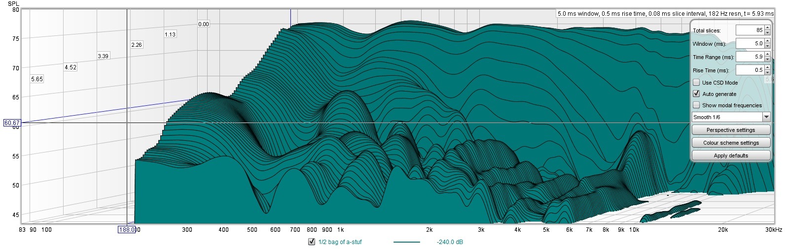

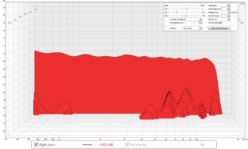

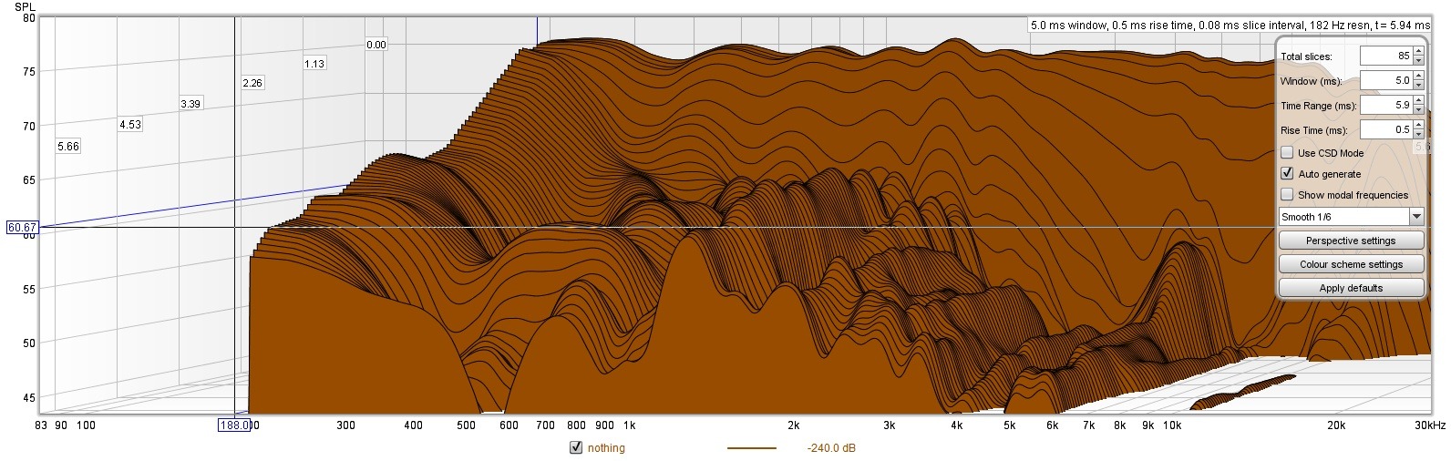

yeah, not the best A/B comparison images for sure. I did them at different times in different boxes with the mic close to the driver. The greater point was the decay has a 1ms shift just 5db down vs no stuffing. This can be seen no matter the settings.These two graphs are miles apart... one is smoothed at 1/6 and the other at 1/24, the scale is different and the timing settings (window, rise time) are different too.
Not quite telling a useful story this way. No way of knowing how clean those windows are at 23 ms or even worse 30 ms, what are we looking at? If it's a measurement
from within a room, there's quite a bit of 'room' in the pictures here already. I'd bet we're not looking at the results of the driver + box here by itself, isolated from other factors.
Someone new to this hobby reading this thread would not believe one can put a driver in a box and obtain a good result... 😳
So it shows your stuffing example was rubbish, but it's not telling us stuffing in general does not work 😉

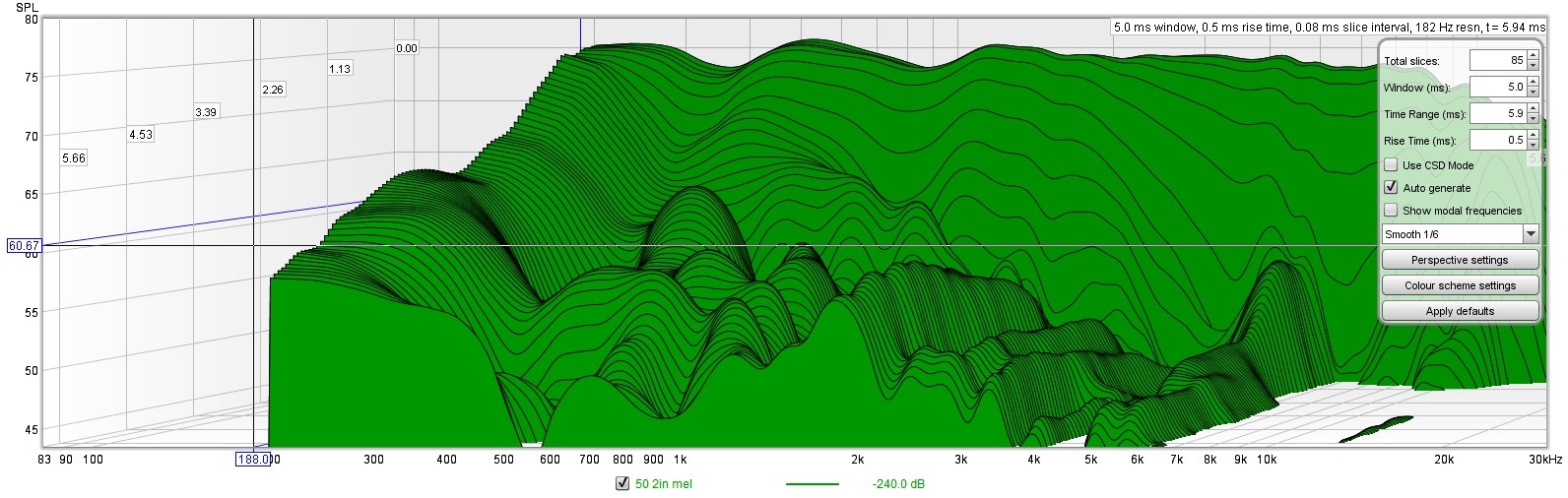

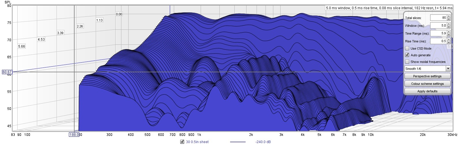

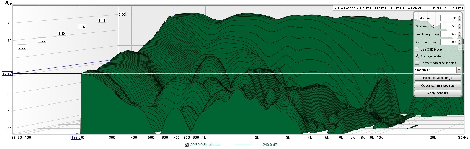

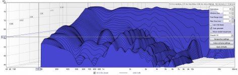

I did do this before with an sb 5" coax. I'll have to find that file and look at the decay graphs. I do have the waterfalls handy with diff. stuffings:So it shows your stuffing example was rubbish, but it's not telling us stuffing in general does not work 😉

This was the first time I noticed stuffing slowing down the decay.
These all had the same driver and same box.
