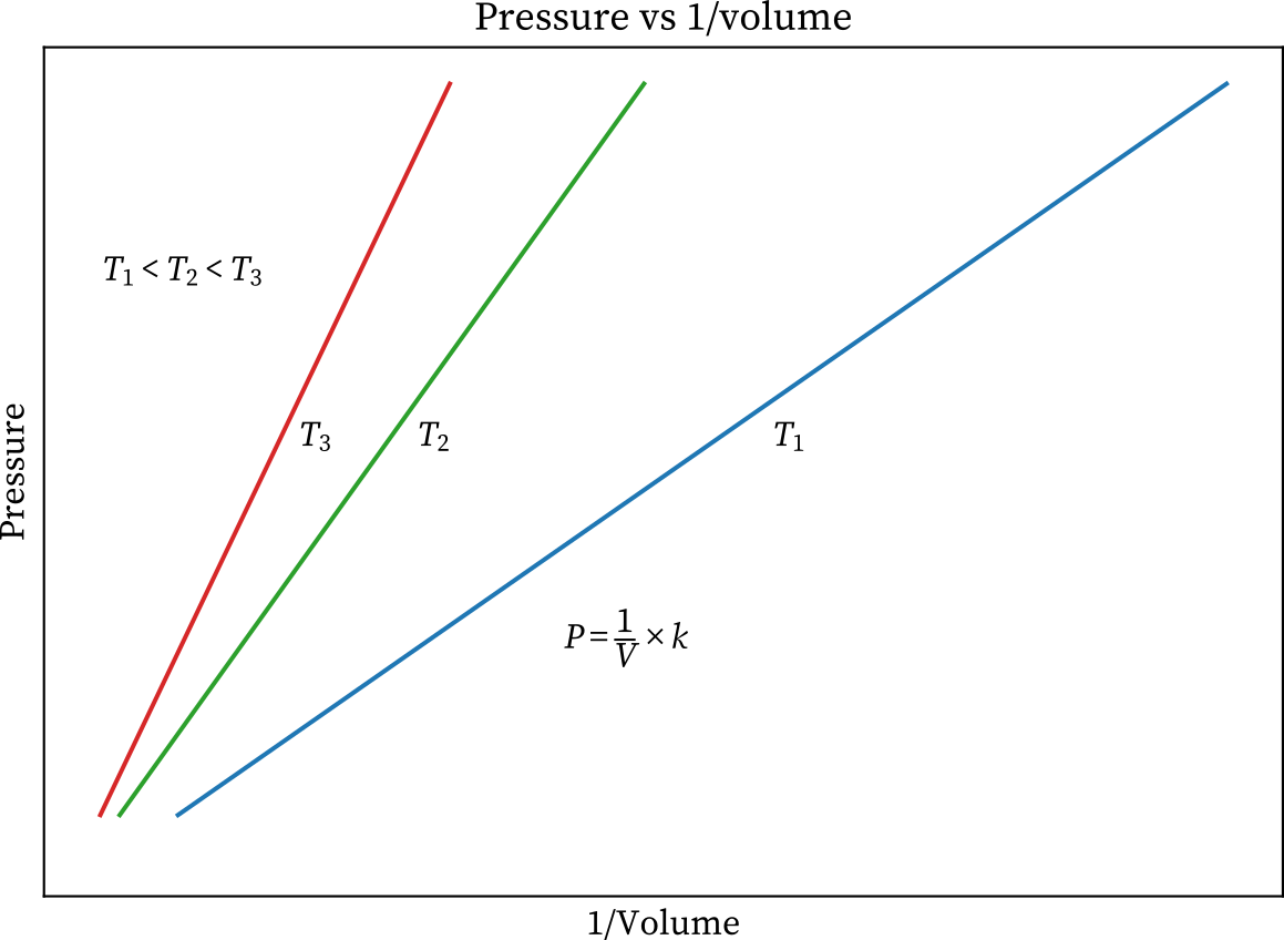

P is proportional to 1/V - describing a hyperbola rather than a straight line.
I'm not sure I follow you there.
A plot of P against 1/V is a straight line (see attachment).
