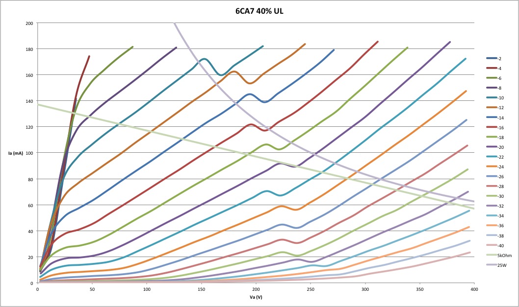

OK..... so here is the same tube with UL 40%, that does not "look" as pretty... I did not expect this to look like this, so I repeated the measurements just to be sure the kink in the area of interest was not a measurement error.
It is difficult to see that any load line will give decent linearity for large signals...
I understand that the optimal UL tap % is very tube dependant, so is this variation not part of an explanation why some amps sound poorly with a standard tap %?

"so here is the same tube with UL 40%, that does not "look" as pretty..."
Holy cow! I think the 40% UL boat just burned and sank. With such big kinks in the curves, I would suggest curve tracing the same tube in ordinary pentode mode to see if the tube itself has a significant "kink" problem. But it certainly illustrates the issue of screen grid currents corrupting the transfer.

Well one example doesn't sink a boat. I have an example from the late sixties that is an anathema to many with high GNFB and UL, but it manages 25W at 0.1% THD and 34W at 1% off a pair of EL34s.
Would I try and get UL to work with any other than the usual suspects of El34/6500/KTxx? Probably not, but I also want to try different things now.
The Beam Tetrode tubes would have much lower g2 current (aligned grids) than the pure pentode tubes, so one probably can get away with UL mode there.
Never-the-less, seeing the g2 current show up badly in the plate curves is very disconcerting. The HK Citation II used UL mode with KT88s, but also used plenty of effective local driver stage N Fdbks. I think Bob Carver was the one who commented that Stu Hegeman had said UL mode was a mistake in the design.
On the other hand, I have noticed that aligned grids cause the transfer function for grid2 to drop to a 1.3 to 1.4 power law (instead of 1.5 power law for non-aligned grids). (an anti-proximity, or shielding, effect for g2) This makes the psuedo triode curves mistrack even worse from the g1 grid's power law (which is up above 2.0 power law over a considerable range). Likely accounting for some of the bad press for psuedo triodes versus real triodes. (although most of that is likely just due to the older triodes having lower gm and less grid wire proximity problems to begin with.)
UL --- final burial, RIP

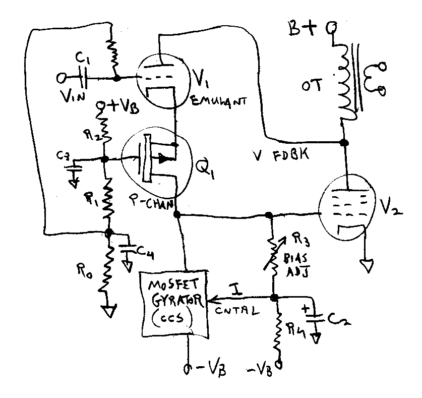

There are multiple ways to do local feedback to the driver stage, instead of "shaky" UL mode. R feedback to the driver grid (crossed for P-P case), to the driver cathode, or the driver plate (Schade Fdbk). And then combo's of those, such as used by the Cit II or the RCA tube handbook 50 Watt Amp.
But it occurs to me that what most of us really want, is to make the output tube act as a triode, without sacrificing any power output, and low distortion too.
So why not just do it right.... Attached is a circuit to make the output stage V2 act just like triode V1. An emulation circuit essentially. Plug any high Mu triode into V1, and the output V2 just copies it. Could work for SE or P-P. V2 still operates in pentode mode, with a fixed +Vs on grid 2, but it behaves as V1.
V1 is used in inverse triode mode to serve as the local N Fdbk attenuator. In order for V1 to operate at constant current, its plate must behave as -Mu times Vin. Any deviation from the Mu rule, and the Mosfet Q1 (and its Gyrator load) instantly corrects the grid drive to V2 to obtain that. One could put an additional R attenuator in the V2 plate to V1 plate feedback path to accomodate lower Mu tubes for V1 too. One could also look at this as a voltage mode Schade N Fdbk circuit, instead of the usual current mode Schade setup.

Interesting idea. As there is nothing new under the sun, do we know if this has been tried successfully before, or has it previously been dismissed due to evil sand?
There was a Japanese site that had actual tested circuits, where a triode was used in inverted mode for N Feedback. I don't recall them using this particular implementation. But they had numerous variations on the theme, and I haven't looked at it again in years.
There is always the question of stability when one closes a loop with gain in it. But that should be manageable with an RC dominant pole inserted, if the main components don't already provide that.
I had suggested the idea a long time ago for the global N feedback network of a SS amp (or Tube Amp) to give it a single tube SET sound. Probably never got tried. Some complaints were made about messing with the N Fdbk network too casually. (ie, tube swapping)
I HAVE seen a tube Amp schematic where the global N feedback was taken back to the screen grid of the input tube (instead of the cathode), so the internal tube Mu was used similarly for enforcing SET sound. This also got some negative comments about being non-linear Fdbk. (Probably by the same people that use UL all the time.)

This looks like an instrument anomaly, not the tube. In many measurements, range shifting can cause that.
It has to be something with the setup on the uTracer. Normal UL characteristic should be similar to the one shown below:
Agreed, it does look like a range change... I was planning to investigate this further....

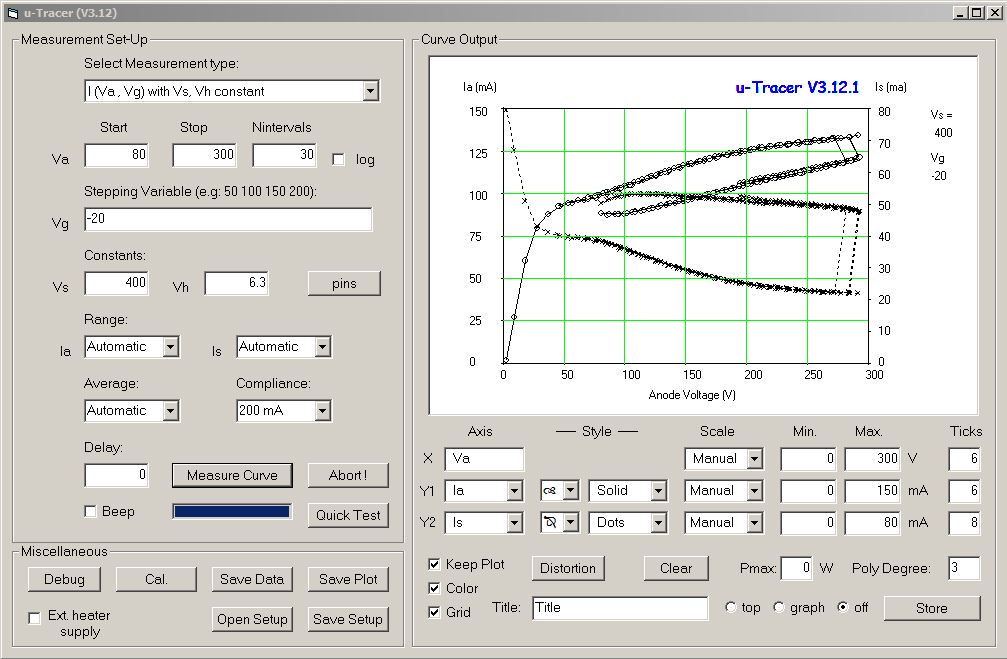

OK, something odd is going on with the measurements.
Firstly I upgraded to the latest GUI from Ronald Dekker's site. Then if I replicate Jazbo8's GUI settings I get similar smooth curves (no kink)
However when I replicated my own previous settings, and the kinks were still there.
So, to be able to zoom in onto the kinky area, I ran the tube in pentode mode with Vs=400V and swept Va to 300V. But, I discovered, the kink's appearance is dependant on the uTracer's sweep start voltage, with Vstart>85V = no kink, with Vstart<80V the kink appears! The traces take one of 2 paths, the upper is with lower start voltages and the lower one with the high start voltage. I would guess that the lower trace is the correct one, since it meets up with the upper trace after about 275V. Screen current has been included. The trace overlays are as a result of using different sweep start voltages.
Unless I am doing something really stupid, there could be a problem with the uTracer? Perhaps Jazbo8 can replicate my settings & confirm.

Jazbo8's illustration is quite nice. However, something is fishy there too. The pentode knee starts at 160 mA (k = 0), but at k = 0.4 it has dropped to 80 mA. This would imply only 25% as much power output for 40% UL.
Is the uTracer measuring screen grid current and then combining that, at k effectiveness, with the plate current in software?
