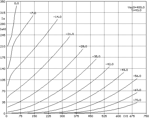

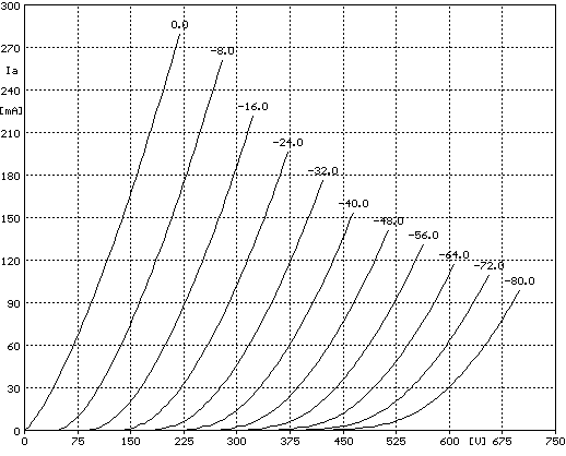

Some checks on two AB tube amps rated at 100W each with different o/p trannies both 43% taps and using ident tubes. 6550C were also tried with no thd improvement. Using KT90 represents a thd disaster as these are NOT optimised for audio work so thd was x10 higher.
The circuits were sim.
The value of the g2 resistor selected for lowest thd varied more with o/p transformer makes, but selecting diferent tubes specifically designed for UL operation showed hardly any variation.
Measuring the leakage inductance/capacitance between two o/p transformer vendors, the one with a 14 section winding had a higher leakage capacitance and didn't show any thd variation when the g2 resistor was varied from 220R - 1K and gave a consistent 0.25% thd at 1Khz 75W whatever res value.This o/p transformer manufacturer claims -3dB at 60Khz.
The other was a high performance 18 section configuration which measured 50% lower leakage inductance & capacitance values wound to Williamson spec and thd was same as above with nominal values but lower thd when g2 = 1K instead of 220R. This o/p transformer manufacturer claims -3dB at 40Khz. This 18 section design with 1K g2 res dropped thd to 0.05% at 75W. This is an excellent result but this shows how confusing it is without a thd analyser. Infact impossible for most.
....The 18 sect looked better on paper but required higher 1st stage zobel values to avoid a self resonance ring at 80Khz. The 14 sect gave a better square wave performance and seemed better behaved through to 50Khz and resp faded therafter. Both transformers are modern good quality winding designs with balanced windings, but this shows the variation between makes
that gave identical Pout.
This does imply that a designer can "overkill" a sectionalised design...where fewer sections can create a better performance. I take my hat off to the designer of the 18 sect design as he used a slide rule and the 14 sect design was computer optimised. Both makers know exactly what is involved..
The difficult bit is understanding the relationship with the tap leakage parasitics at the screen grid in UL and if anyone knows any literature on this I would gladly know.

In general I find the quoted upper b/w of an o/p tranny claimed by a maker i.e -3/-6dB at 60Khz is fine but when one gets down in the chassis, the usable often ends up more like 30Khz. That is one should be able to get a good looking 10Khz square wave peformance without skewing or overshoot at full power. This can be a tough challenge.
Strictly using Fourier analysis implies a 15Khz square wave requires a b/w of 45Khz i.e droop not greater than -6dB at this frequency. Fortunately there is no music content at this frequency.
As I see it the iron permeability and silicon hasn't changed from the good old days.... The core dimensions have a massive influence on performance.....greater copper CSA and longer windings add to leakage capacitance, even though this can be "ironed out". To be fair I get a better performance from a set of o/p trannies designed with cut off at 20Hz than 15Hz with a kg extra iron. With smaller cores the reduction of leakage parasitics can be beneficial although this conflicts with the optimum core requirements for a specific power throughput (in Radiotron H/book).
Johan# you rightly mentioned it's all down to cost and the law of diminishing returns. One can pay a massive sum for a quality lump and someone can say "get same with tranny half the size".
The way forward is with computer simulation, if one can get "ideal performance" with a lower section than going to the trouble of a high sectioned design then so the better. Unfortunately the real world often ends up with larger o/p trannies being a law to themselves and often smaller is better.
That 18 sectioned design I mentioned previously was interleaved with paper (ideal dielectric). Another point is with larger o/p trannies I always have to fit an R/C snubber between the anodes.
Another point that many find is different square wave quality on varying combination taps of o/p transformers i.e 4/8/15 Ohm secs. That can be dealt in another mail.
