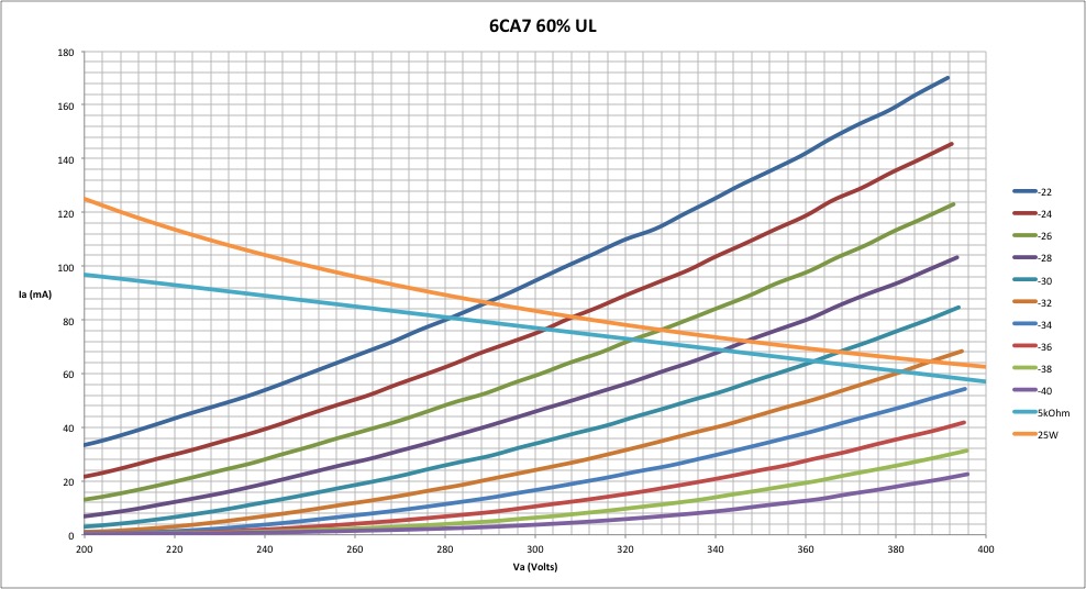

What was the B+ voltage for those curves?
One expects some oddities when the plate V drops maybe 100V below the screen V.

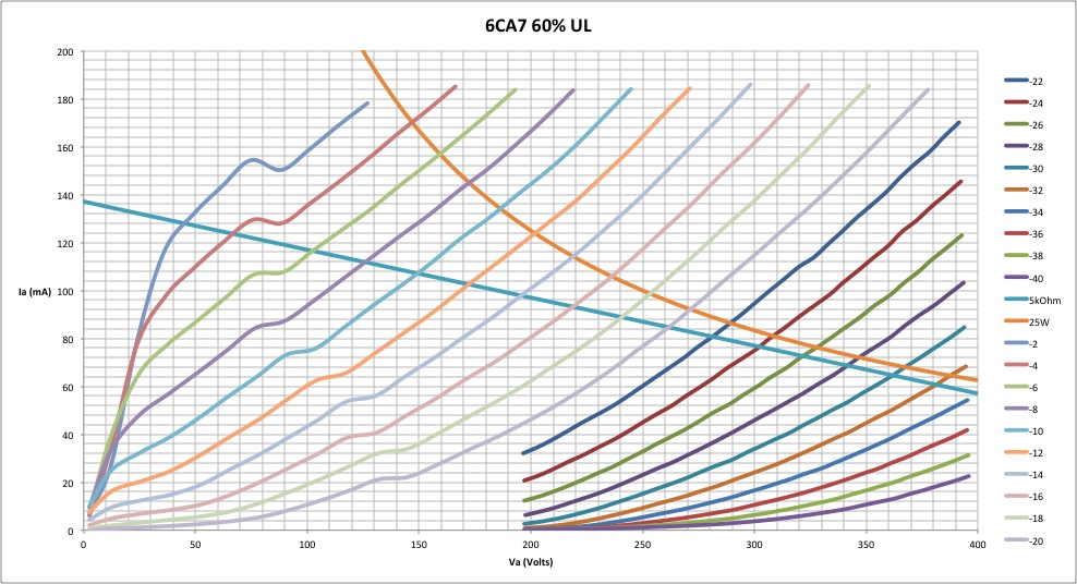

At -20 they sure look pretty, but go more positive up to 0v g1 and you'll see a not so pretty picture.Since I have a pair of 60% SE UL 5k OPTs lying around, and some spare 6CA7's I ran some tests today and I think the curves are visually quite pretty 🙂
B+ was 400V in this case
Where did you get an OPT with 60% UL tap? And why does the graph only focus on a narrow range of grid voltages?
Well..... it's a bit of an odd thing really. I purchased two Hammond 1628SEA's that should have a 40% tap, but when I measure across the primary using the wire colour codes according to the manufacturer, I get a 60% tap. In other words the inductance (large signal measured at 50Hz) between the B+ connection and the screen tap primary connection is larger than that measured between the screen and anode connection (17,4 and 6.4H approx IIRC). I don't know why, I guess they may have got the wire colours wrong?
Anyway, I used this in an EL84 SE amp for a bit and it sounds pretty good, and so had 2 C cores wound locally with a 60% tap to use permanently in the EL84 amp.
The curves come from the uTracer with k=0,6; Being new to the tube game I am just experimenting to get a better understanding what I am doing (or not doing for that matter). The focus on one range of grid voltages is simply to keep Ia below the uTracer's compliance level, otherwise there is a bit of post measurement data clean-up that has to happen.
Is anyone interested in lower grid voltages; I would not want to hijack the OP's thread.
It seems very likely that Hammond reversed the P and B wires.I don't know why, I guess they may have got the wire colours wrong?
That's odd, I thought you can set the Pdiss on the uTracer, plus Ia itself has a hard limit... anyway, it is just unusual to see UL characteristic bunched up like that.The curves come from the uTracer with k=0,6; Being new to the tube game I am just experimenting to get a better understanding what I am doing (or not doing for that matter). The focus on one range of grid voltages is simply to keep Ia below the uTracer's compliance level, otherwise there is a bit of post measurement data clean-up that has to happen.

On the uTracer you can overlay the Pdiss on the curves, but I don't think that will stop the measurements when it reaches that level (I will still need to check that statement!)
Anyway, for interest, I did some more quick measurements down to Vg =-2V. Apologies that the graph is not tidied up, but the grid voltage is stepped by 2V starting at -2V
