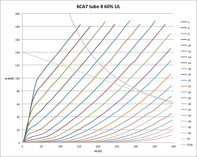

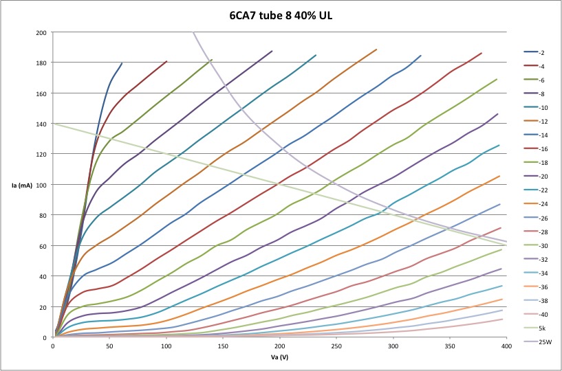

Nice, good to see the kinks straightened out. I'm surprised g3 would make that much difference, but the collected charge on it must have really gone wild.
Could you run the 60% case again too? Oh, and the B+, 400V?

I don't think the uTracer supports Eb>300V, so here is one done with the SPICE model, it should be close enough.
Yes B+ is 400V (latest uTracer version has hardware to support 400V)
Here are the 60% curves.
