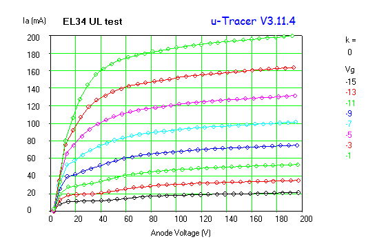

"And there is no requirement to make the load line 'follow the knee'; not sure what you're driving at there."
The efficiency is what limits a triode from matching the power output of the pentode or UL design. The triode (with typical load lines) can not operate down to 0V (or 50V) on the plate like a pentode. So it wastes a bunch of heat for nothing. It has a limited plate dissipation budget, so output power gets reduced.
Now, looking at the UL curves Jazbo8 posted earlier versus %UL, the plate curve "knee" moves down (lower current) and to LOWER Vp as k or UL% increases. This is signaling an opportunity to actually INCREASE efficiency ABOVE pentode no less. But it requires an increasing Zpri as k increases to intersect the "knee".
(the earlier studies did not take advantage of this beyond a very limited range, leading to INCORRECT or INCOMPLETE conclusions.)
But there is a limit to how far one can take this process, since the higher Zpri makes for a hard to make OT, and the increasing B+ required to take advantage of it (using the full Pdiss of the tube) soon exceeds the tube voltage ratings. So real triodes do not have optimised (for power) OTs. But UL can take advantage of this process up to maybe 50% UL.
The increasing Zpri with increasing UL (following the "knee") will also reduce distortion since Rp is decreasing from N Fdbk and Zpri is increasing. So increasing %UL would produce monotonically decreasing distortion and increasing power output (better efficiency) if it were practical to pursue this process. Practical OT and tube V breakdown limitations however limit this to around 40 or 50% UL.

The uTracer data from a real tube, fixed to include the k x Ig2 factor, provides a super tool for investigating UL. If the data can be manipulated mathematically, one could plot load lines (from the "knee" say, tangent to the max Pdiss hyperbola) and then plot the gain (delta Vout) versus Vg1 steps. All these questions of linearity and power output versus %UL can be answered definitively. (without having to wind one turn on an OT)
One might want to also do the analysis for a beam tube as well.
A super (new?) feature for the uTracer would be to take data along a specified load line directly, and plot the gain variation.
