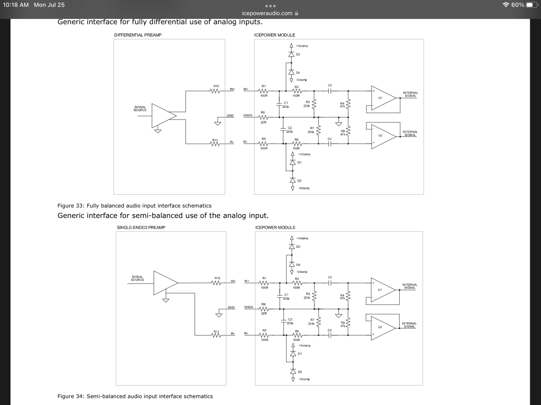

Those of you using 300A2, are you using balanced or unbalanced input?
I just noticed in the manual they suggest tying IN(-) to ground for what they call ‘semi balanced‘ input.
The cable set I got from Ghent has +/-/shield for the input cable. I only connected + and - on my chassis RCA input. Should I solder the shield to the negative connector?

If your cables are shielded only connect the shield at the RCA's. Connect it to the - but leave it disconnected at the board. You will probably have to rearrange the wires at the connector for "semi balanced".
I'm using the semi balanced inputs but I'm using twisted pairs instead of shielded wires so I only have the two wires to worry about. I'm not getting any distortion or RF interference.
Thanks. I currently have it wired backwards from what you suggest: the premade cable shield is connected at the board connector and not connected at the RCAs. I have the faintest hiss and mains hum at my speakers, but it's not noticeable even 6 inches away.
I will open the amp up when I get my meter driver board delivered and switch up the input connections to see if the hiss/hum goes away.

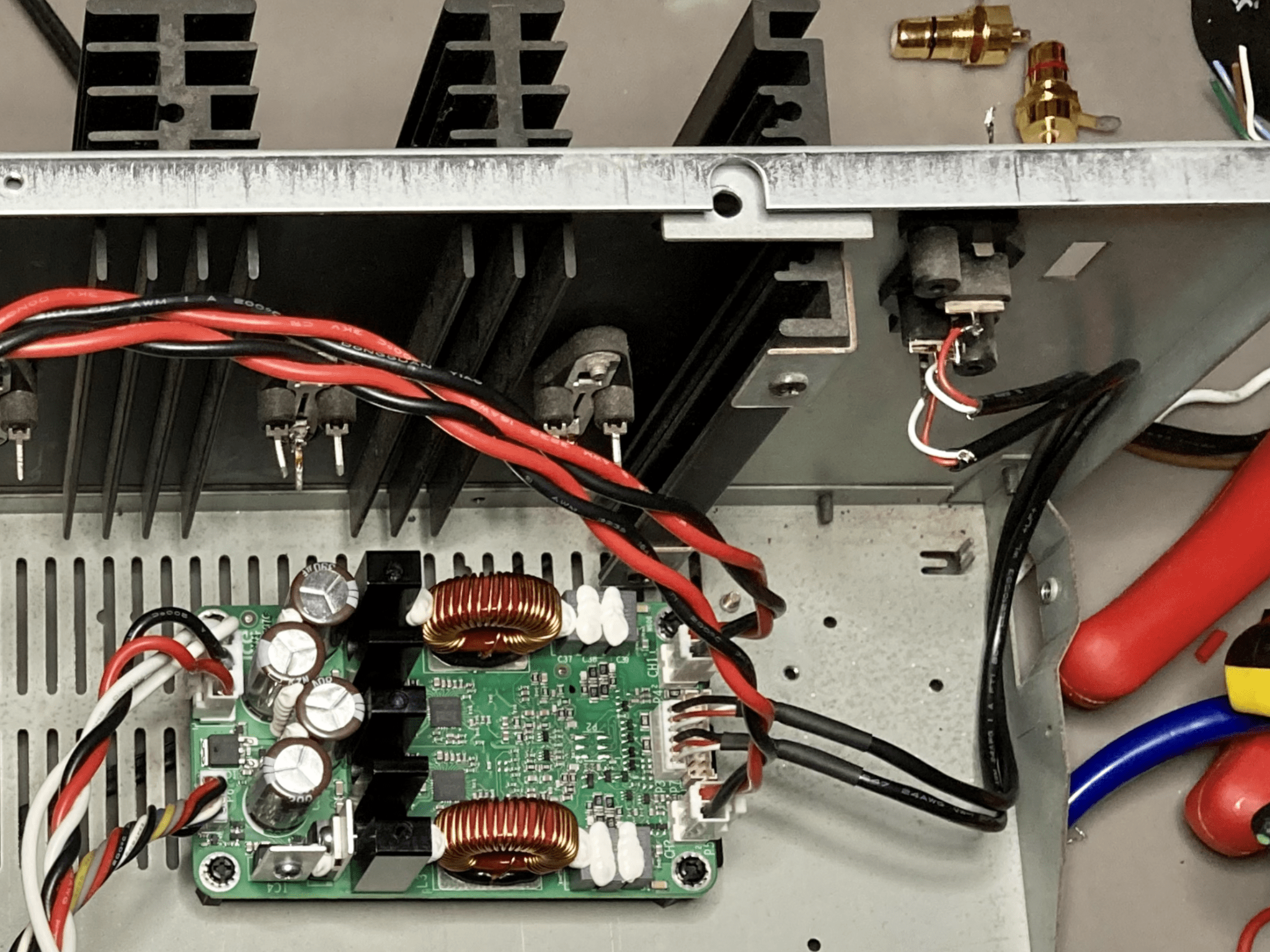

I tried Vmon 1 and 2 wired to the meters and used the SMPS aux 12v for the lamps, but the needles barely moved, even at full output. I wired up the meter driver board and got them to move appropriately, but there was a bad mains hum… Oddly I didn’t have mains hum with my iPad as the source at the testing phase. I’ll have to investigate further. It’s possible my kluged crimp connectors on the meters and spliced wires are inadequate/faulty. If the board doesn’t work out, I’ll wire up a simple circuit like I did for another amp with meters.

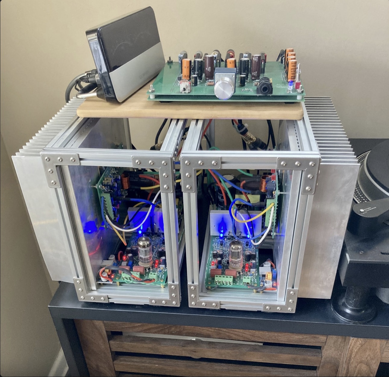

The good news is I swapped out the 300A2 amp in my main system with a build I haven’t used in a while (TubSuMo monoblocks), and it sounds fantastic, too. 🤓

Those are interesting mono blocks. What's the wattage on those? So it uses a tube pre-amp?
