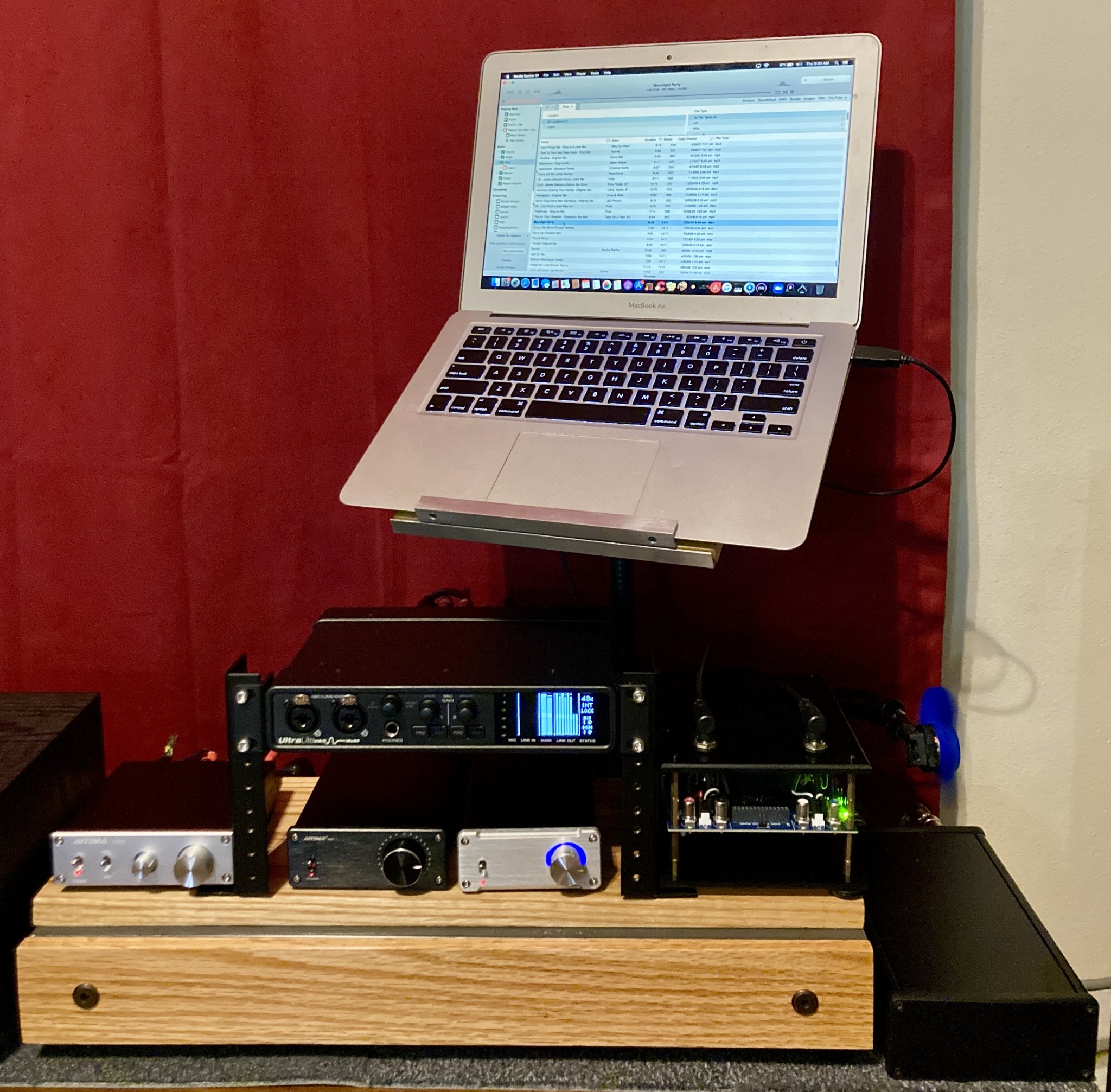

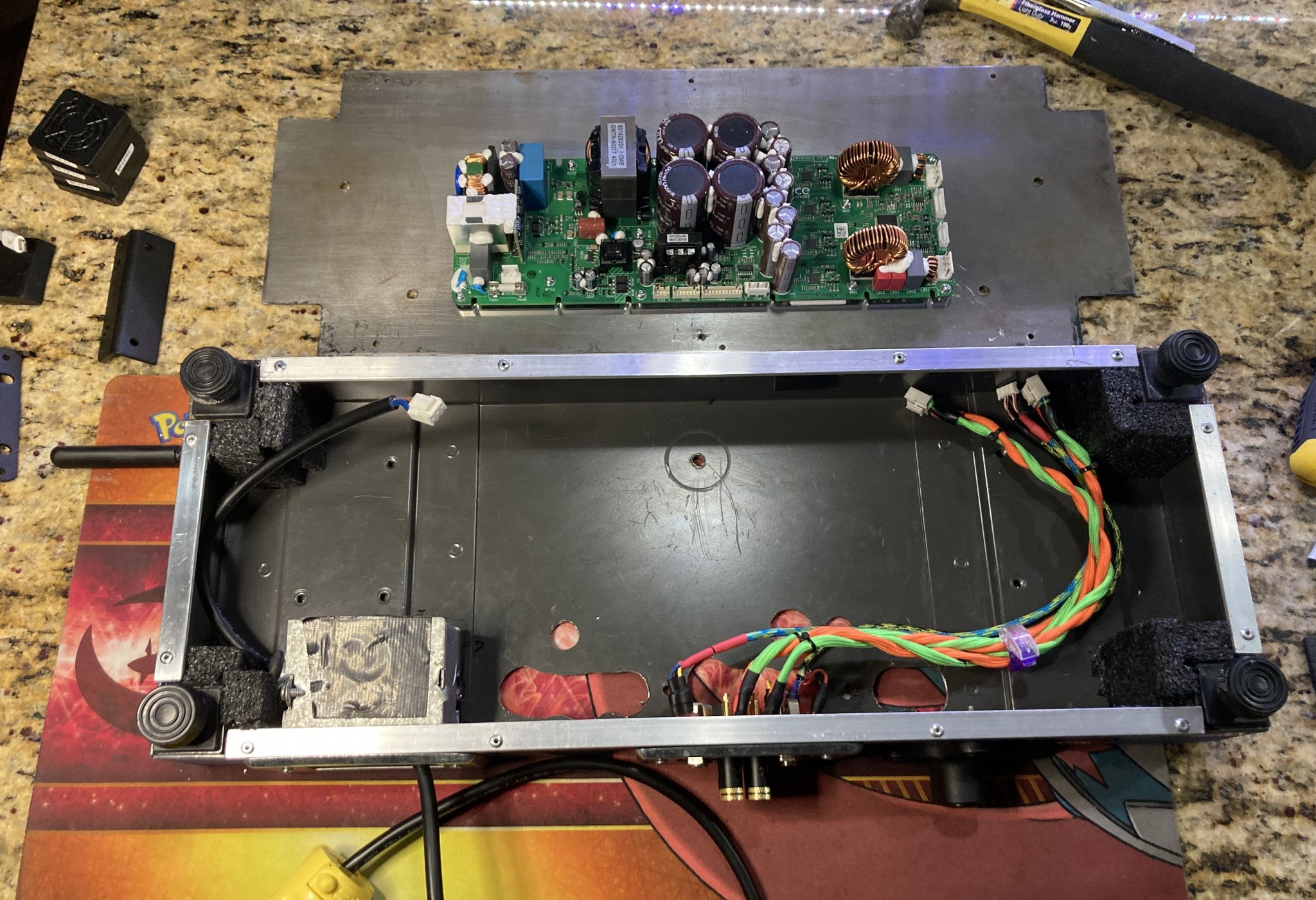

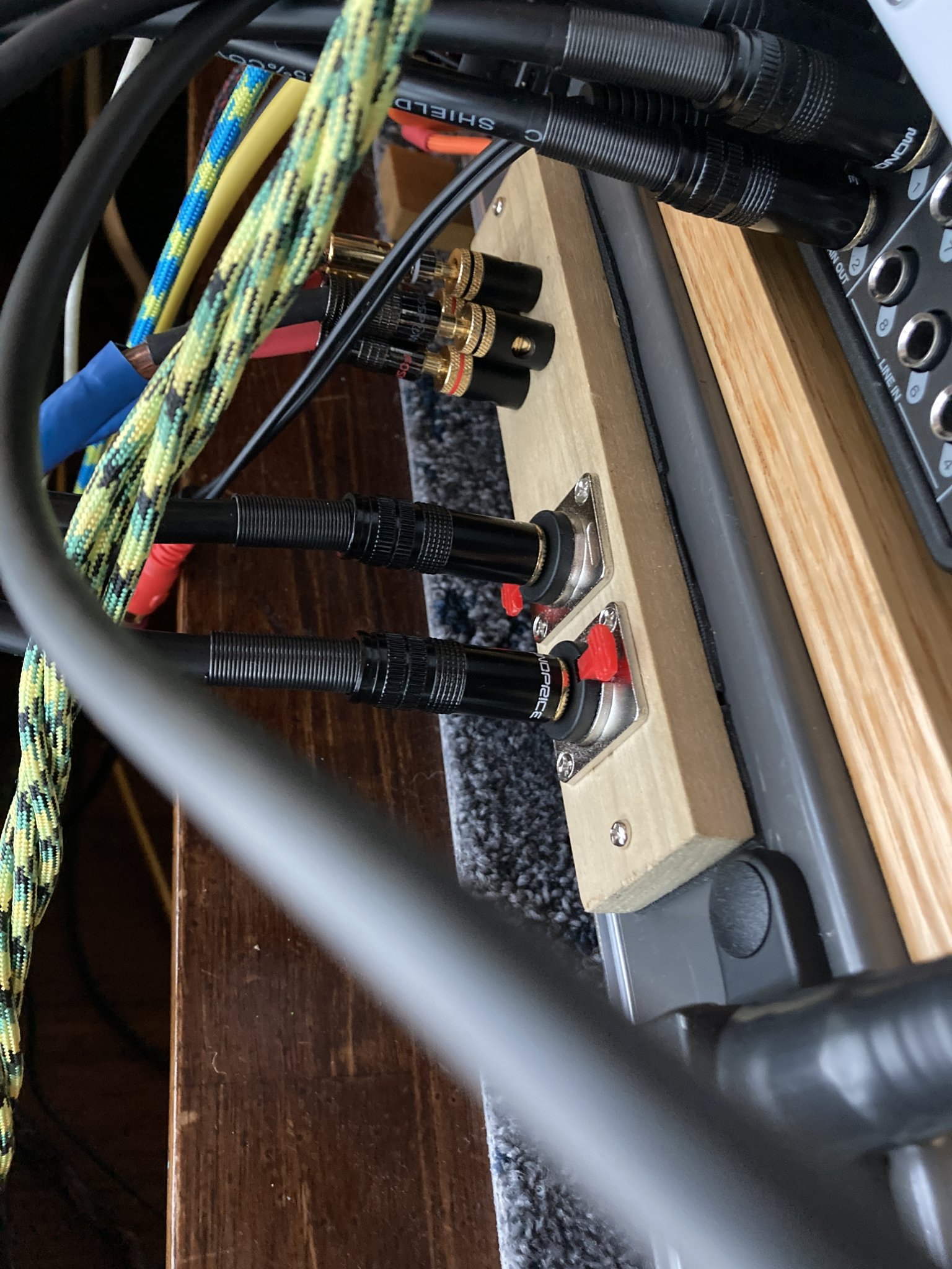

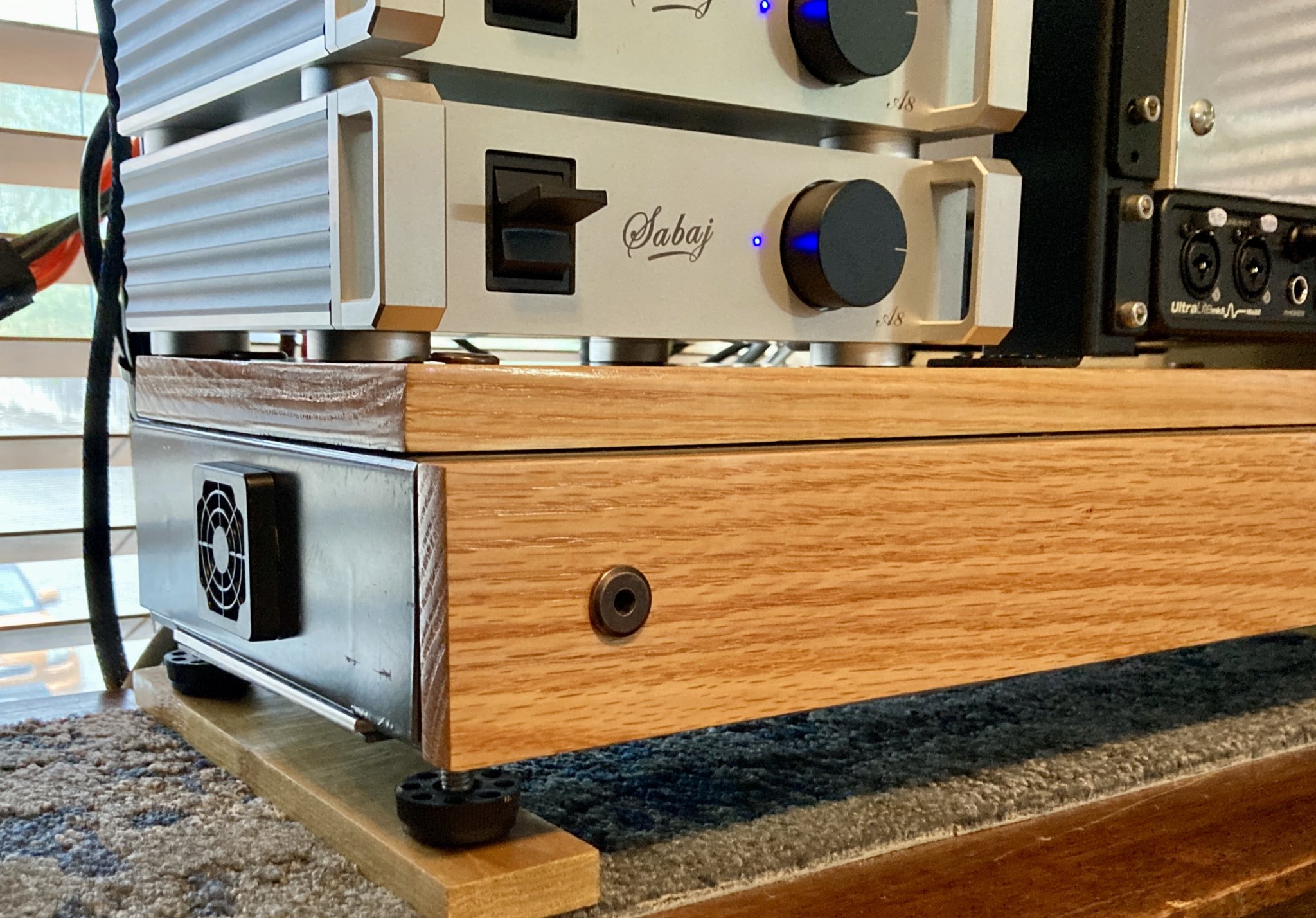

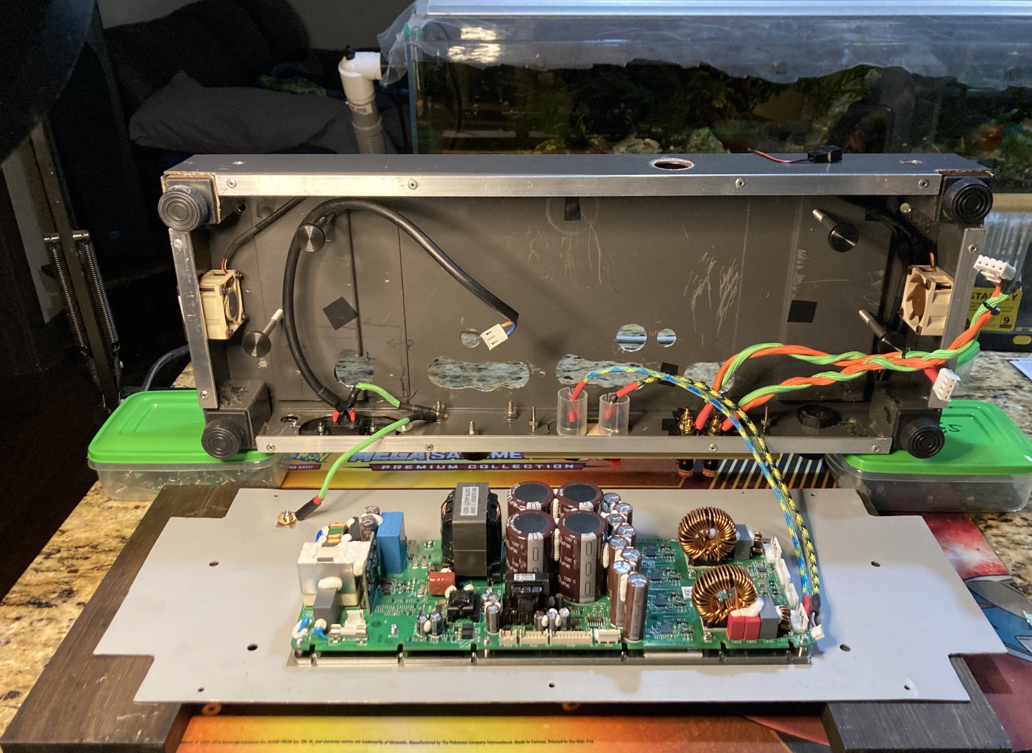

As for the 1200AS2, I am still fabricating the power and audio connections for the case. It's a true DIY item - a converted stepping platform from a server rack system. I should be done in two to three days.
Here's the old set up as well as the current modification in the works - the 1200AS2 is going inside the case with the oak facades. Please excuse the hack job on the top panel, which is fortunately covered by the oak top deck. Those cuts were made in the infancy of my fabrication days, hence the inclusion of the oak panels. BTW I stained the oak with Tru Oil. Fantastic stuff!
It's looking good so far but you might want to ventilate the box though because I think it's going to generate some heat. I've been kind of surprised at just how much heat mine is generating and I'm only using two of the Amp mods at this point and they are not even being driven hard at all yet. I'm pretty sure I'm going to need to put at least two fans in my box. One on the PSU that blows across the transformers and the switching mosfets and the other one blowing across all four 400A2's at the chokes that are getting hot. Upwards of 60 to 70 degrees C or 140'ish in freedom units. I just need to figure out how to use the PSU_Temp pin out to control the speed and usage of the fans so they only come on when it gets to be about 145 degrees C. I assume that I will need a 4 pin PWM fan controller but I'm not clear on how it works with regard to the PSU_Temp pin out.As time passes, I am leaning more and more towards the Micro-Audio SMPS630-G. I have a half-rack 3U Hammond enclosure that may fit the two 300A2 amps as we ll as two SMPS630-Gs, with a little finesse.

You must have missed the stack of 40mm fan filters in the upper left hand corner of the second photo! I have room for three 40mm fans side by side on the short ends. So I picked up a six pack of filters, a high static pressure tackling Noctura (40x20) for intake and an old Scythe for exhaust.It's looking good so far but you might want to ventilate the box though because I think it's going to generate some heat. I've been kind of surprised at just how much heat mine is generating and I'm only using two of the Amp mods at this point and they are not even being driven hard at all yet. I'm pretty sure I'm going to need to put at least two fans in my box. One on the PSU that blows across the transformers and the switching mosfets and the other one blowing across all four 400A2's at the chokes that are getting hot. Upwards of 60 to 70 degrees C or 140'ish in freedom units. I just need to figure out how to use the PSU_Temp pin out to control the speed and usage of the fans so they only come on when it gets to be about 145 degrees C. I assume that I will need a 4 pin PWM fan controller but I'm not clear on how it works with regard to the PSU_Temp pin out.

The plan is to start with one fan on each side running a cross current the length of the module. If it needs more cooling, I'll drop in two more 40s and then two more if **** stays nuclear...

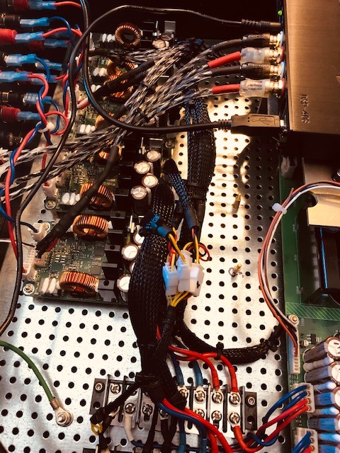

So I completed the structural elements of the case and decided to give it a run just to check for any humming or similar grounding issues. Again, the 1200AS2 sounds fantastic. Contrary to the 300/400 amps, the 1200 incorporates a bottom plate that acts as a heatsink. I currently have it mounted to an 8" by 21" steel plate with 18 M3 screws as per spec. It generates a lot of heat and raises the temp of the entire case well above 105 F degrees. I rigged up some external fans as I have yet to wire up the internal cooling system. It cooled off quickly when I ran air under the bottom steel plate. I will certainly be incorporating some sort of permanent digital thermometer going forward as I was taking readings using an IR temp gun. In short - the amp gets hot, real hot

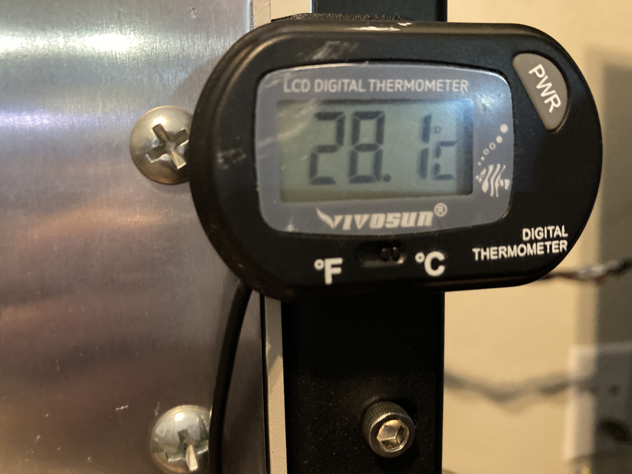

Install digital thermometer

Yea I still need to get a couple of fans and a PWM fan controller and figure out how to hook it up to the temp control pin so that the fan only comes on when it is needed. I'm just not sure how to do that. The temp control pin has a certain voltage like around 2.3 volts or there about, I would need to check the data sheet but it's roughly that and as it heats up the voltage drops down to a little over 1 volt at thermal shutdown so I'm not sure how a voltage drop is used with a PWM fan controller. I'm hopping someone could help me here.So I completed the structural elements of the case and decided to give it a run just to check for any humming or similar grounding issues. Again, the 1200AS2 sounds fantastic. Contrary to the 300/400 amps, the 1200 incorporates a bottom plate that acts as a heatsink. I currently have it mounted to an 8" by 21" steel plate with 18 M3 screws as per spec. It generates a lot of heat and raises the temp of the entire case well above 105 F degrees. I rigged up some external fans as I have yet to wire up the internal cooling system. It cooled off quickly when I ran air under the bottom steel plate. I will certainly be incorporating some sort of permanent digital thermometer going forward as I was taking readings using an IR temp gun. In short - the amp gets hot, real hot

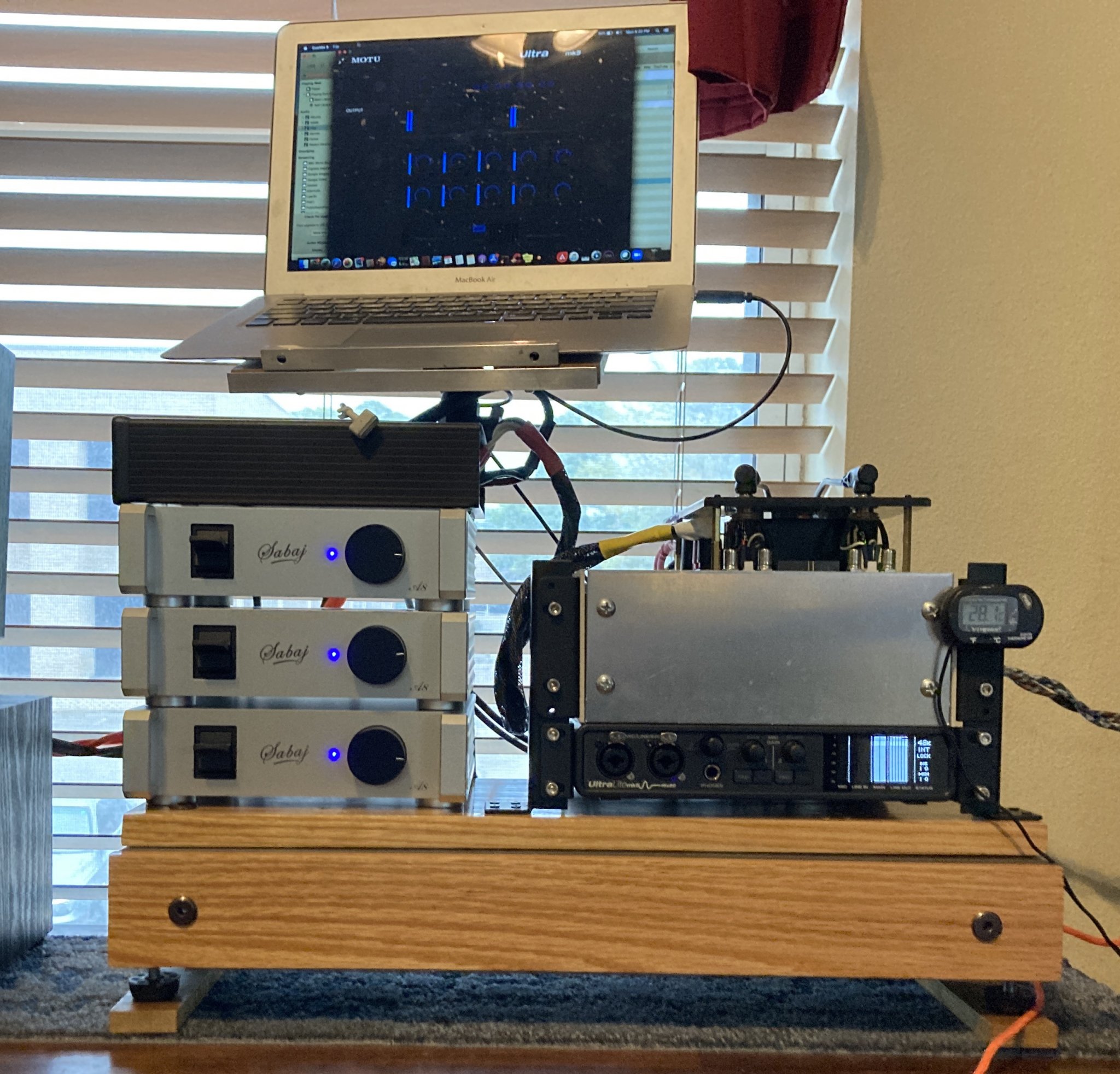

For cooling the 1200AS2, I ended up going with two Noctura (40x20) one for intake, one for exhaust. Used Noctura paste on the amp and heat sink. More or less a steel coffin with forced air. Humming along at 28.1 C.

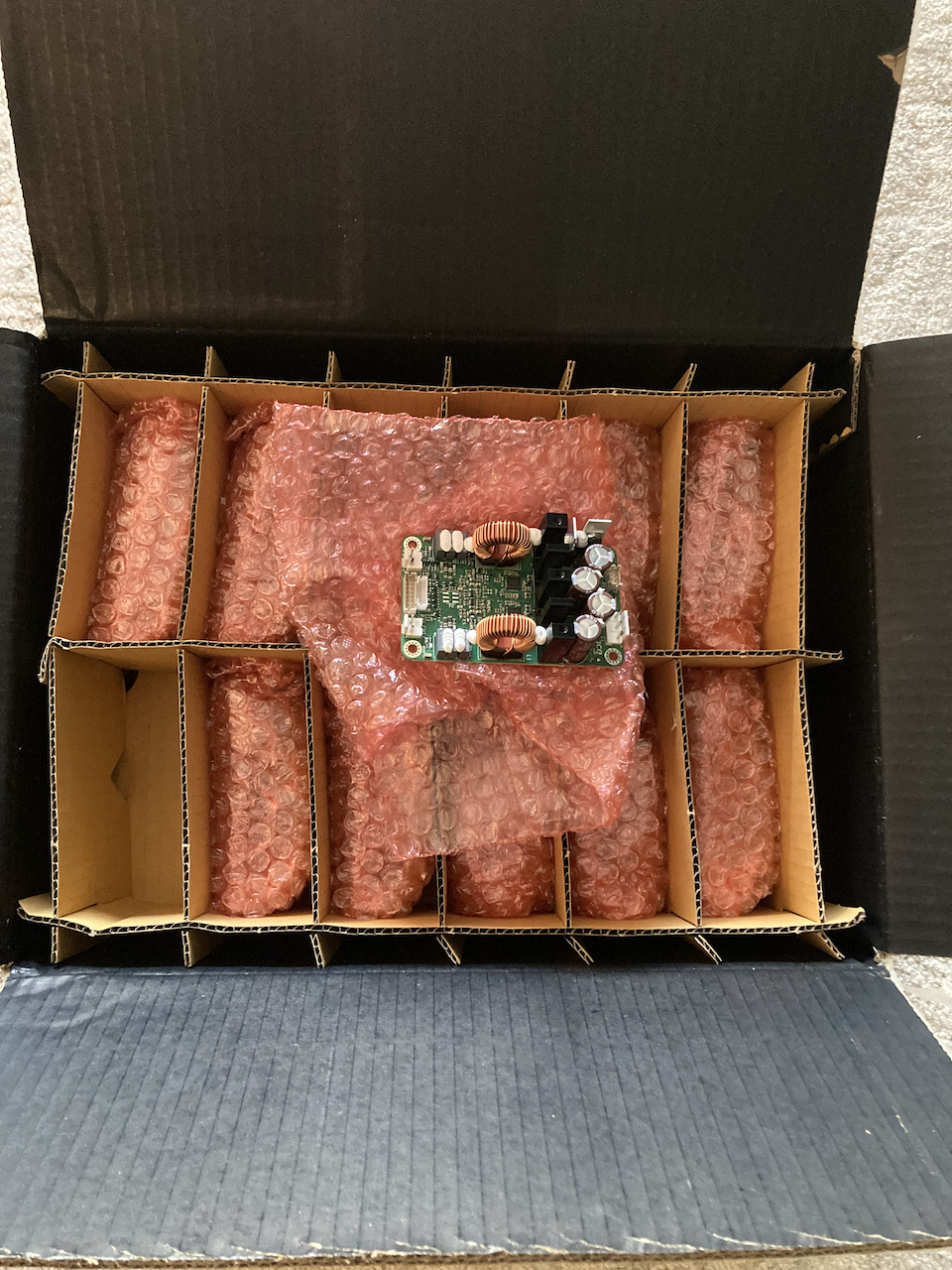

Oh wow. You bought a 12 pack. Are you planning on making more then one amp then? I know the 1500s can power 8 of those amp modules so that leaves 4 extra. So are you a COSCO shopper and only buy in bulk?🙂Finally pulled the trigger on a carton of 300A2s, now just needed the 1500S 57 V to come back in stock...

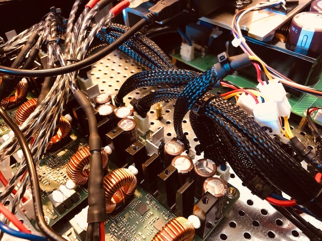

I went ahead and did a bit of wire management on mine the other day and wrapped all of the power wires. I'm moving right a long with the speakers that will be powered by the amp and can't wait to hear them together.
I still might try and design a PCB to run down the middle to eliminate those power wires and the bus bars and clean things up a bit but we will see.
