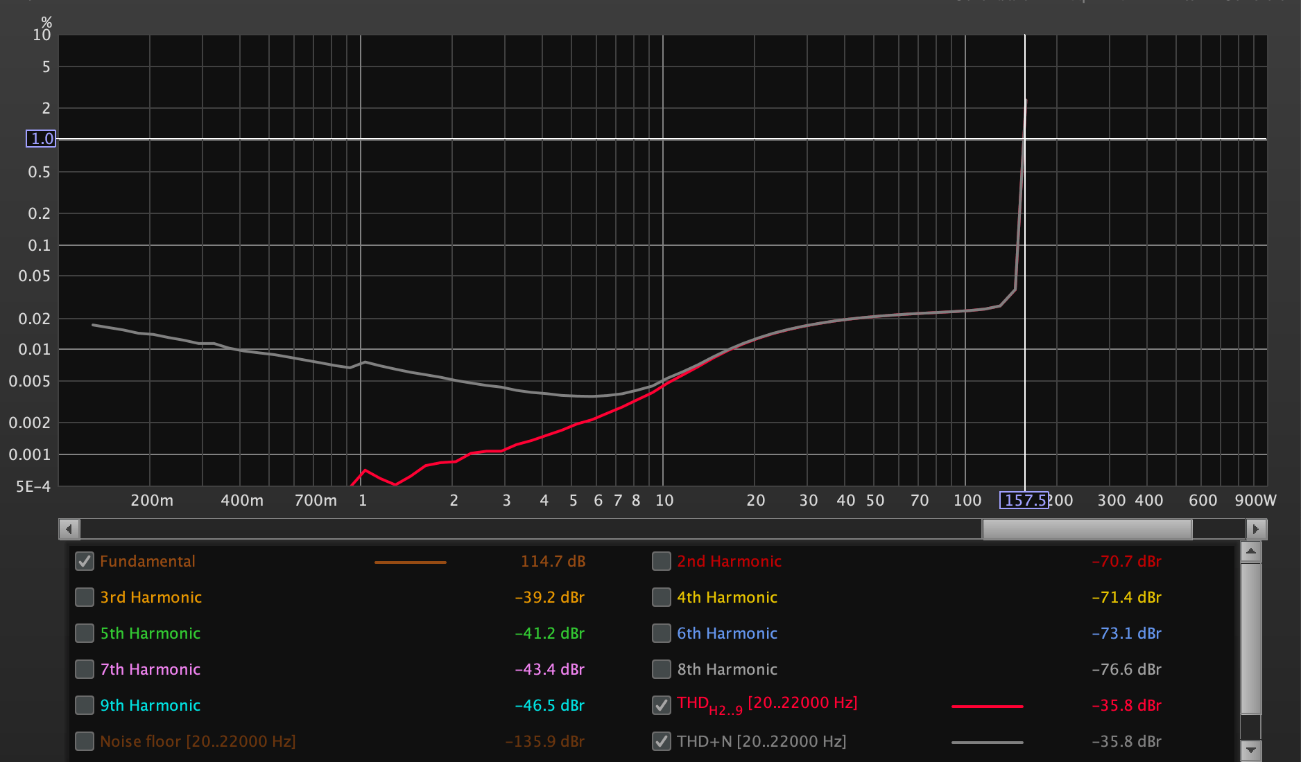

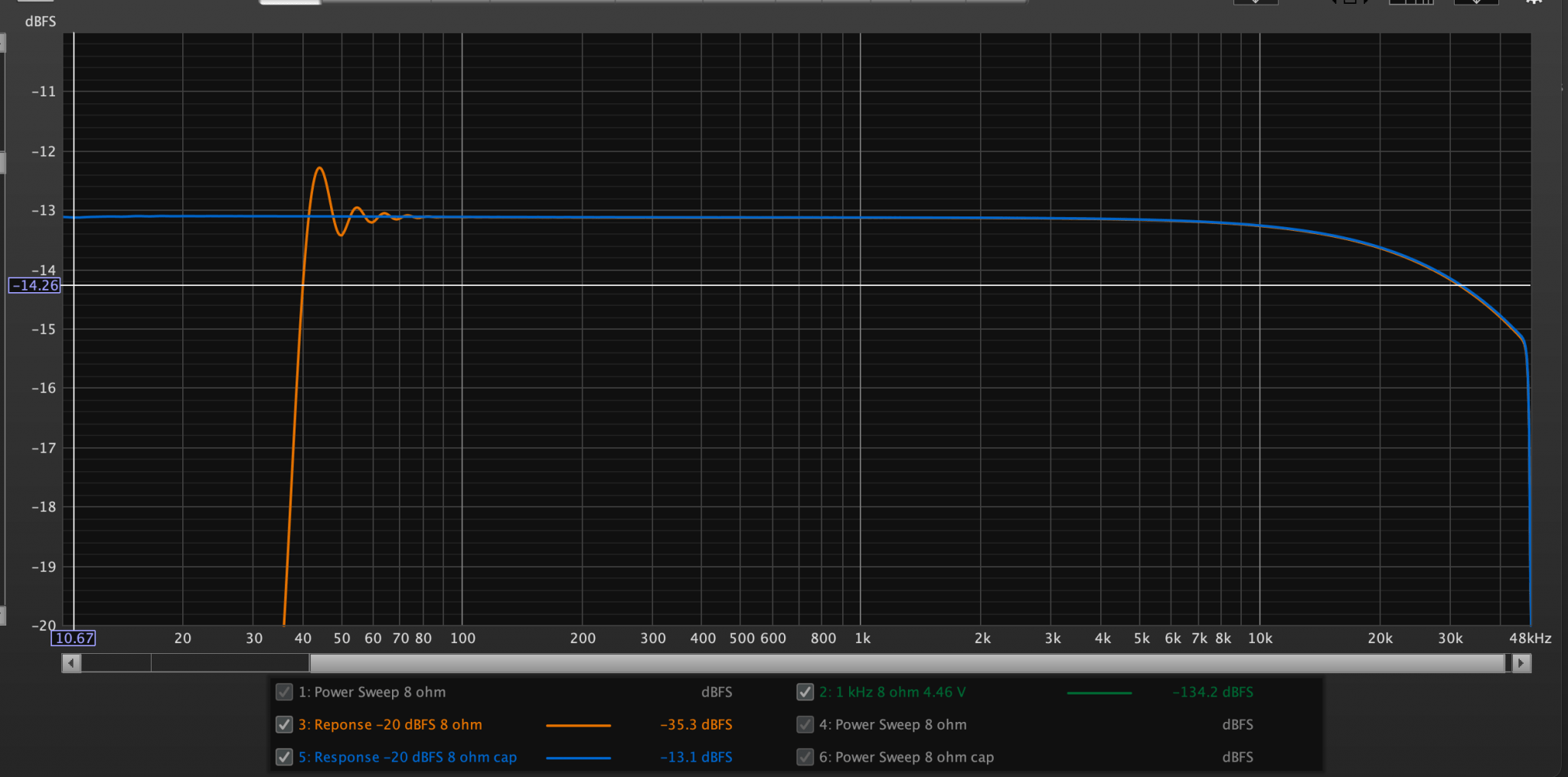

I am somewhat up and running with a Micro Audio SMPS1K and a single 300A2 module. Had a bit of an issue tracking down appropriate housing / contacts for the 300A2 as the ICEpower cable kits are out of stock and the raw JST components are also very difficult to find. In the end I was able to get there by finding substitutes from TE and now have all the appropriate connectors.
Haven't done tons of listening as I wanted to tease out issues on the bench first. I ordered an extra capacitor PCB as I knew bus pumping was a concern. Here is a frequency response comparison of a single channel driven at ~15 W in to 8 ohm. As you can see things get ugly below 80 Hz but the extra capacitors take care of that.
Also ran a power vs level sweep at 1 kHz for one channel driven in to 8 ohm. This measurement is done with a MOTU M4 as an input / output device which adds it's own noise / distortion in to the mix so do not take these numbers as absolute. Also these measurements were done with the amp / power supply not in any sort of enclosure and it is very sensitive to wiring orientation currently so I am sure there is more to optimize there. Short story is just below 150 W in to 8 ohm at onset of clipping and 160 W in to 8 ohm at 1% THD+N which is in line with the datasheet.
Turn on / off is silent, FFT shows 2 mV integrated noise worst case on turn-on. Overall very happy with the 300A2 and the Micro Audio power supply. Next step is to add more modules / channels and make sure everything is still well behaved. Current plan is to have two 2 300A2s for one power supply in a single chassis.
