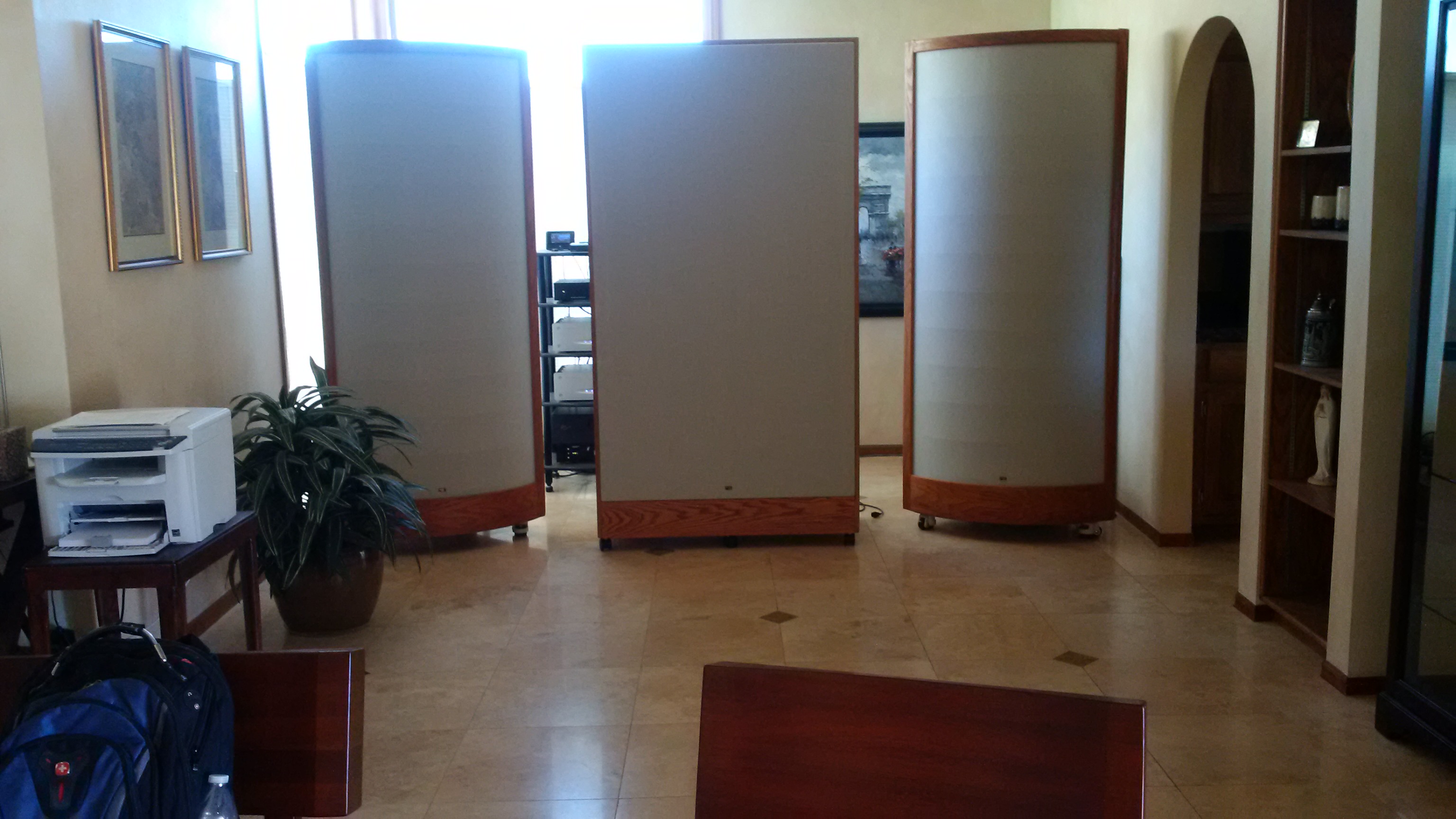

What a great discussion. I have always loved electrostats especially on Jazz, Classical, and Acoustic music but for the life of me could not get them to sound good on vintage progressive rock albums. It has been a frustrating experience. I've got to think that the compressed nature of the recordings just do not sound good coming out of the planar speakers. My guess there is not a solution to this situation other than adding woofers / subwoofers. I have Soundlab speakers with a planar sub. The planar sub is a stereo sub (B1S divided in R/L halfs). The sub puts out prodigious amount of bass and sounds great with the aforementioned music genres. I have played around with different crossover frequencies. Dr. West at Soundlab suggested 500hz to completely off load the bass from my A1s. Although I get an element of "slam" it still does not make "rock / prog rock" music come alive like horn / 15" woofer speakers that I have heard.
To me, 500 Hz is midrange -- the note used to tune orchestras, for example, is A440. To me 500 Hz just seems too high -- I'd think that 200 or maybe 300 Hz would do it. But you do seem to have a good match for the radiation pattern between the main and "woofer" speakers, so you probably have more latitude than most of us.
Still, at 500 Hz the wavelength is about 2 feet, so I'd worry about interference effects. At 200 Hz, the wavelength is about 5 feet, which should make the transition a lot smoother.
Nice system, BTW.
