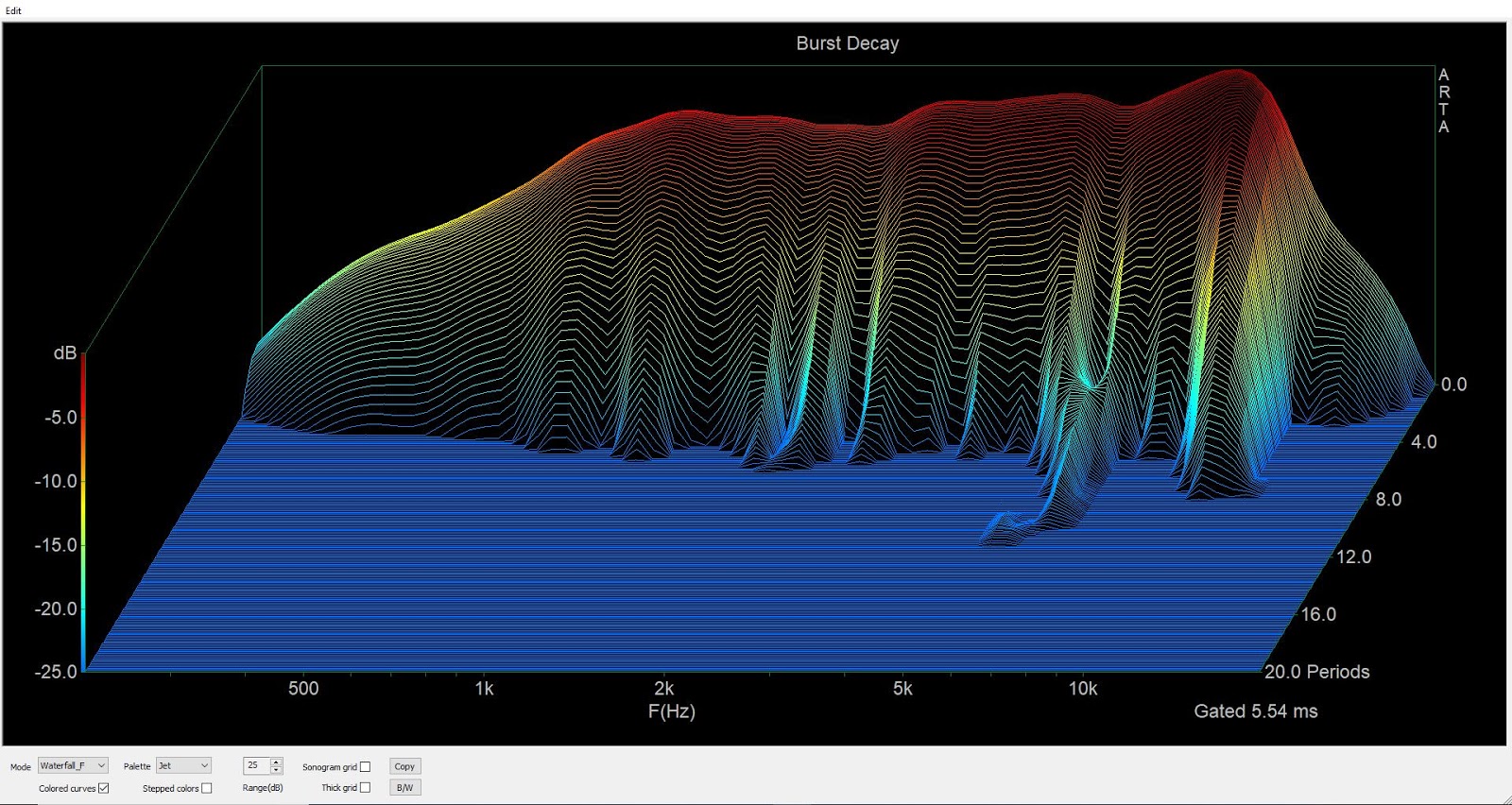

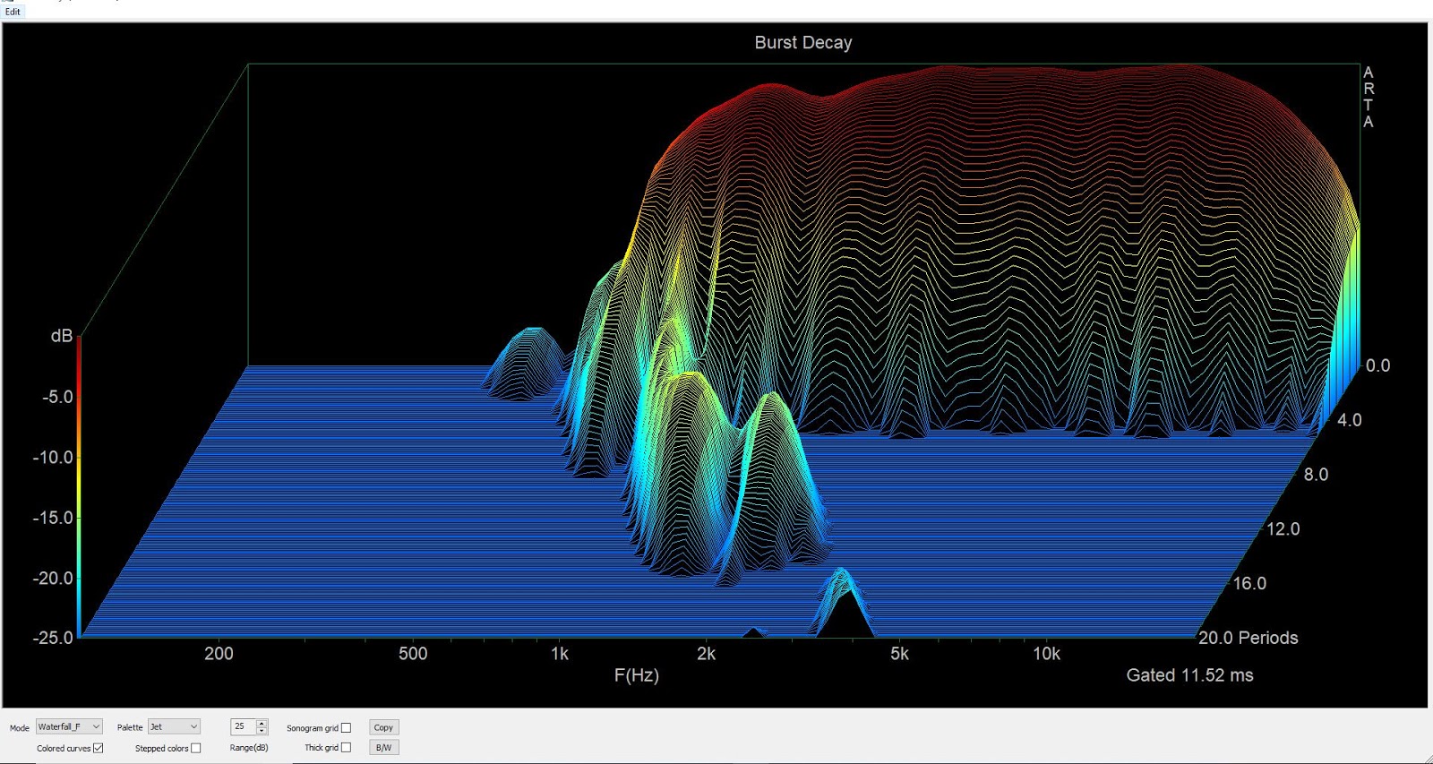

Certain measurement software is able to change the axis in the cumulative spectral decay plot to be periods instead of time. So the units of milliseconds changes to periods (aka cycles) which more truly represents the decay performance relative to the actual frequency of concern. This also allows a target performance to be established such as this....
The initial burst should decay by -25dB by one period. So essentially your targeted a dynamic range of 25dB across the frequency spectrum. The picture I’ve shown below is the burst decay plot for the TAD TD-2001 compression driver which is the best performing I’ve ever measured. The other is the burst decay of the BG Neo8 planar transducer.

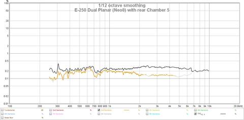

If your intent on improving the dynamic range with the goal of reproducing that “live” sound then you’ll need to look at using large format front horns. I’ve done extensive testing with horn loading the BG Neo8 and Neo8S planar transducer which can provide a flat frequency response from 250Hz-20KHz. This configuration produces very good dynamic range.
What is max spl with the neo8 on that big horn? Can you say what it is at 4m?
I calculate that it would be 100dB SPL at 4 meters using a stereo pair of E-250 Dual Planar horns. Distortion is limited to 1%.
At 90dB distortion is around 0.3%.
