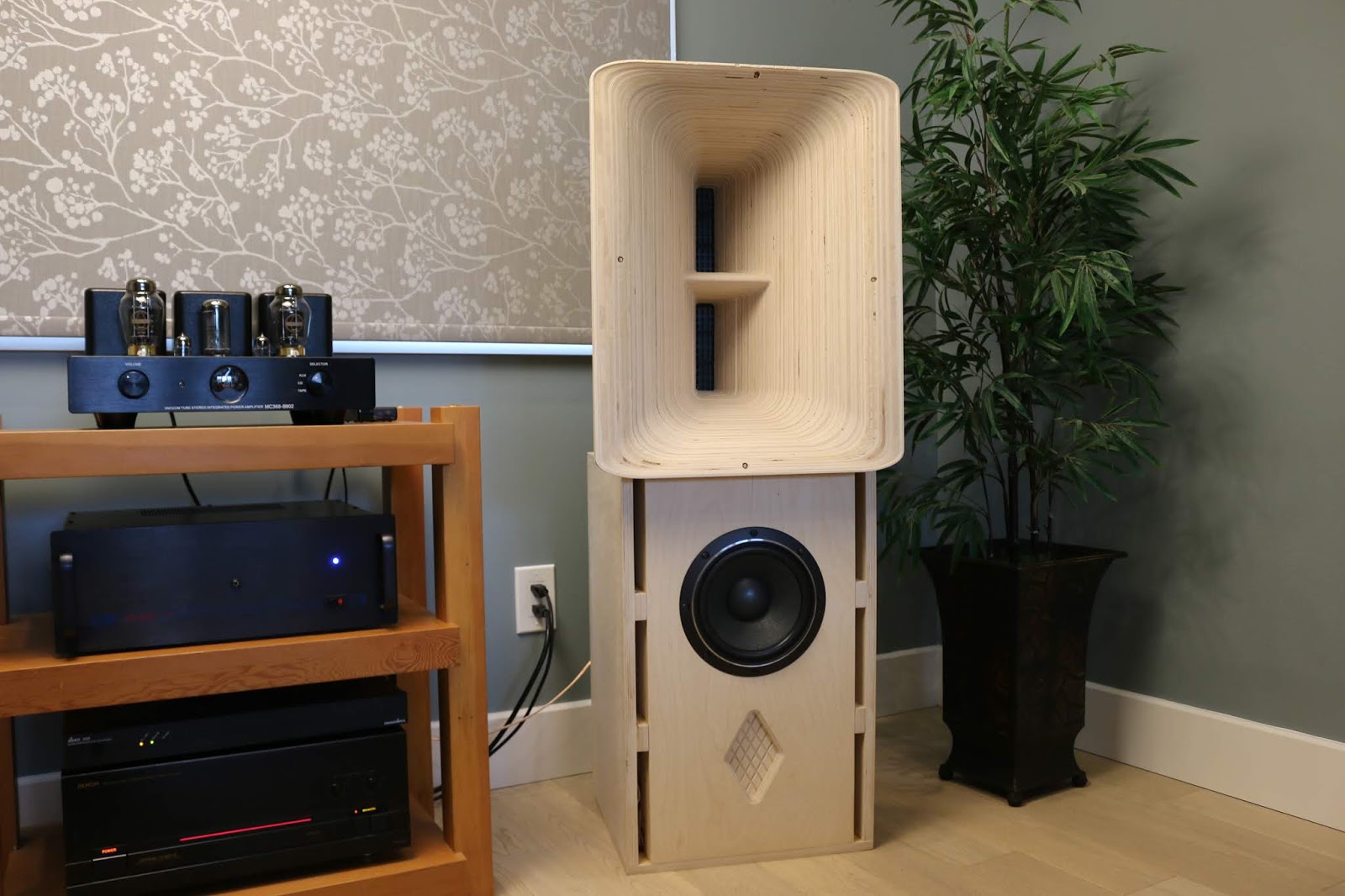

I have heard a really good horn setup with a Raal tweeter driven by (I think) a single-ended triode. The dynamics simply were outstanding. The Bevs are close, but not quite in the same class.

If you want to listen at these SPLs, you really should look into horns. Modern ones have gotten quite good, and their efficiency helps them a LOT to achieve these sorts of SPLs with very low distortion. The sweet spot is larger than the old Quads (for example) but is not anything like the Bevs.
But if you want such high SPLs (really!?) then you really should move to horns.
In principle you can do this with electrostatics, but that just is not what they do best.
I disagree. 115 db is 115 db. You want reasonable frequency response, decent dispersion (or power response), both of which which horns do well if designed properly, and low distortion. Their transient response also usually is superb. Ringing and mouth reflections have been reduced substantially.
Simply, if you want to listen at high SPLs, you should use horns. But if you are happy with what you have, who am I to quibble?
