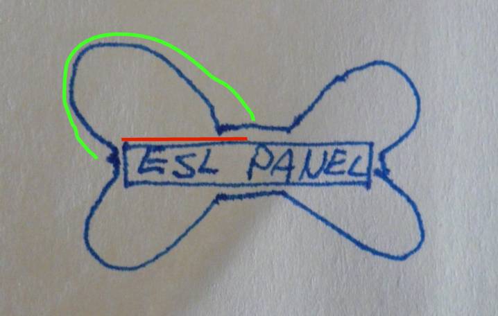

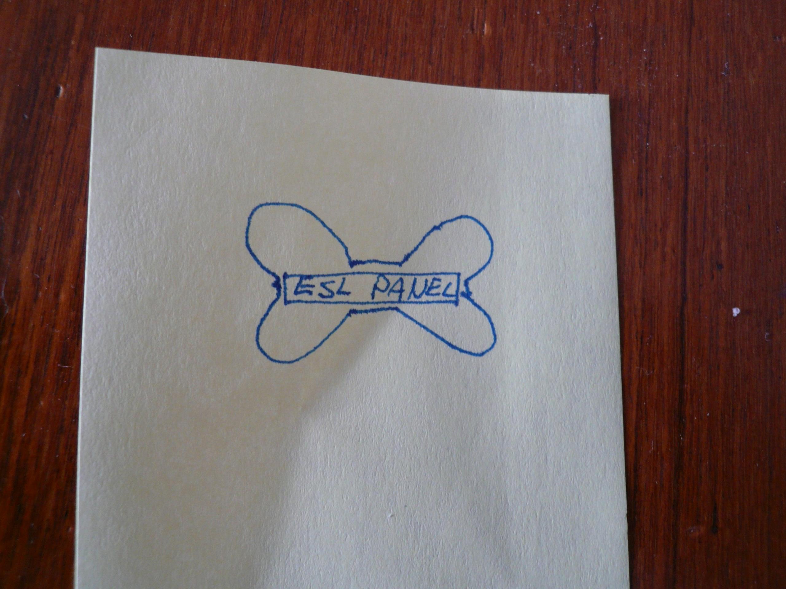

Here's a question I'm hoping someone can answer. In another thread acoustic lenses were brought up for ESLs. It's pertinent to this topic so I'll ask it here. If this principle was applied, could it be effective in preventing the cancellation effect by wrapping the lens around the the sides if a hyperbolic recess was located at the cancellation point. So for example on a single panel like an Acoustat Model 1, the lens would literally wrap around the panel 360deg with recesses front, back, and sides. This would help horizontal dispersion but would it serve to cancel the cancellation at the sides?
Here's a question I'm hoping someone can answer. In another thread acoustic lenses were brought up for ESLs. It's pertinent to this topic so I'll ask it here. If this principle was applied, could it be effective in preventing the cancellation effect....

You may need to draw a quick sketch of what you are proposing.
As long as there is a relatively short acoustic path between the front and the back, you are going to have cancellation at low frequencies no matter the baffle or lens shape. It's that "above a certain frequency" bentoronto mentioned that tends to be the problem for full-range electrostatics or dynamic dipoles.

I think in that case, you'd wind up with D (in the Linkwitz equation) going from the red line length in the image below, to the green path length.
Rough numbers, if you started with an overall panel width of 20 inches, D would be 10 inches (the red line), so low frequency roll-off would start around 700 Hz.
If the green path is 2.5x the length of red, roll-off would start around 280 Hz.
At higher frequencies, the acoustic lens would have more influence, but at low frequencies I doubt it would provide much benefit.
