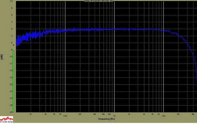

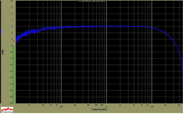

OK, I have had the 1628SEA's for over a month, and they have been sitting on the shelf, staring at me.
A long shot at work (a high speed CMOS RF test chip) turned out to be very successful, which means that it must be tested 27 different ways and documented. I have had little time for audio lately. The audio time that I have is spent building and photographing SimpleSE boards for the assembly manual. This has left me with 4 completed boards and dozens of transformers to test.
Sherri is not home tonight, so I connected the 1628SEA's up to a fresh board in UL mode, hooked up a fat power transformer that gives me 465 volts of B+, put in a pair of the Shuguang Coke Bottle 6L6GC's and turned up the current until I reached a dull red glow, about 35 watts dissipation. I then ran frequency response curves with and without cathode feedback.
I have been listening to it all night. After about 2 hours of various music, I swapped in the old 1628SE's (5 minute job) and listened some more. After about 15 minutes, I pulled the plug, and put back the 1628SEA's. They have that "something" that just sounds right.
I will have a more detailed comparison between about 10 different types of popular OPT's when I get the time to finish it. I have to get my HP8903 fixed first.
Included below is the frequency response measured at 5 watts.
Isn´t 3db down at 20khz mid-fi?
I guess that everyones definition of HiFi is a little bit different. Hammond claims +- 1 db from 30 Hz to 20 KHz (on both versions of the 1628). I would like to know how they measure this, and at what DC current.

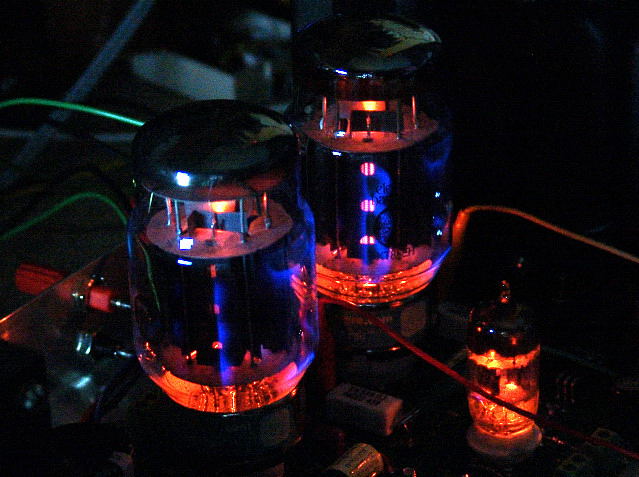

I went to visit a friend who sells tubes on the way to visit my mom (a 700 mile trip). He offered me some "previously auditioned" tubes for $10 each. I purchased a few pairs of assorted power tubes.
I tested some of them in an amp that is currently under construction. Those who have listened to my previous rants know that was turned off by the early failure of several Sovtek 300B tubes. I got a pair of Electro Harmonix KT88's, because they were cheap, and because they had heat radiating fins welded to the plates.
The short story is that these tubes absoultely rocked. I cranked the dissipation up to 40 watts. There was no sign of death glow and the sound was great. I then went up to 45 watts and there was a faint glow on the plate of one tube with the room lights off.
There was a cool blue light show going on on the glass of the tubes. The 3 "D" shaped dots from the plate holes blink to the lead guitar, and the whole glass envelope pulses blue with heavy bass notes. I have never seen anything this bright before. Good sound, and a free light show, tomorrow morning, I am going to call up and purchase the remaining tubes.
I just had to post this picture.
